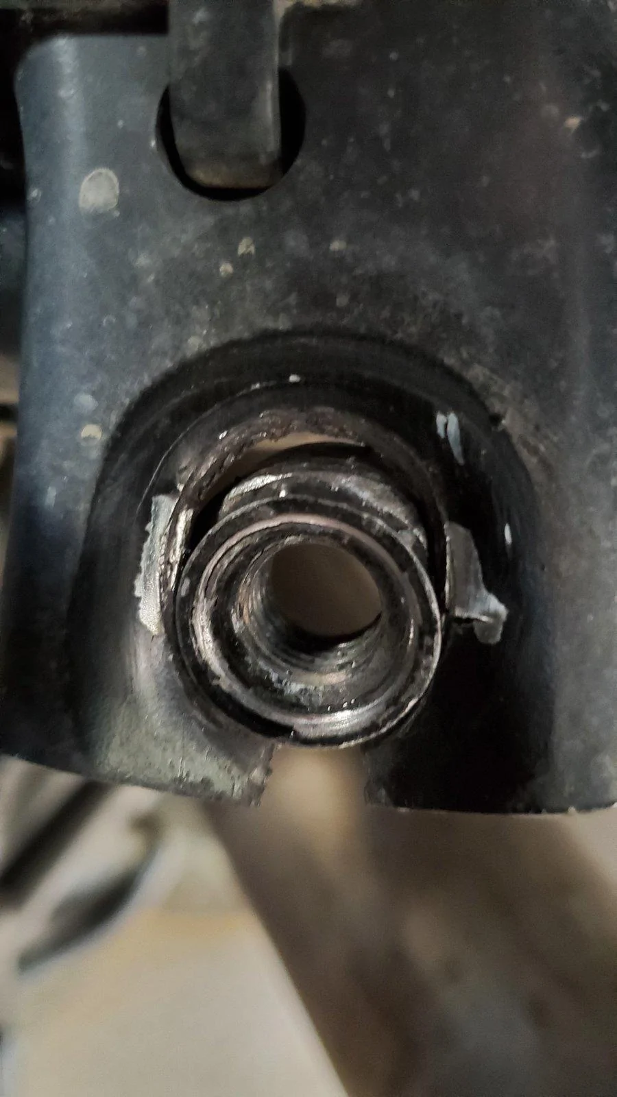

The OEM brackets are being ripped out in a downward direction
I wonder if the original brackets would have fewer issues if there were a washer between the sway bar link and the bracket to spread the clamping pressure against more bracket material. From the factory the sway bar link's metal sleeve is pressed directly against the bracket and all those 65ft-lb or so of pressure is concentrated in a thin circle against the bracket. The Metal Cloak bracket serves as a large washer to distribute this pressure, and also adds the remote bolt fastening.

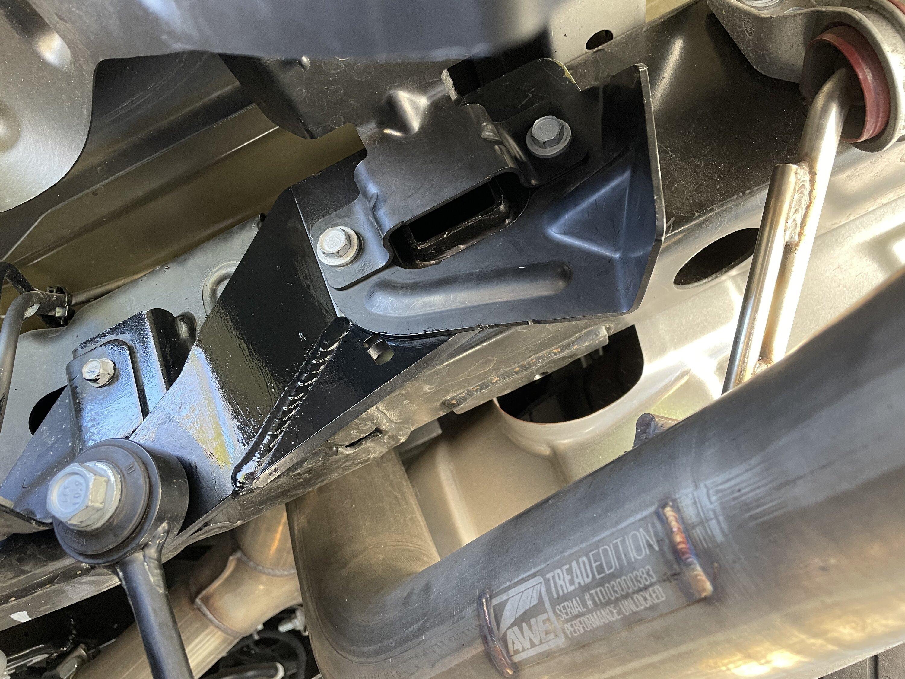

Here you go…I only have 1 on the driver side.
Thank you. I assume the the shield you speak of is the metal piece that is between the wire harness bracket and the metal cloak bracket? That is not on my mojave. I wonder what it is for?
Jaxmax
Jack
Jun 28, 2020
54
2,858
4,639
Bally, Pa.
Electrical Manager
Most of us think it has to do with shielding heat from exhaust or directing air towards exhaust which would explain why it is only on drivers side. My 2021 Mojave had it but came off when the RokBlokz mudflaps went on.....Jack
This is what I have been saying from the beginning........However I'm not sure the washer would fix it if the link has a rolled sleeve.
The aftermarket links most manufacturers are supplying are using a crappy thin rolled sleeves in the link bushings that just pinches the rivnut. Eventually it just rips the nut out of the bracket. Itf this doesn't happen, it's the sleeve that crushes, bolts come loose, and maybe the rivnut fails from that?
On my own truck, I used some links I had around the shop, but installed a 3/4" ID hourglass bushings with the appropriate machined seamless sleeves so there is some meat there to pinch the actual bracket like the stock ones. I bet I have more off road miles than 99% of the people on here and no failure yet!
Why would some have it and not others? Doesn't make semse, but then again, we are talking about FCA
Mojave2021
Apr 28, 2021
450
449
California
21 Gladiator
Honestly that shield doesn’t look like it’s protecting much to me. I wouldn’t worry too much about it.
