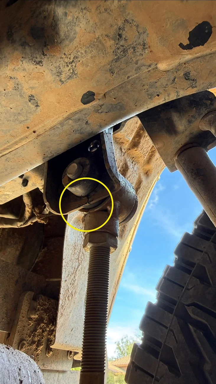

Just found this yesterday. Looks cracked but it’s on both sides. Normal? If I get the MC brackets can I still use my Rokblokz mudflaps?

Mine are not cracked that way. Hopefully with the brackets, they never will be. I have no idea about the mudflaps.
Looks cracked.
