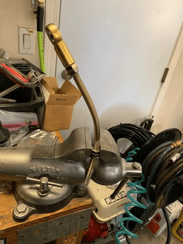

The idea is that the End link stud takes the bend instead of breaking the mounting points. On many lift kits like mine (Clayton), the end link studs are designed as "disposable". $10 stud part, where you just screw on new end links or straighten the stud. I have already bent a few, and I always had to bend the mounting tab back down to it's original location. The metalcloak reinforcement means you only have to worry about the stud and endlinks and not the mounting locations.
Note: With the metalcloak reinforcement, I am also using the new longer Mopar bolts for the tabs, and those are much better than using the stock too short ones, or the metalcloak ones which have the wrong thread pitch.
