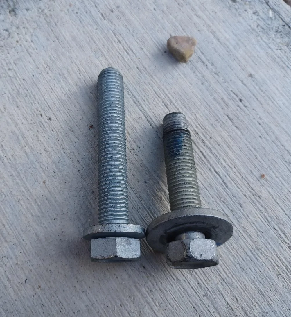

For comparison. I might have had maybe 2 threads of engagement. The new ones are a little challenging to start with the ends being fully threaded. Built in washer is smaller as well.

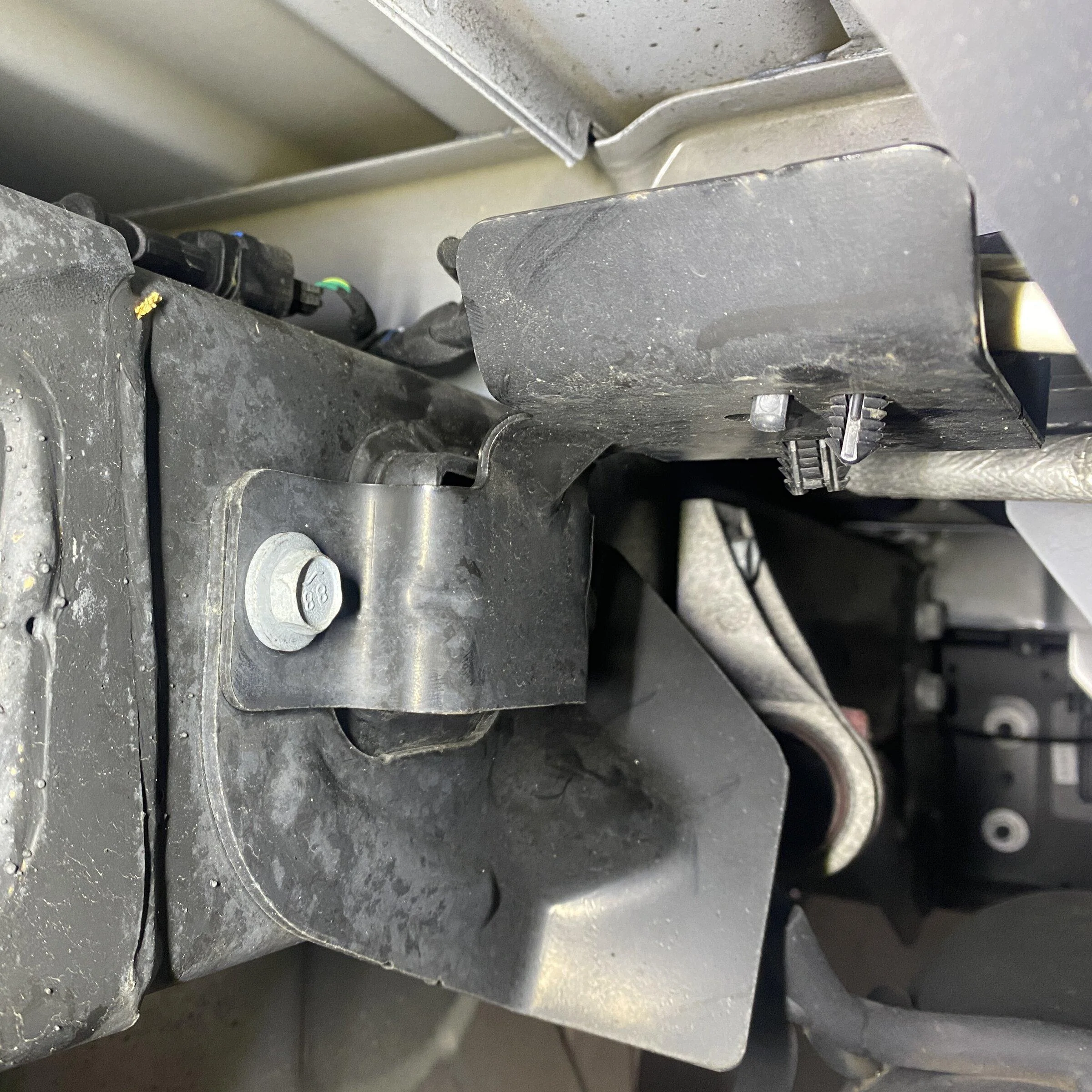

So I was not expecting this bracket. In the MetalCloak instructions it looks a whole lot different. So I’m pausing this install till I figure this out.
Jeep Gladiator Rear Sway Bar Reinforcement 20220516_183945
The bracket you see in their pics is the one that comes with their inner fenders. I received the same brackets when I did the metalcloak fenders and their inner fenders.

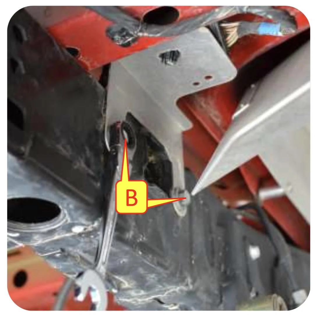

To summarize the 2021 bolt situation with these brackets (linking in the related bolt thread)
  1. One should replace the OEM sway bar end link bolt with the new longer length bolt: 06513320AA
  2. A new nylon lock nut should be used with the longer length sway bar end link bolt such as this one:
  3. One should use their existing OEM frame bolts for the 2 frame bolt holes shown in F below
    Jeep Gladiator Rear Sway Bar Reinforcement 1652760023795
  4. Finagle the heat shields back in if you can.
  5. Don't use the Metalcloak bolts.
Let me know if I'm missing anything.
