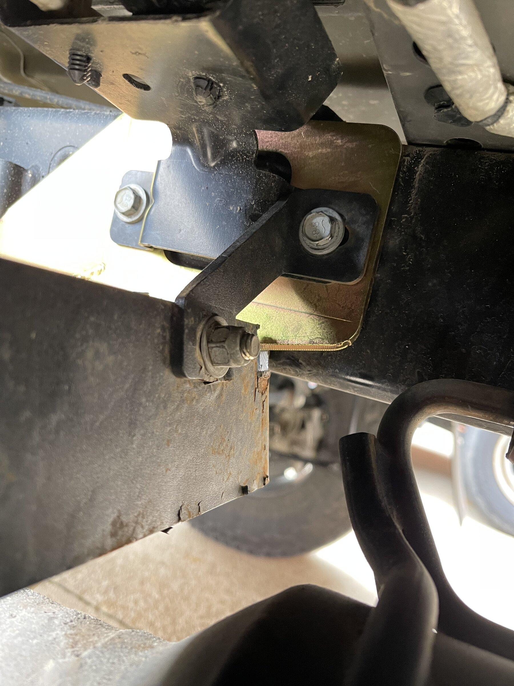

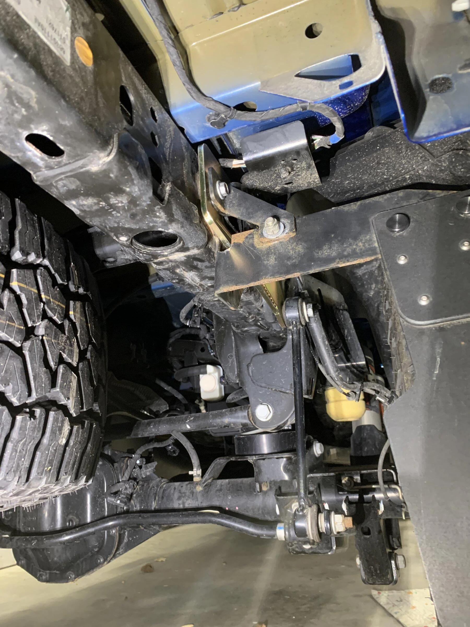

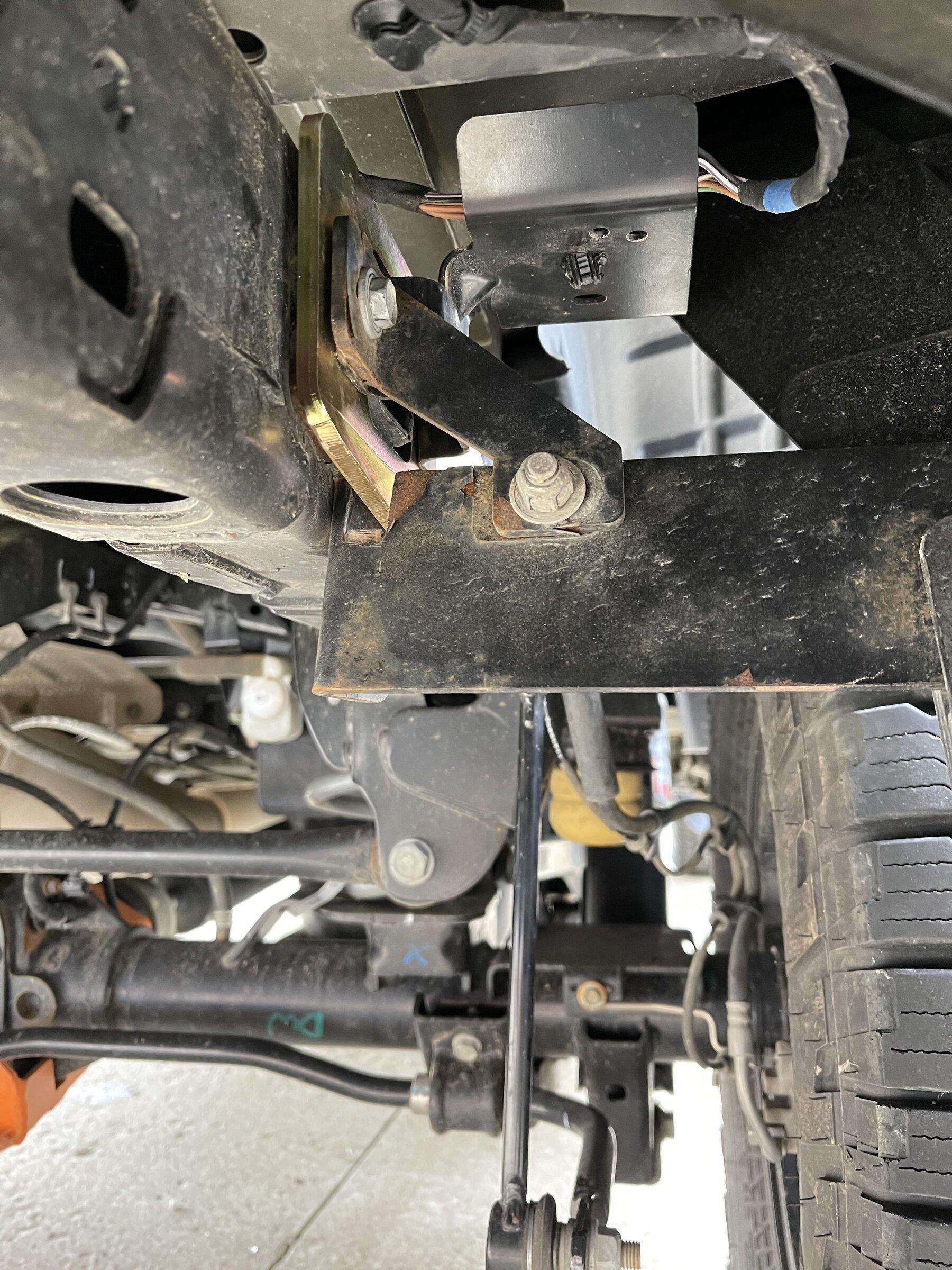

Well got one on so far with RokBlokz mud flaps IT WORKS!
Have to cut a 1/2” X 1/2” slot in mudflap bracket and mounted the sway bar brace on top of the mudflap brace and did not need a spacer between frame bracket and reinforcement bracket, left it gold to start but I have to rattle can everything when done, also a longer metric bolt is something I am going to get…..Jack

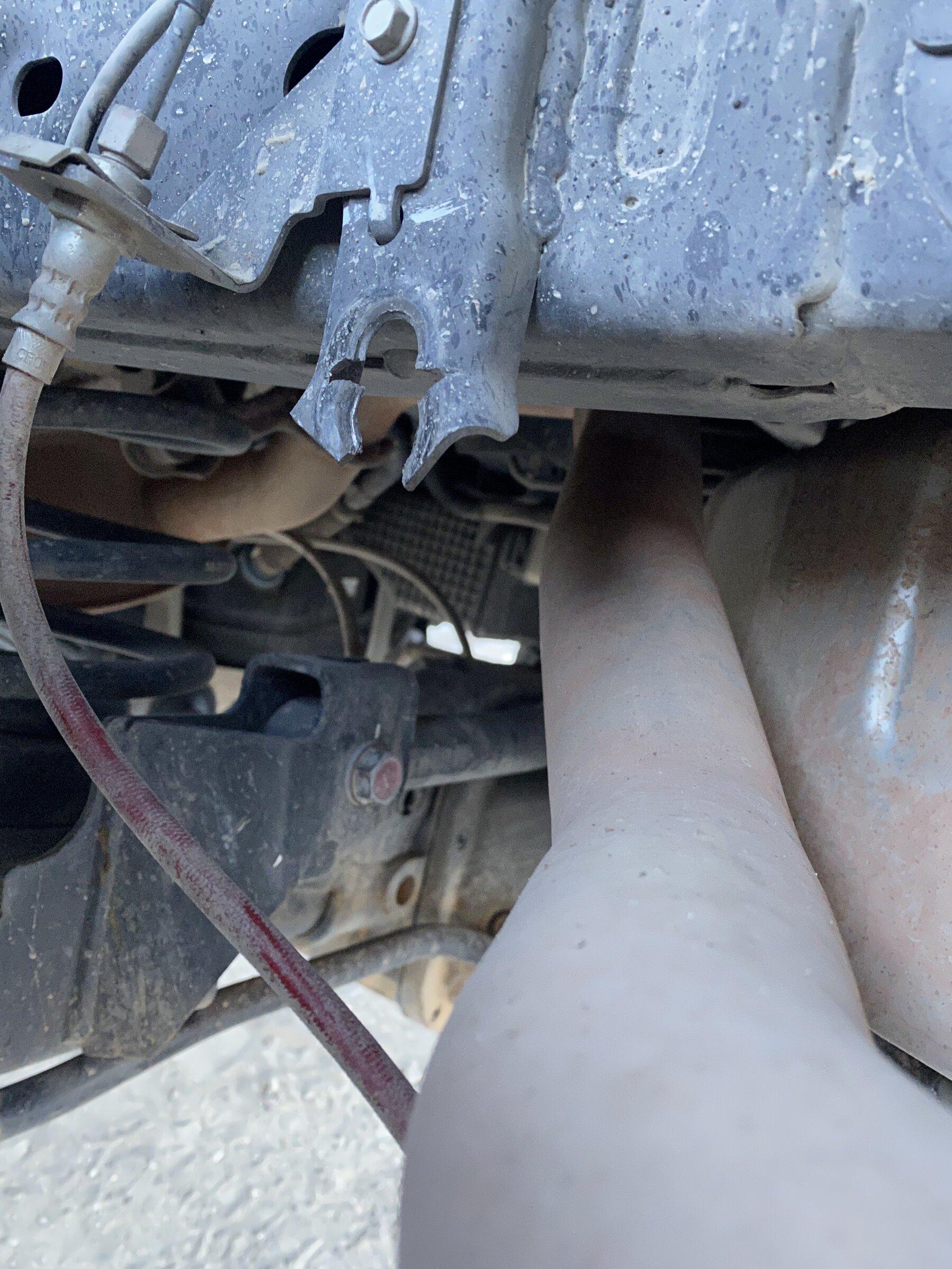

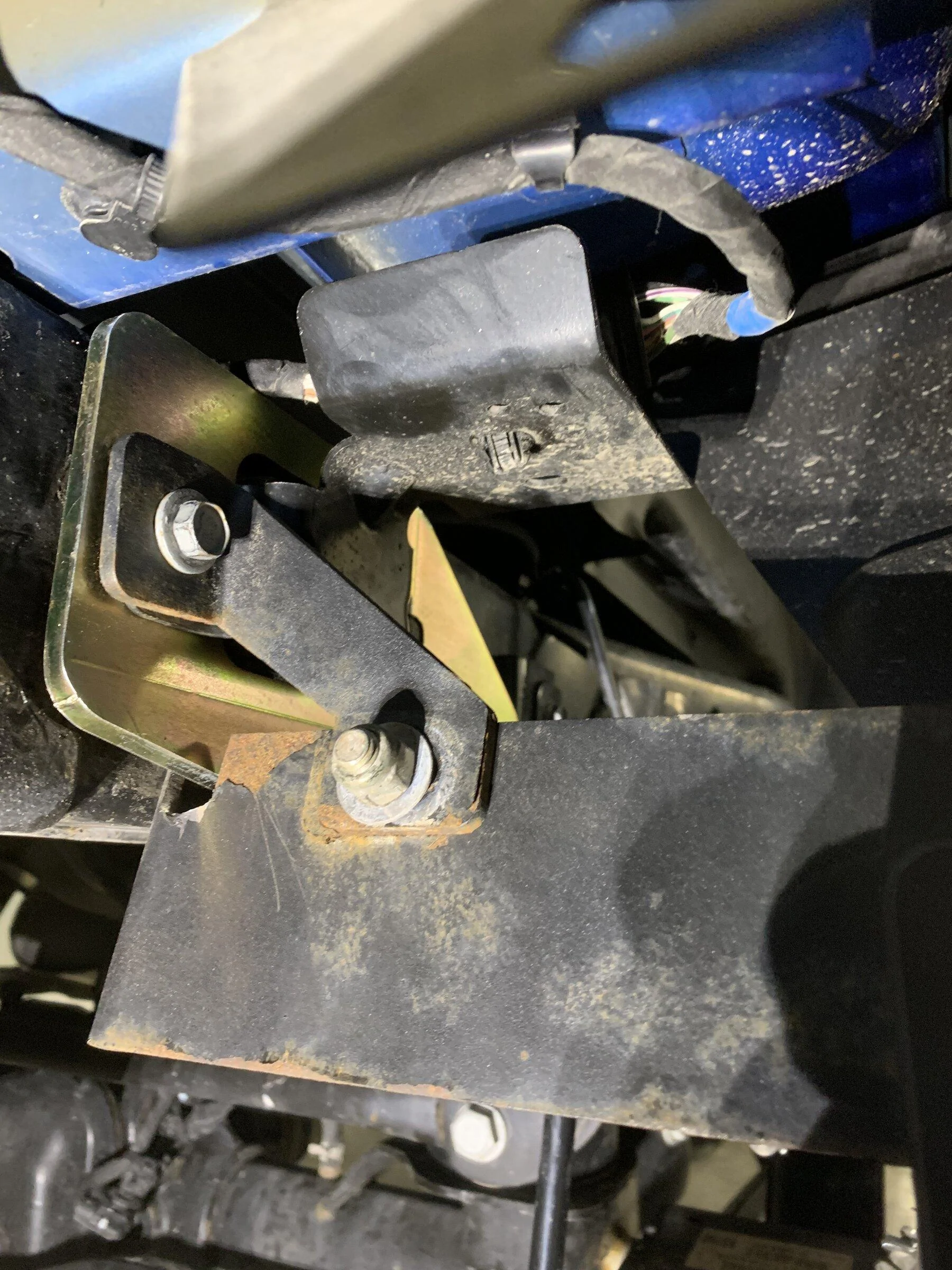

Most likely overkill, but I had a local welder combine the sway bar bracket and the rokblokz bracket (note the diagonal brace is welded too)

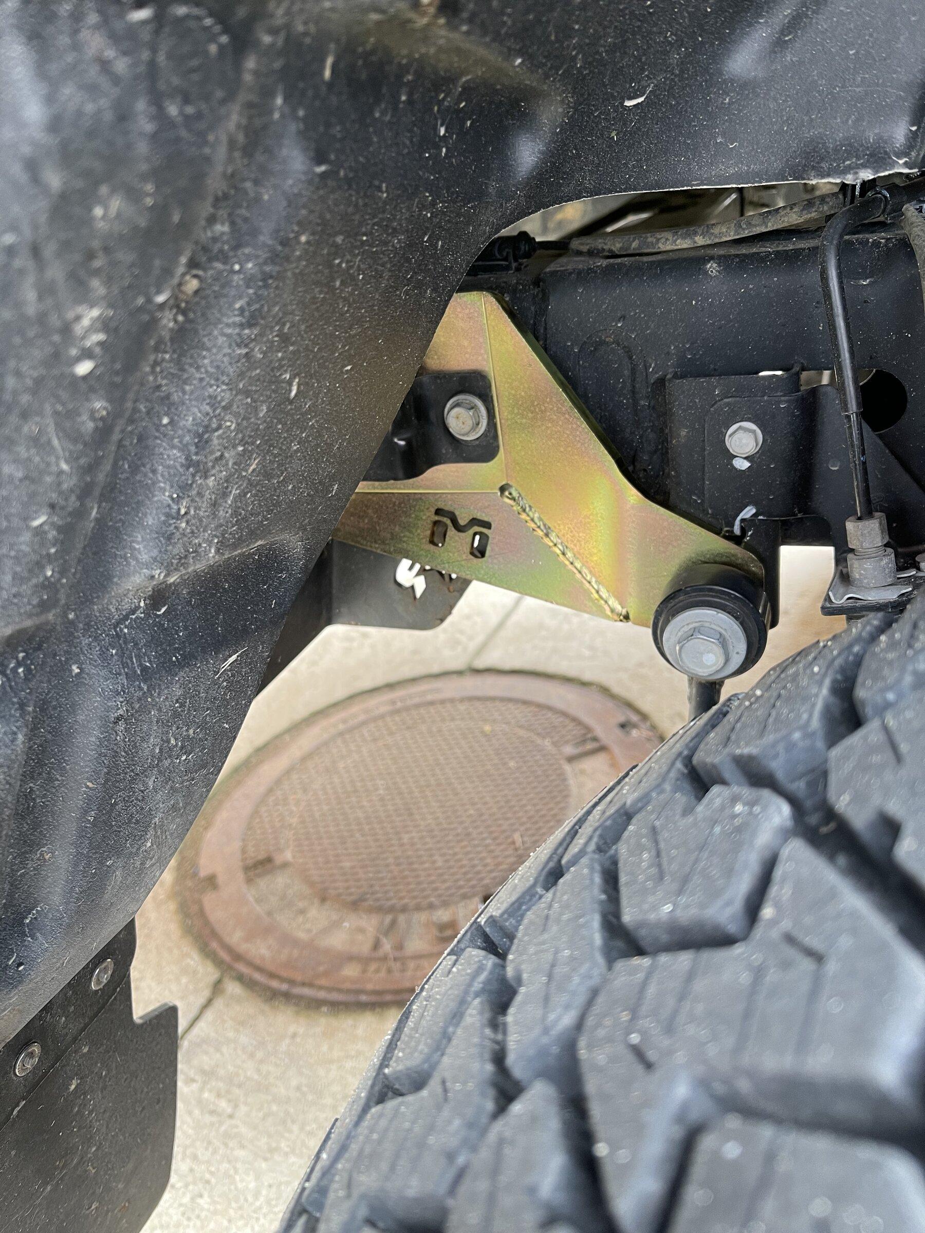

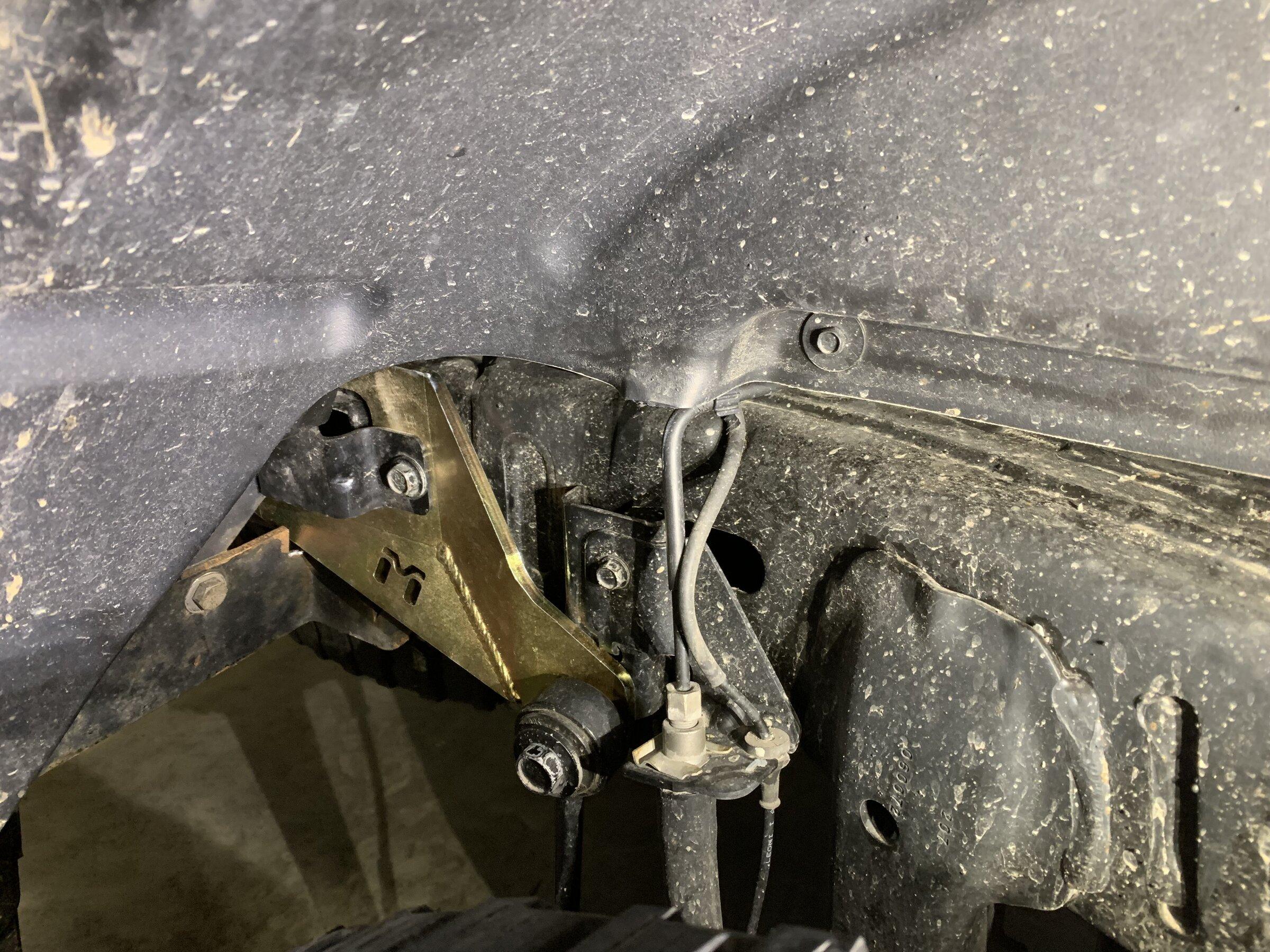

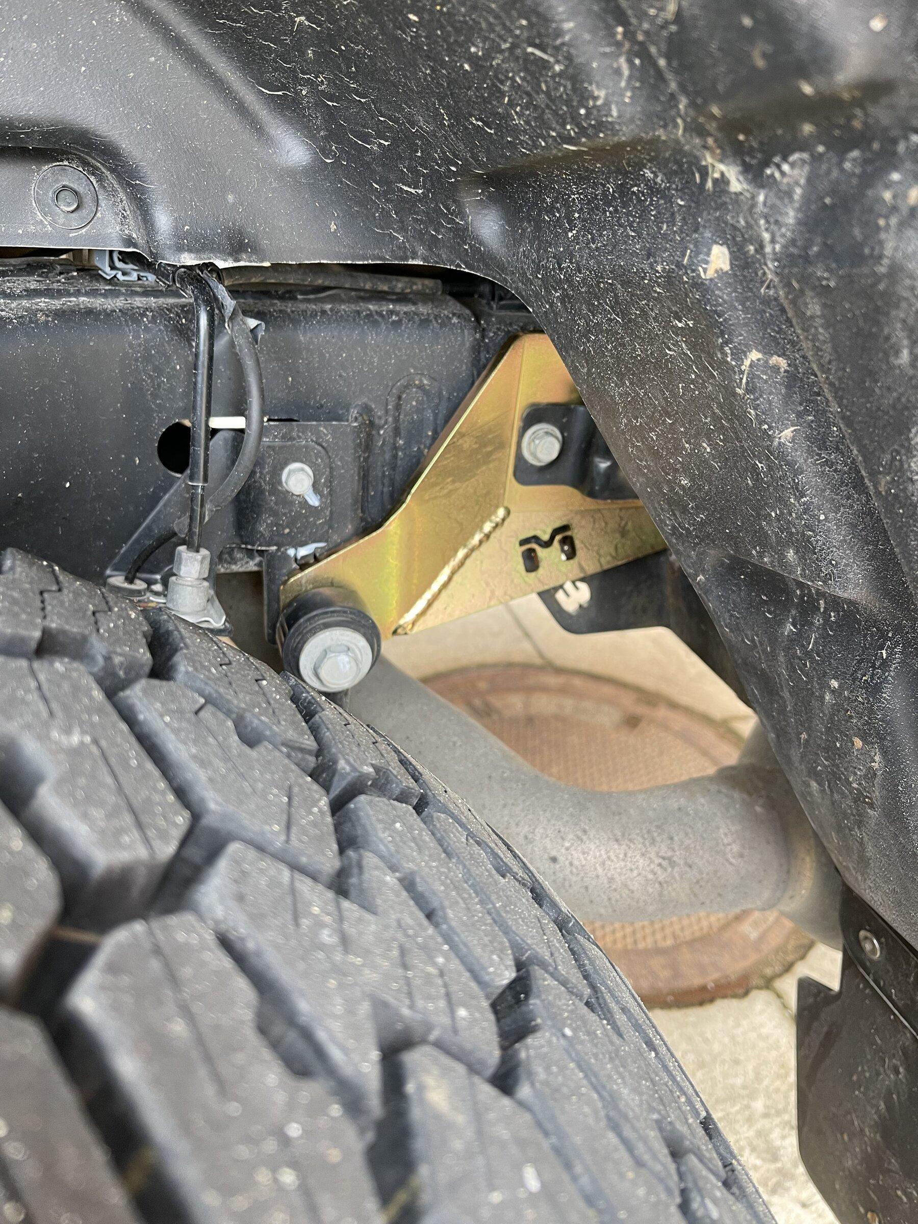

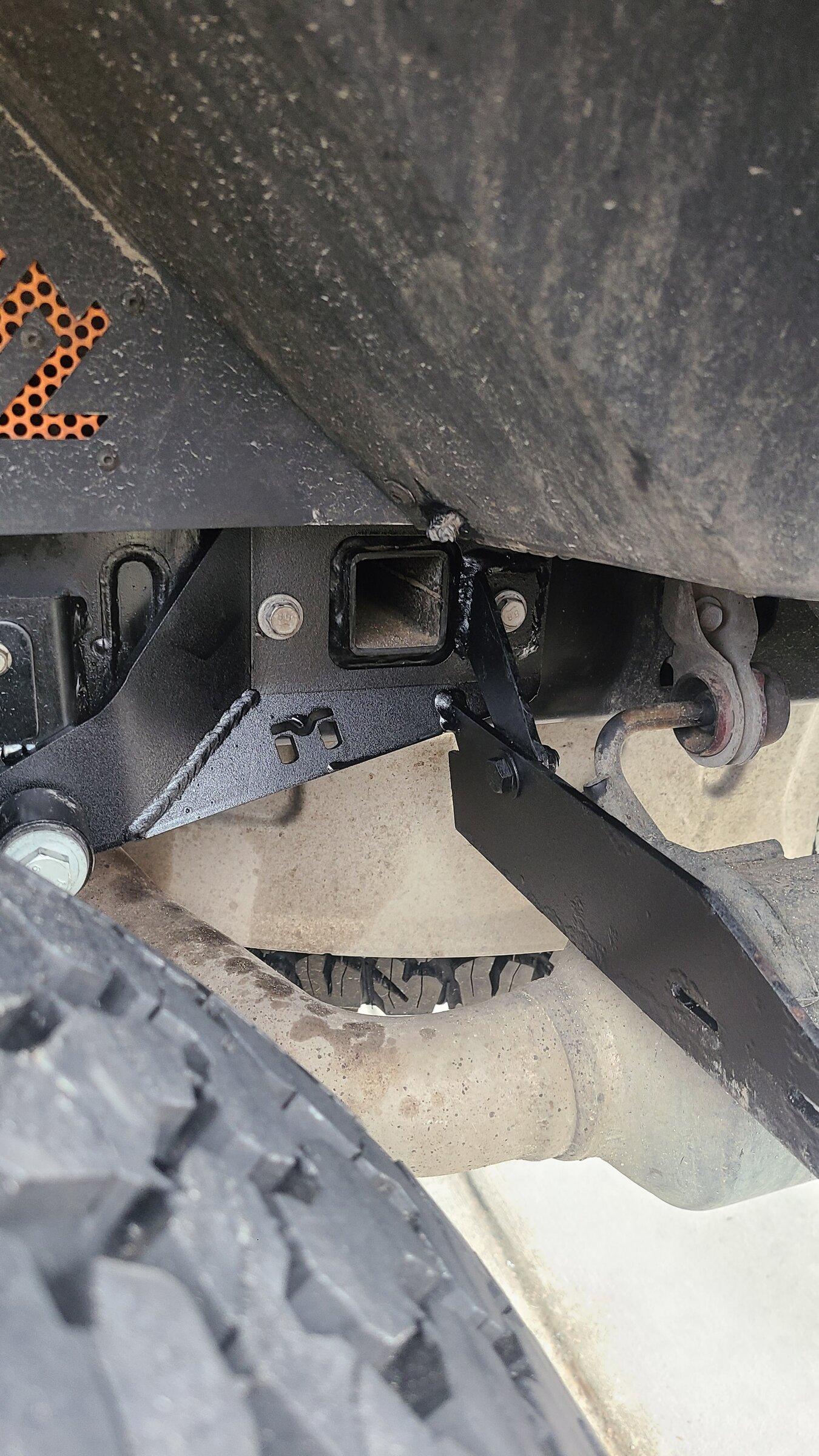

Got mine installed today, with the RokBlokz mudflap brackets also installed. Fits perfect. Thanks @Jaxmax for providing a great template for where the mudflap brackets needed to be modified.
