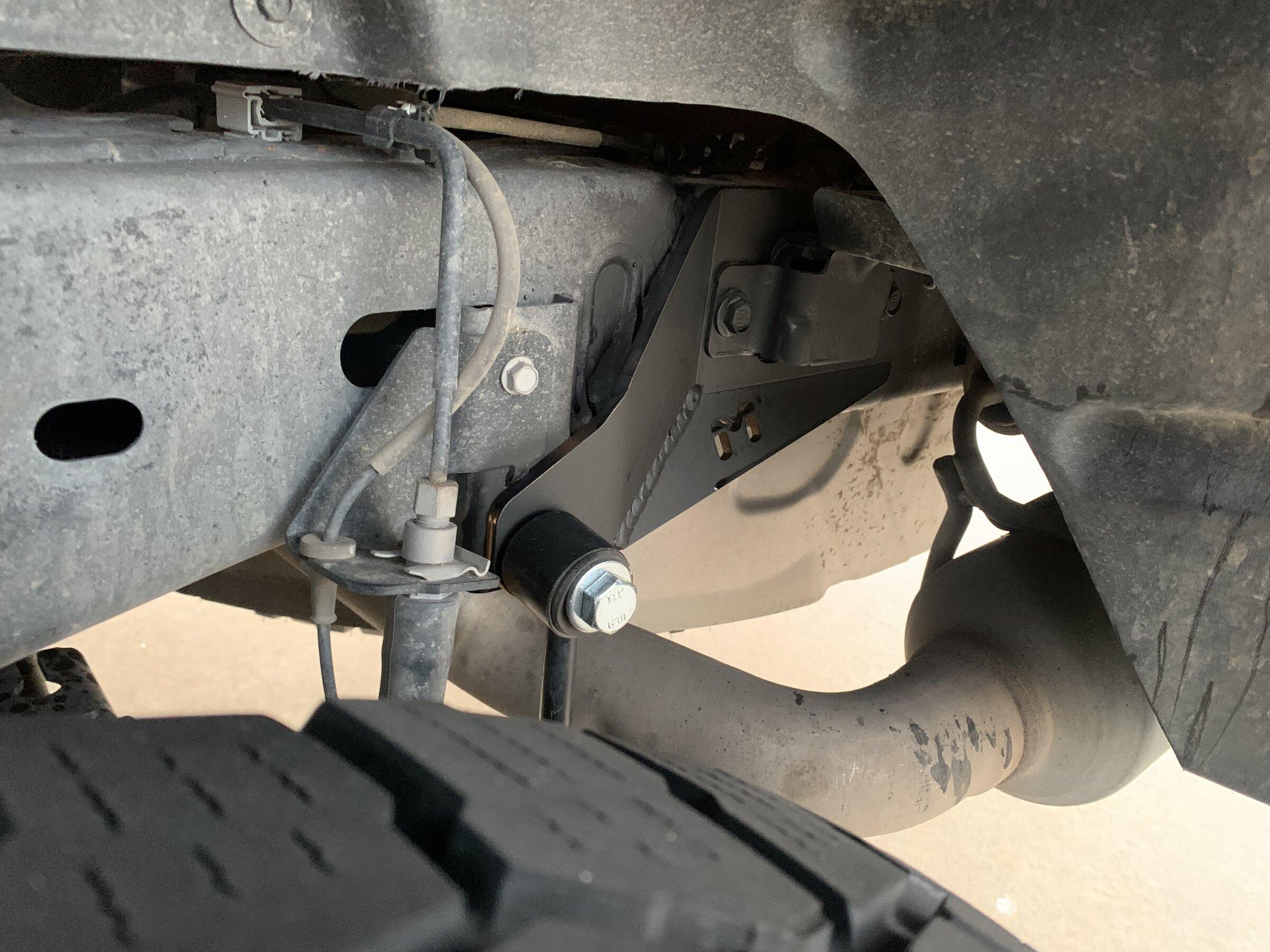

So the Heat Shield does "FIT"
It kinda gets bent into place when you ratchet the two bolts home.

Not sure what it was meant to do. I just shoe horned it on.

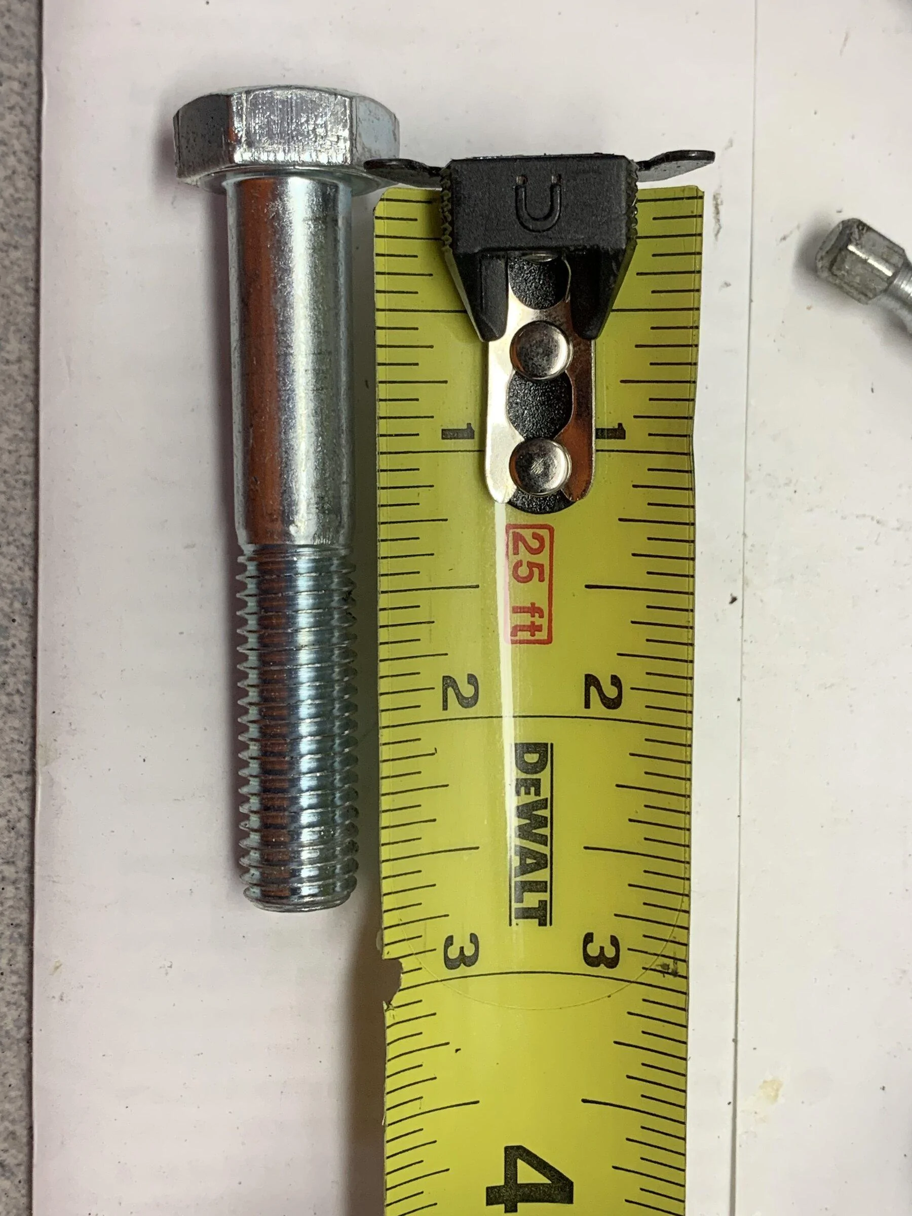

I guess I had buggered the sway link nuts when I installed my AEV spacer lift, now the stock bolts weren’t really working.
So I decided to drill out the OEM nuts to use the Metalcloak bolts 12-1.75 (which don’t fit stock 12-1.5).
Problem is, those bolts are meant to accommodate people that have cut off the oem bracket or nut. So they’re not long enough to put the Metalcloak nut behind the stock nut.
12-1.75 by 90mm bolts from HD will do.
Nevertheless, got them on!

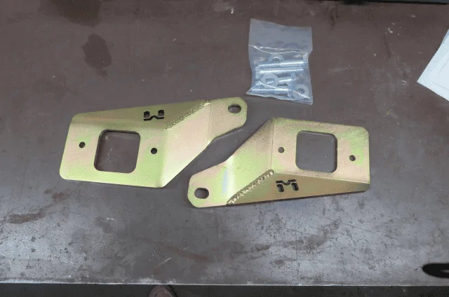

I haven't installed mine yet. I got 2 sets of bolts that are different lengths. Did you?
Nope. Only two bolts.
Jeep Gladiator Rear Sway Bar Reinforcement EC9C1118-440B-40F6-A3EA-5F6CDA4DD3FE
12-1.75. Stock nut is 12-1.5 for my 2020 JT.
I bought 12-1.75 by 90mm grade 10.9 bolts from HD. Conveniently came in a two pack haha.

The bag I got with the braces have 4 bolts. As you can see. There is 2 different lengths.
Nice workaround, I just installed mine the same way, front flap underneath, rear flap on top. I cranked it down with my air ratchet. It seems to be almost flush with the frame, so, I am leaving it like that. I bent two rear end links, one at Holcomb Creek, and another on John Bull trail. Both times I was able to replace the end link rod and bend the tab back down. Now with the metalcloak, the end link will bend, but the tab will always be stable. Just replace the end link rod.
The bolts supplied are the wrong pitch for the existing welded on OEM nut on the OEM mount. So, I had to use the stock OEM bolt for the end link.
