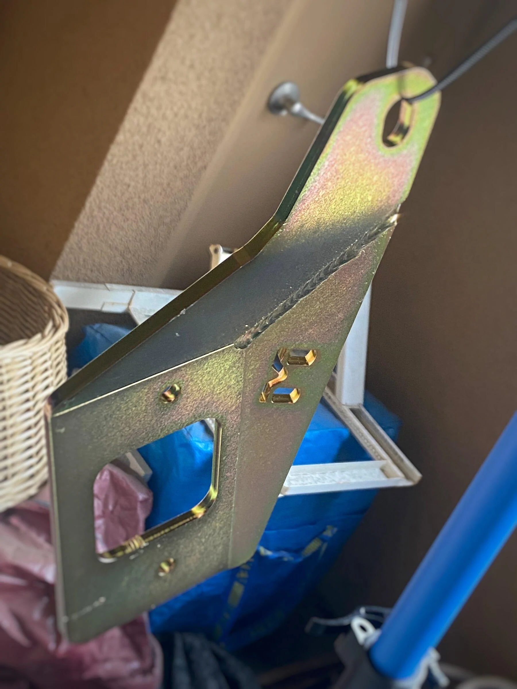

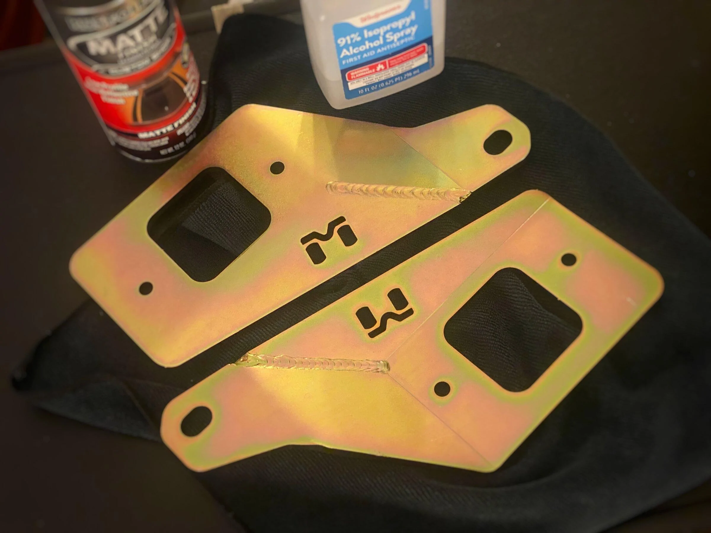

Just received mine and are prepping them to get rattle can matte black. I'll try to install Sunday morning.
