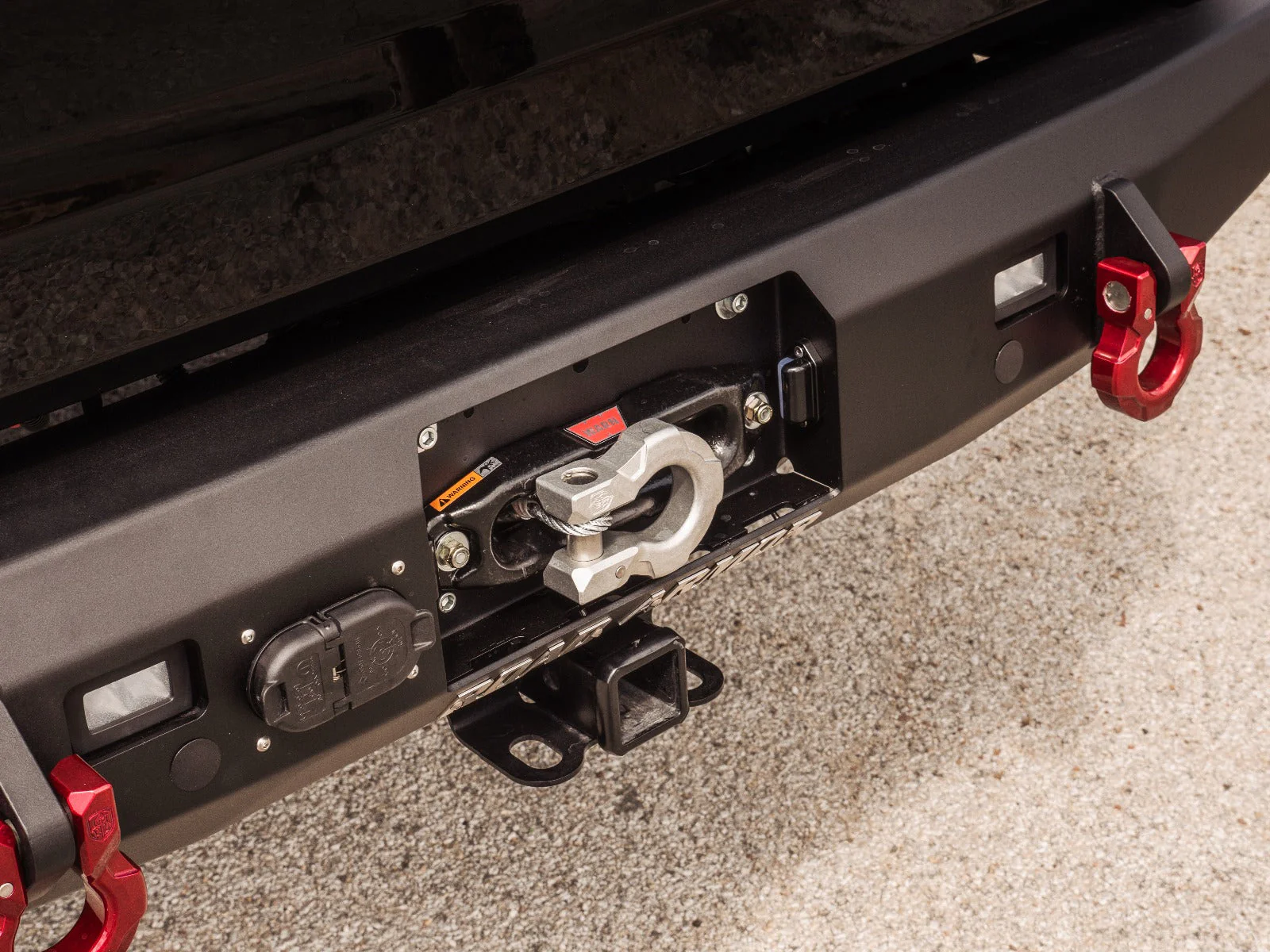

I have never seen that bumper with the winch mount built in looks good exactly what you hear people describing. The only issues are similar to any hidden setup you can not see the line as it spools and how do you access to the free spool lever. I like bumpers that have a provision to use the stock from Jeep recovery hooks although i would not have any fear of problems using this design probably about as strong as any. if i was looking for a rear mount that did not rely on the hitch it would be hard to not consider it as a good start and from there making a few modifications. With a Warn M series and relocating the control box up out of the way it would probably work great as long as you did not have the rear buried.

The Stealth bumper might make a good start, but doesn’t solve the access to the spool or free spool handle problem. I also haven’t seen how they incorporate the winch….. is it solely supported by the fairlead bolts?
