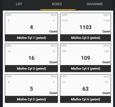

Just for example - really easy to track down misfires with jscan while you drive -
Jeep Gladiator Recalibrating for bigger tires? 1695570677892

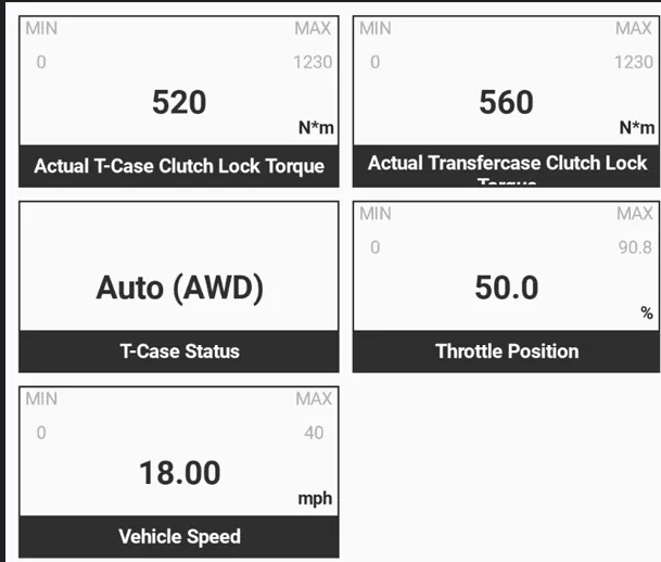

Want to learn how the SelecTrac transfer case operates - JSCAN will show you live results -
Jeep Gladiator Recalibrating for bigger tires? 1695570778151
