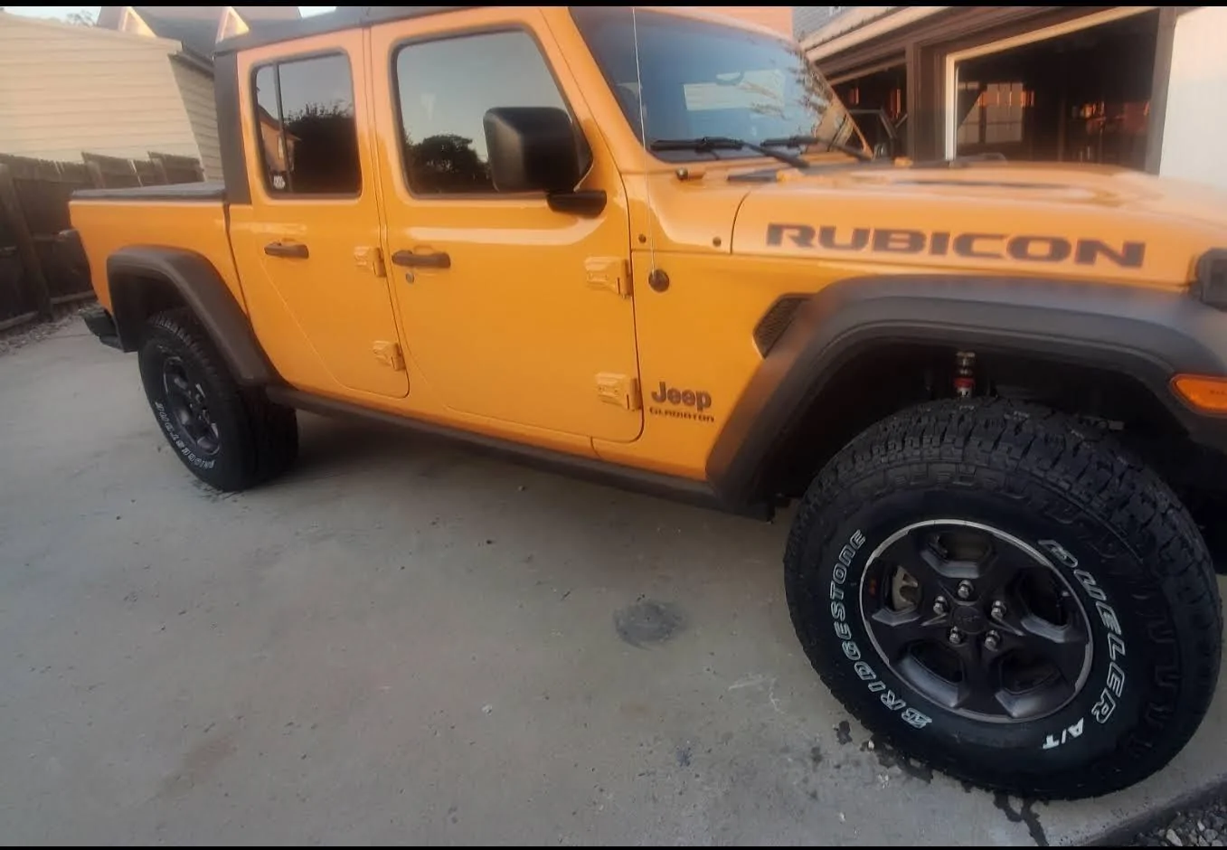

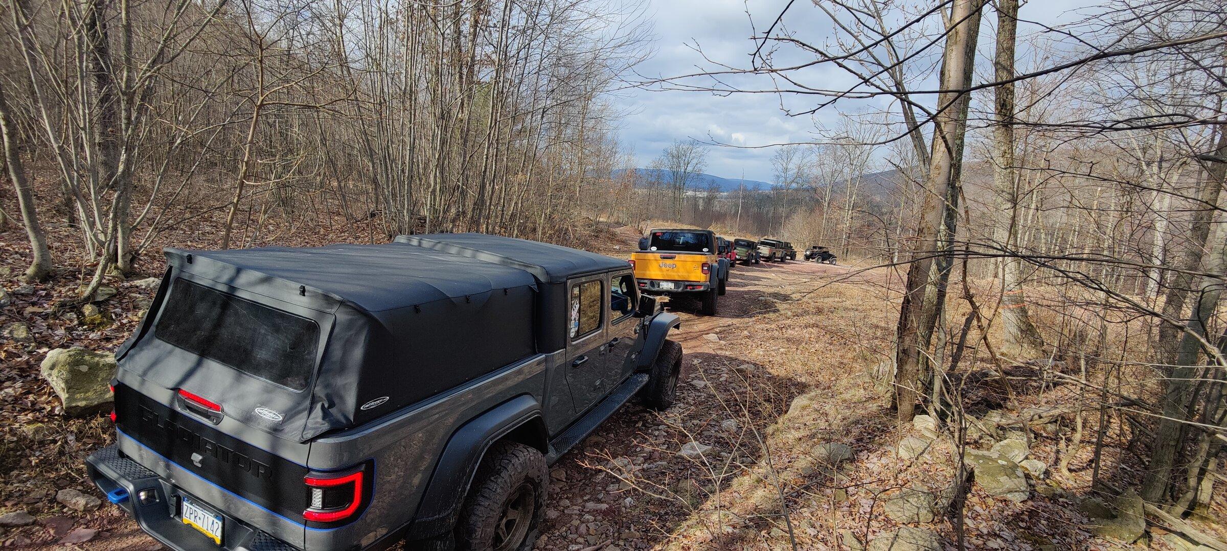

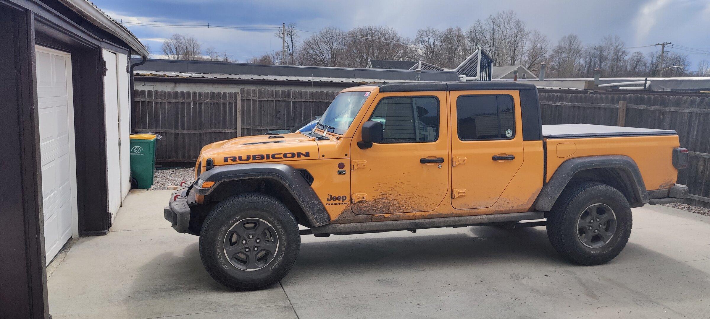

35s just fit on Mojaves and Rubicons. Out back, It isn't even close, so weight load won't matter, unless maybe you have like 2000 lbs in the bed. In front, at full articulation, swaybar disconnected, they will fit. When the gladiator first came out, jeep openly spoke about and acknowledged that they'd fit, and that they are designed to fit. The wide axles and the high clearance fenders + the added suspension height give enough clearance for 35s, to really, truly, absolutely fit. They fit! I promise. I don't know what you mean by true 35s, but a 35x12.5x17 or a 315/70/17 will fit, and be fully off-roadable, on a Rubicon or Mojave. It's a non issue with the wider axles and high clearance fenders.
I have a spacer lift now, but these are all before that. Just about all of us in the pic are on 35s or 37s, and most of us didn't have lifts. The guy in back on the 37s does.
