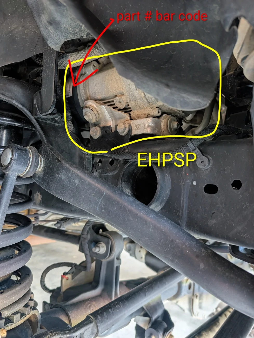

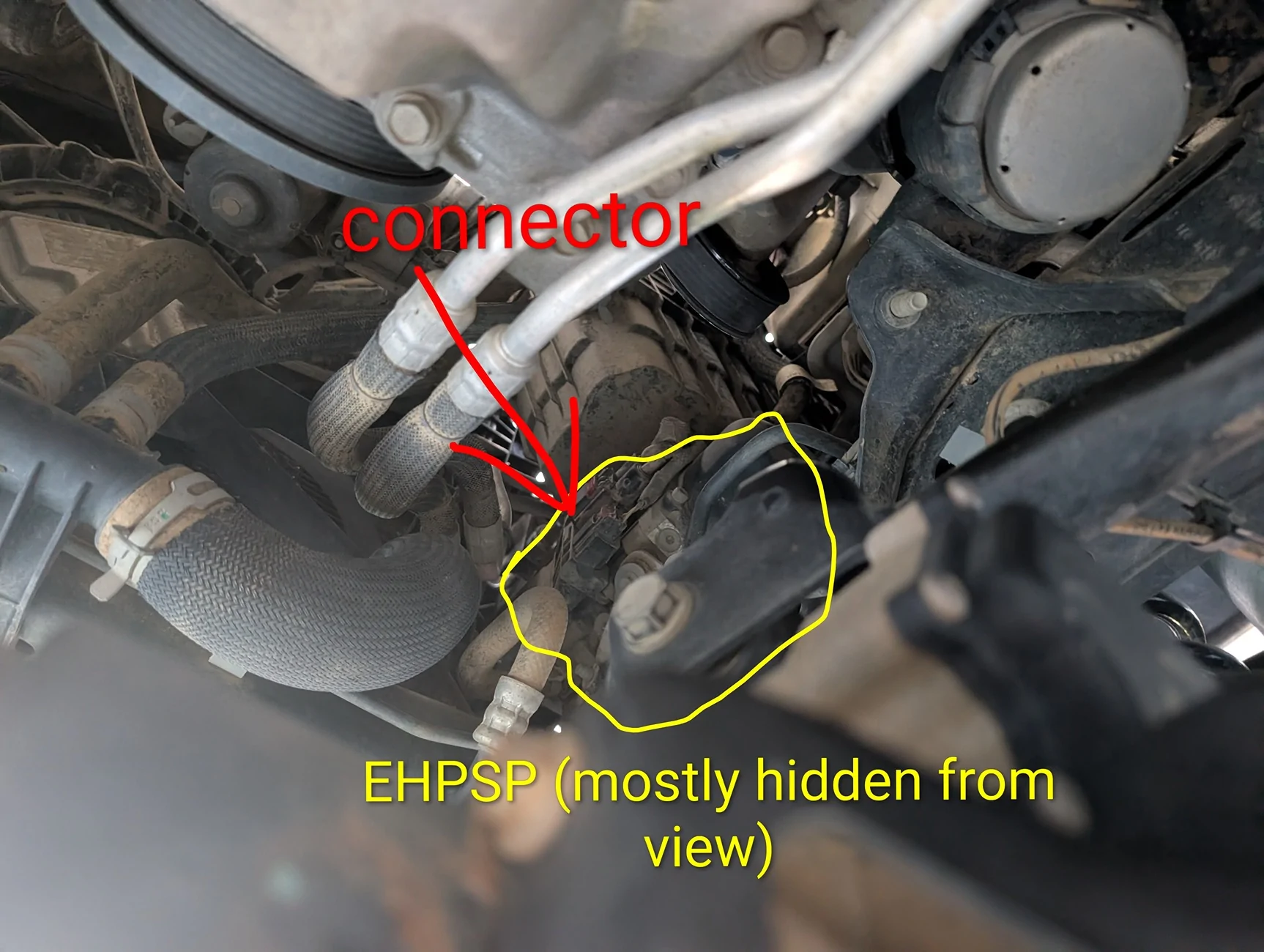

My interpretation of the recall notice is that the connector to the EHPSP (electric hydrolic pump) is the target of concen. You can see this from underneath the engine bay, on the passenger side, above the frame, and just ahead of the front axle line. Here are some pics of what I saw when I looked:
Where to look:
Looking in from the front passenger-side wheel well:
Jeep Gladiator Recall: 1M+ Jeep Wrangler and Gladiator Fire Risk (June 9, 2026) PXL_20260613_150444569.NIGHT~4
View from below, looking up:
Jeep Gladiator Recall: 1M+ Jeep Wrangler and Gladiator Fire Risk (June 9, 2026) PXL_20260613_150758456.MP~3

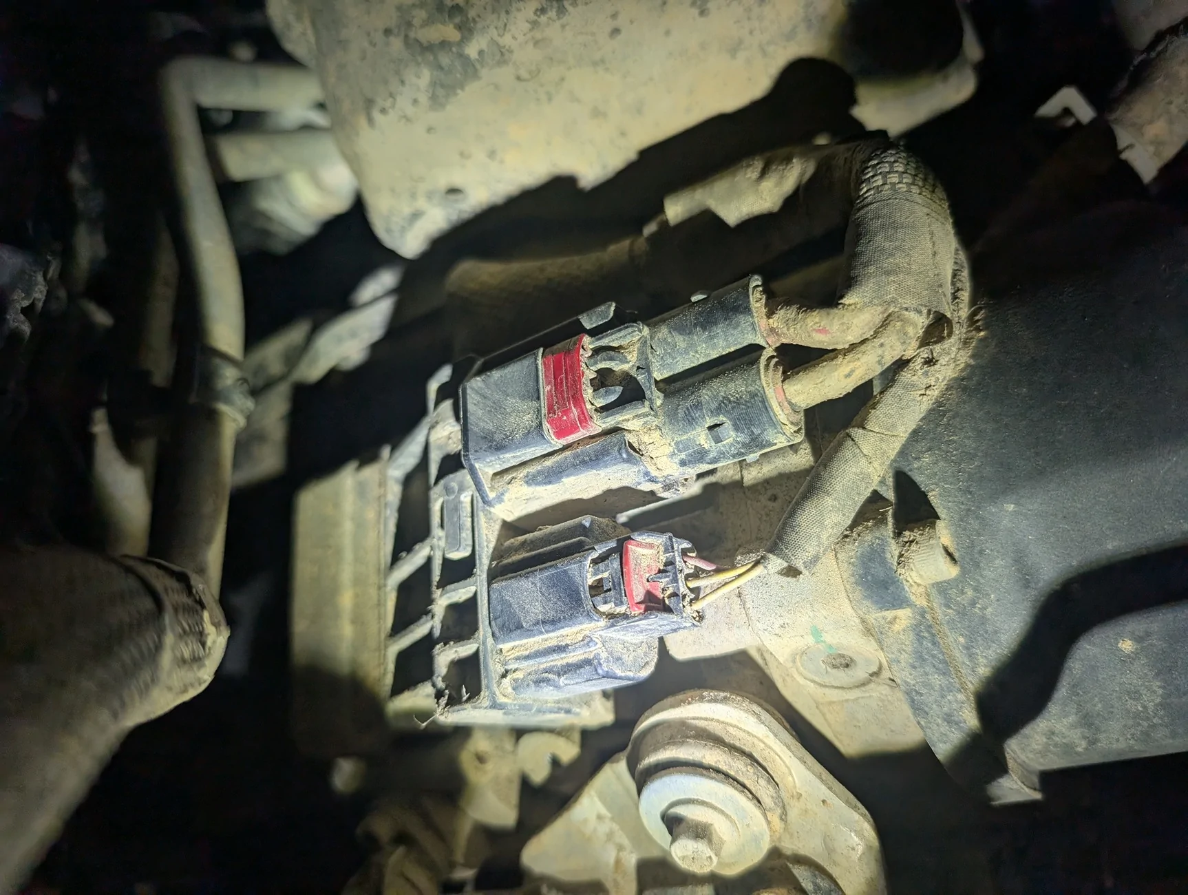

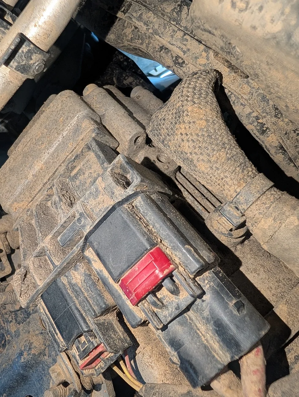

Close up of connector, from below:
Jeep Gladiator Recall: 1M+ Jeep Wrangler and Gladiator Fire Risk (June 9, 2026) PXL_20260612_193941835
Jeep Gladiator Recall: 1M+ Jeep Wrangler and Gladiator Fire Risk (June 9, 2026) PXL_20260612_194220558
I suspect this is what it should look like. Hopefully yours is not a distorted or melted glob of plastic.

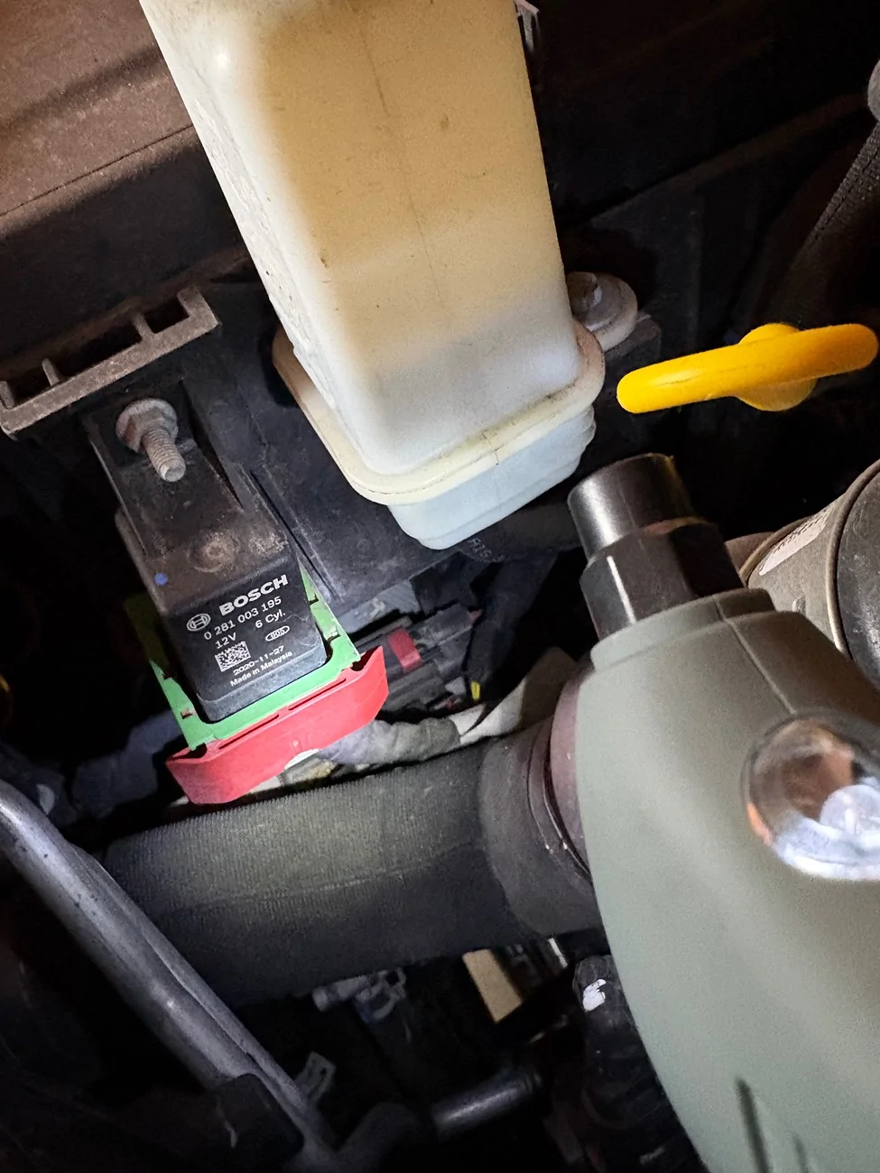

Visually checked what I believe is the problem connection on mine, connector with small red tab in the background of pic below, it doesn’t show any visual signs of excess heat or shorting out. On the 3.0 it is very easy to see, just follow the hose from the bottom of your power steering fluid reservoir down to where it feeds the pump and the pump electrical connections are right next to it. I will probably try touch testing for heat after driving as well, although everything gets hot in the diesel engine bay after running for a while🤣
Jeep Gladiator Recall: 1M+ Jeep Wrangler and Gladiator Fire Risk (June 9, 2026) IMG_0773
