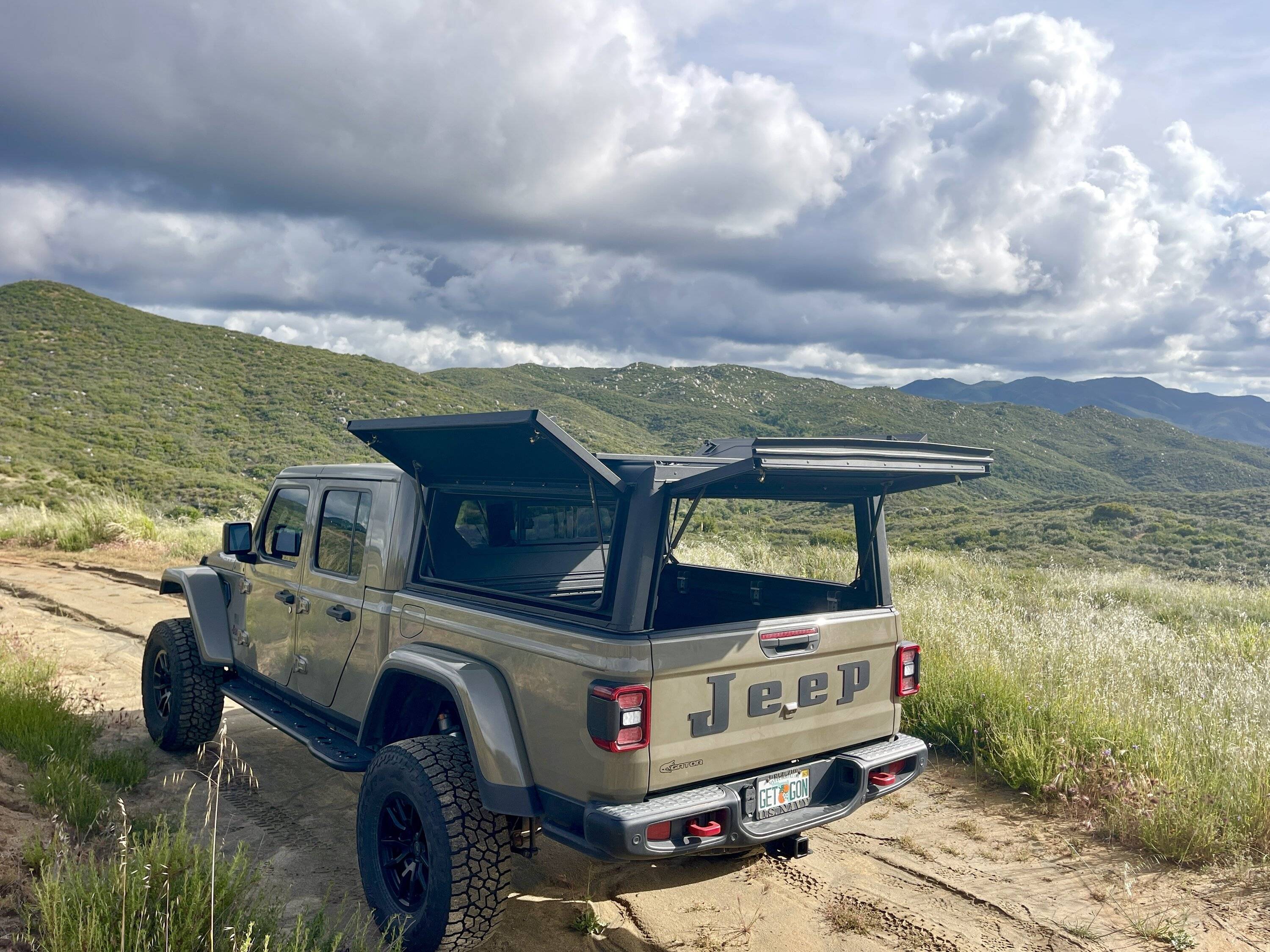

I love my ARE CX Classic..I think it follows the lines of the Gladiator overall real well.
I really like this one, do you happen to know the exact specifics for it? Did it already come in that color and material or was that an addon? I looked at their website and it seems to me messing around in the builder app that they just come in smooth white.

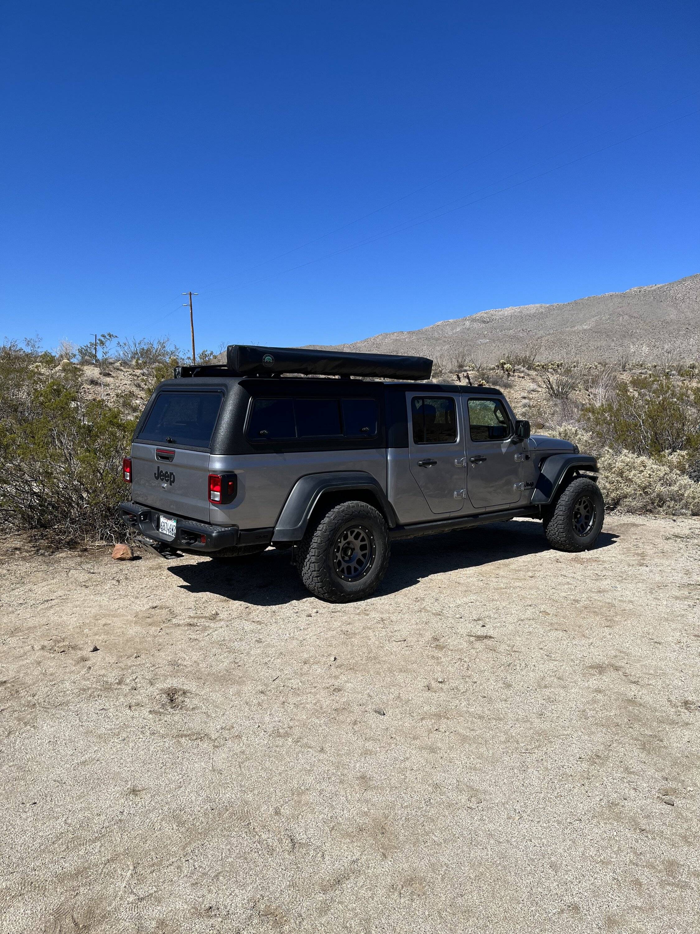

so my topper is basically fully loaded minus the overpriced electrical stuff... yakima rack, two side windoors,, front sliding fold down window(must have for cleaning) The OTR option which is a rhino lined type of coating that is BULLET proof. Very happy with this set up

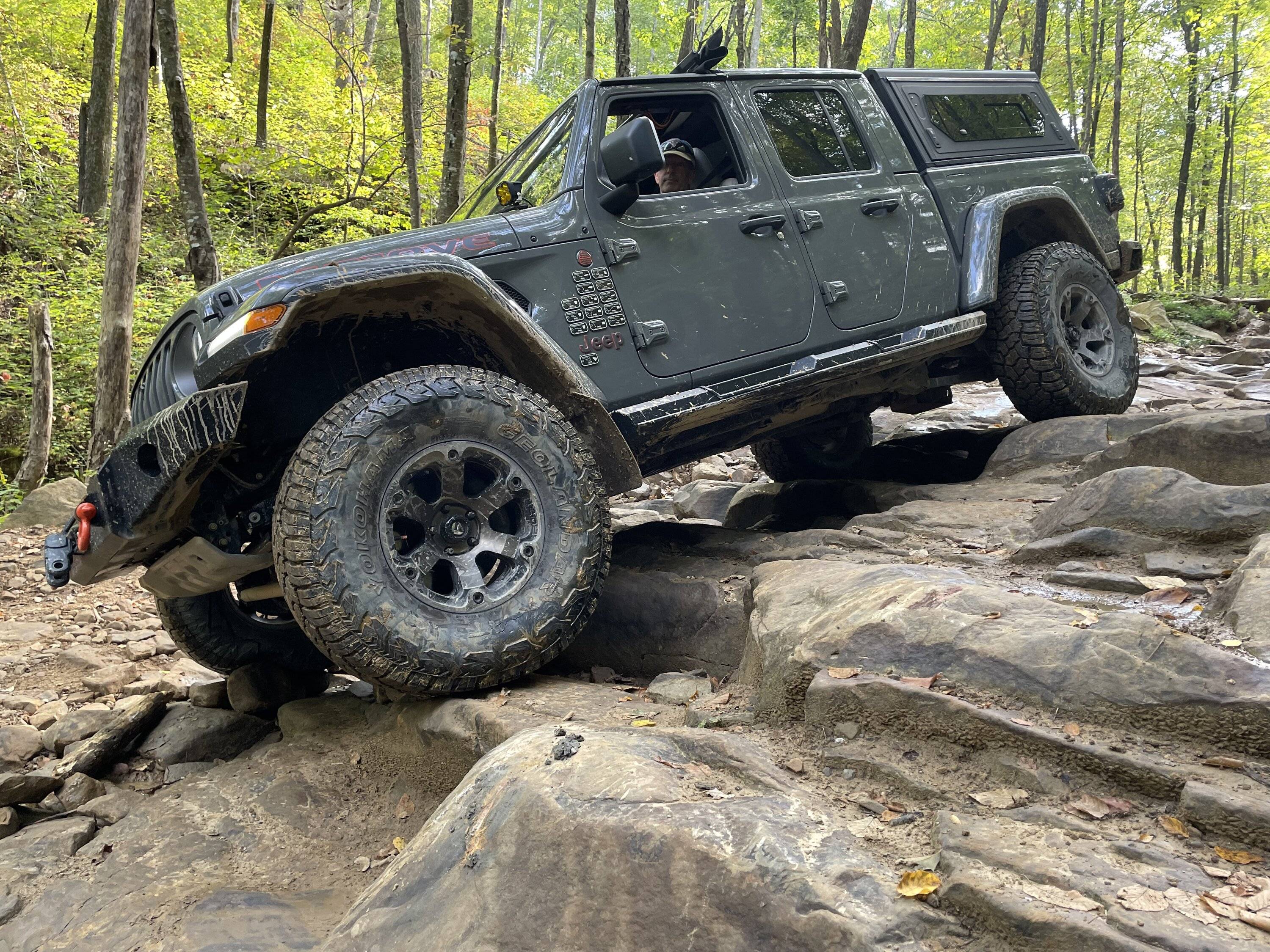

That’s the matte black they produce specifically for the Gladiator. Adds $573 to the price. Color matched paint is included in the standard price.
