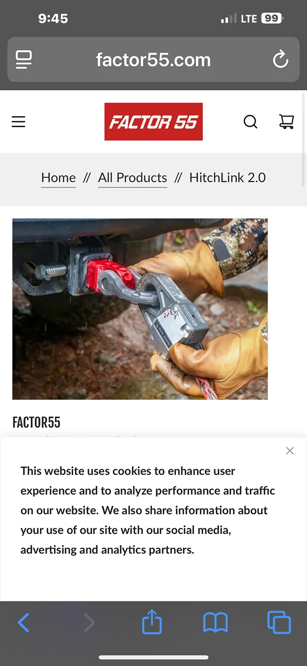

The tow hooks on Jeep bumpers are solid , not sure if you have two on the back , but I do , but still like a hitch mounted skid plate with attachment point or you can get an insert for your hitch that allowed shackle to mount on it, safest way to pull is with shackle at hitch less chance of things falling off the hook. Never use a hitch ball to tow…..Jack
Jeep Gladiator Recovery hooks on stock Nighthawk bumpers IMG_5171
PS your thread got me thinking need to get a hitch shackle insert for myself to have to insert in someone else’s hitch to help pull them out!
