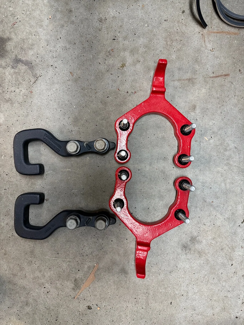

Going off what Freems said, I have stock rear tow hooks and some aftermarket ones that will probably sit in my garage cabinet till the day I die if anyone in the Atlanta south side (30269) wants them. Locks pick up only. Free fitty.
I have two rear because I hated the asymmetry on my overland. I didn’t like the red on my front bumper so I used my stock ones. I like red, but I have no other red accents. I’m not using those bumpers anymore.

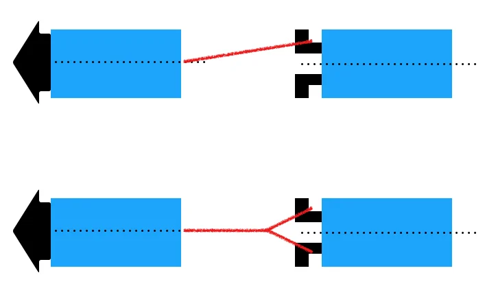

If you were only to hook a strap to one of them though, which I think most people probably would in a recovery situation, and say yank the jeep backwards in the mud, the direction of the shift of the ass end of the jeep will actually shift the loop to the closed side of the hook. So I think they make sense the way they did them for most people that don't put thought into these things.
I was thinking exactly the opposite. I’d want the pull to go towards the center of the Jeep. In the rear with the tow hitch installed doesn’t that factor in a “triangulation” point? I’d think the frame was stronger there than the force going towards the corner. I’m by no means an engineer though so maybe one of those professional types can chime in on that.
I'm just saying I've seen hundreds of people do recoveries and it's really common for people to just throw a strap on one hook. And in that case, the strap is going to pull towards the closed side of the hook if it's a low traction mud situation. There's lots of variables, just saying I bet there was a reason they put them the way they did.
It's not ideal but it's what people do.
Not trying to disagree, but the scenario you propose only applies if the vehicle pulling on your hook is off centerline from your vehicle and pulling at an angle; much like examples others have already cited where a vehicle has slid off the road into a ditch. In that type of scenario, the pulling vehicle would be up on the road and would be pulling at an angle and would seat the strap loop into the closed side of the hook.

I certainly agree with everything you're saying, like I said, lots of variables anyway. Vehicle positioning and traction will ultimately determine anything. I think we all agree that open hooks aren't the ideal way, regardless. I'm just used to growing up in muddy appalachia and watching people do hard tugs in mud and the momentum in any asymmetric pull would rotate the vehicle being pulled.
I used to be a graphic designer and don't have any software installed on this computer so this kills me a bit but here's my quick paint drawing to try to illustrate what I was talking about
Jeep Gladiator Using Stock Bumper Tow Eyes For Recovery? start
Jeep Gladiator Using Stock Bumper Tow Eyes For Recovery? end

Totally agree. What I don’t like about the hooks in that scenario is the possibility that the loop can pop off the open throat before the back swings and then seats it in the back of the hook.
Possible, yeah.
It's funny because I'm sure this was, at one point, discussed at length by a design team.
How much of it just has to do with the odds of the angle of pull from a ditch style recovery in the winter? I have no idea.
Absolutely right. The funny thing about it IMHO is that there are other vehicles where their design teams came up with outward facing throats and the vehicles were manufactured that way. I even think the 90’s era RAM trucks came that way.
In one of my previous lives I was a certified rigger and always had to account for high incidence angles in the lifts we were performing. We always made sure that we limited the risk associated with that open throat.

I can see both sides if you are pulling straight on, from that side or the other, one angle or another it could be an issue. I guess if you leave them as is or flip them around you just have to account for the opening either way. The only thing about recovering vehicles, moving things, hoisting or whatever every situation is different. I do not think it matters much the way the openings face as long as you plan for the situation. Accounting for what you want to do and figure out the safest way to do it looking at the possibilities' of what could happen.

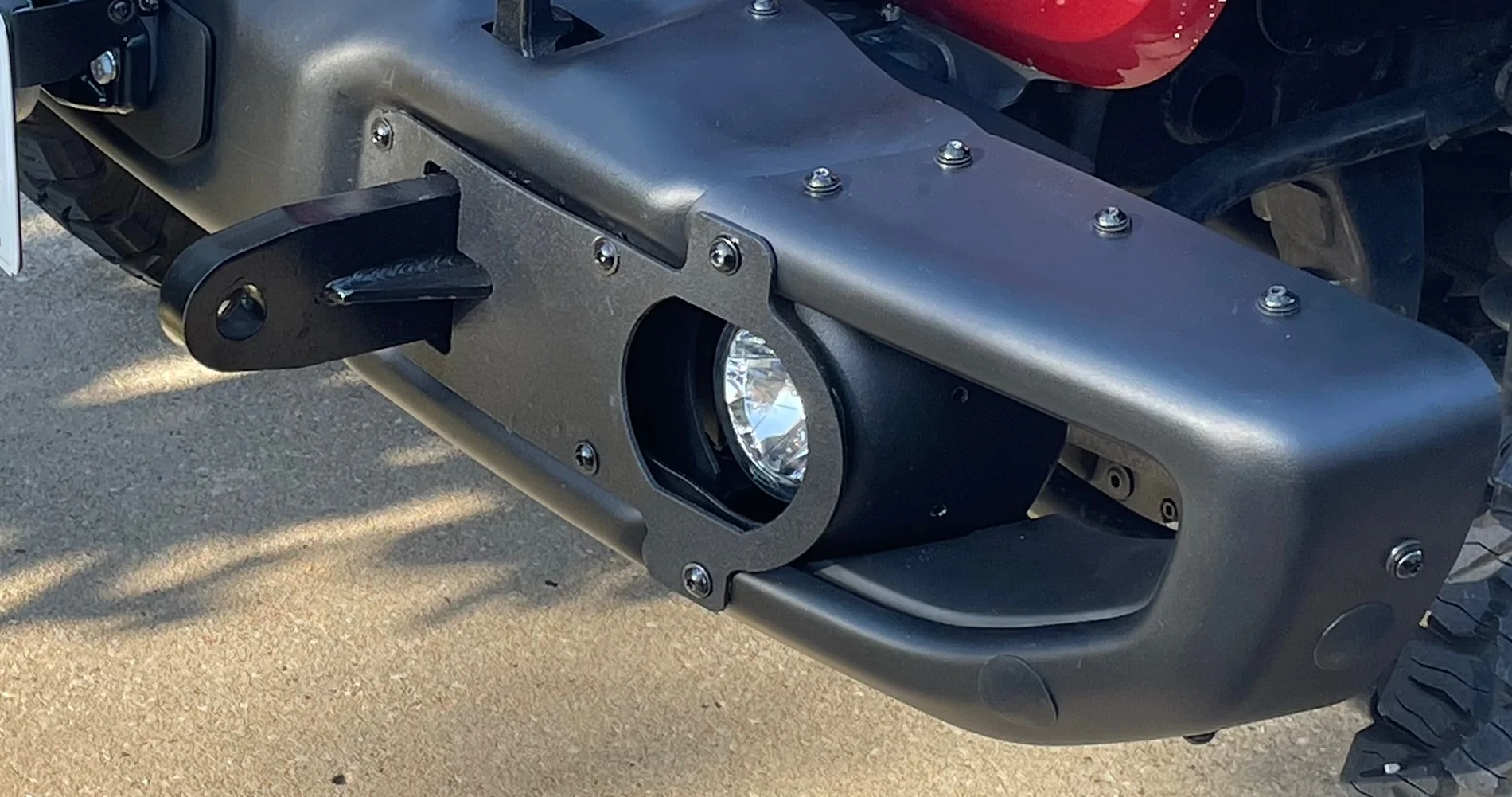

I'll second the Bandit as well. The rear bumper hooks are perfectly fine. I've not had to use mine but I have winch pulled on other people's JLU's and Gladiators that had the same hooks.
To head off the obvious next question: the front hooks are fine too. I personally don't like that style of hook and prefer something that allows a more positive connection. I "augmented" my front bumper with some shackle mount points that pass through the bumper and bolt to the frame horns:
Jeep Gladiator Using Stock Bumper Tow Eyes For Recovery? {filename}
I used the same FrogFab brackets and combined with these replacement steel bezels:
https://www.hkoffroad.com/collectio...-jt-shackle-tab-kit-for-stock-rubicon-bumpers
Jeep Gladiator Using Stock Bumper Tow Eyes For Recovery? IMG_0523
