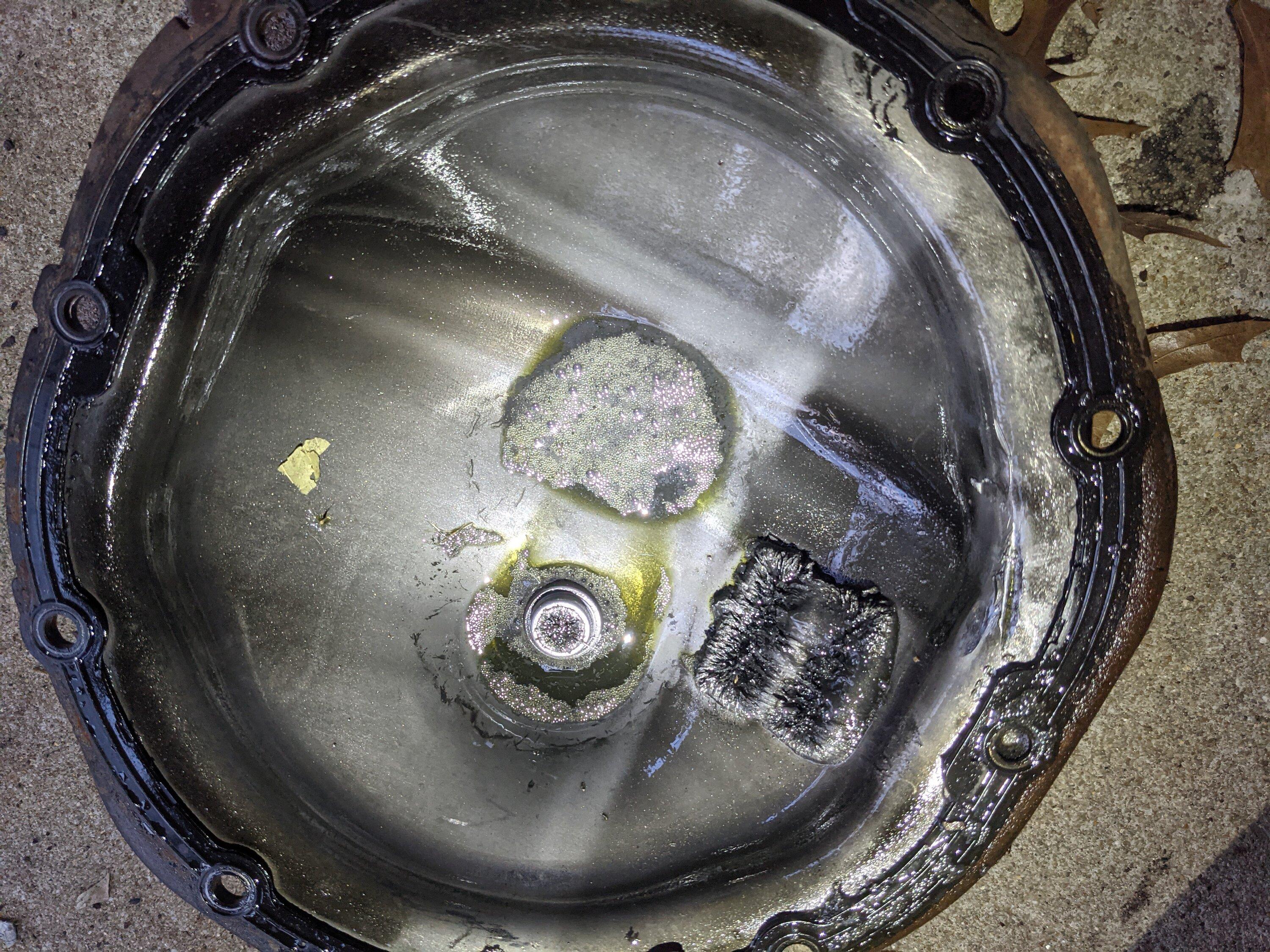

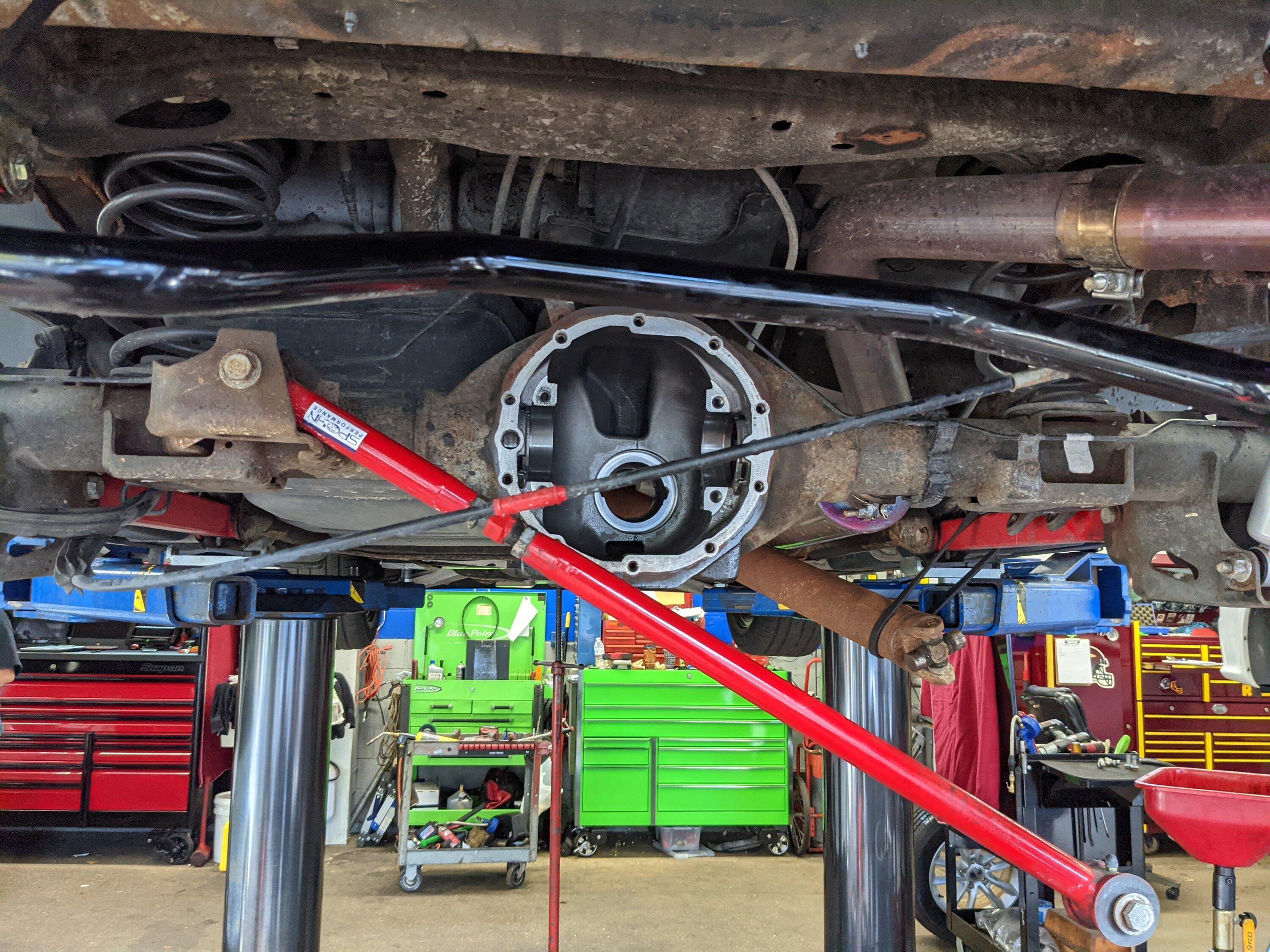

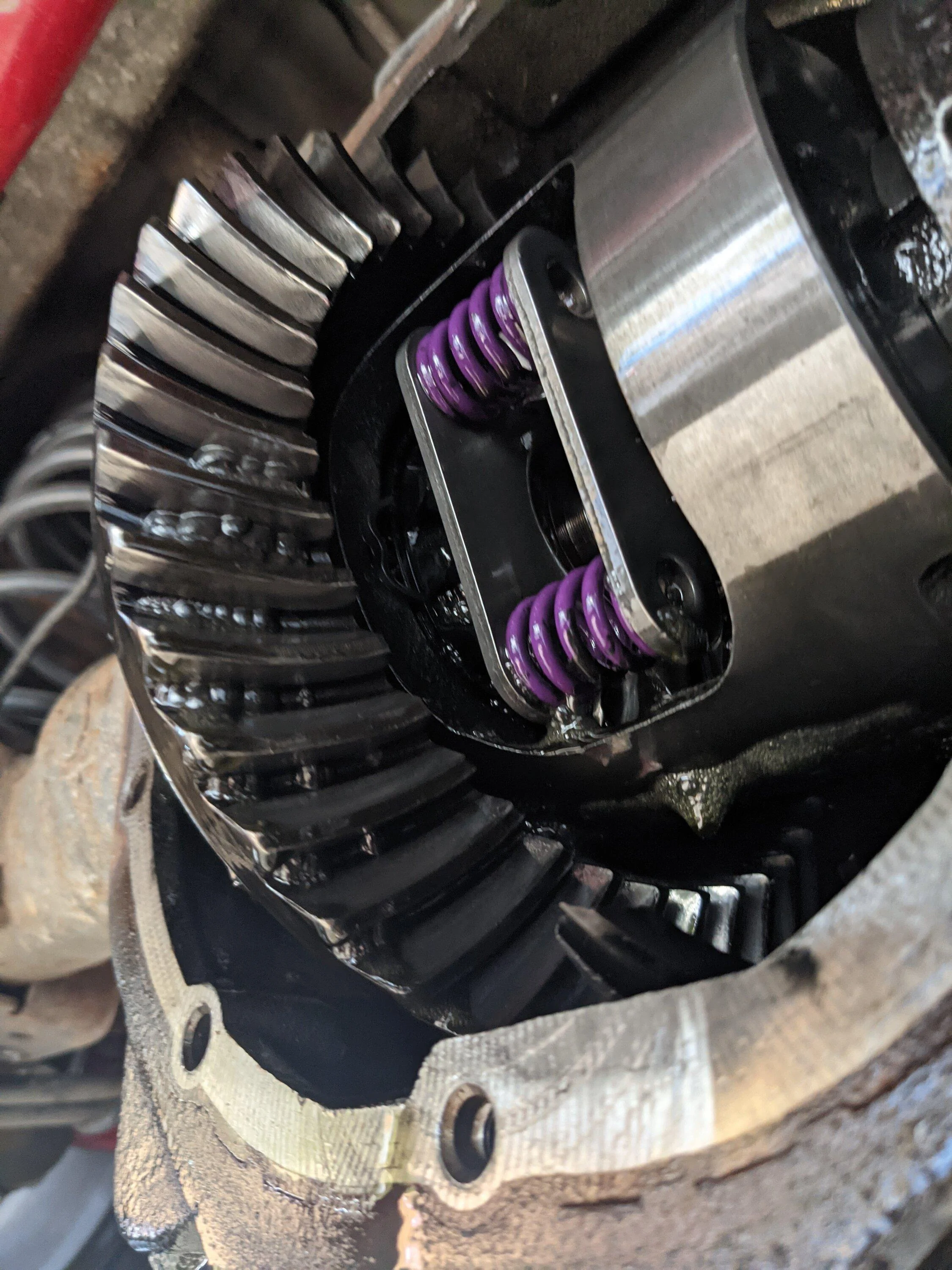

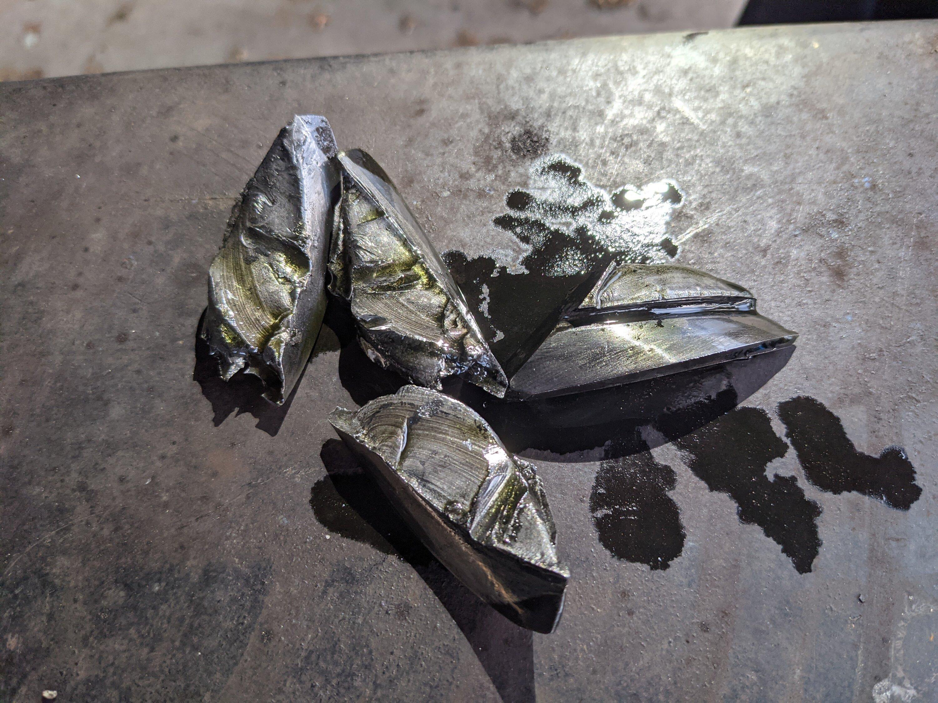

Tackling this particular task is not for the average DIYer either. One the special tools required (though offset labor cost) then the knowledge for setting the ring and pinion gears isn't something you can just learn off from YT. If your pinion depth or back lash is off, you'll grenade the differentials.
Take this for perspective or my experience. I'll rebuild engines and transfer cases, but I leave the ring and pinion jobs for my buddy. Again, that's me.

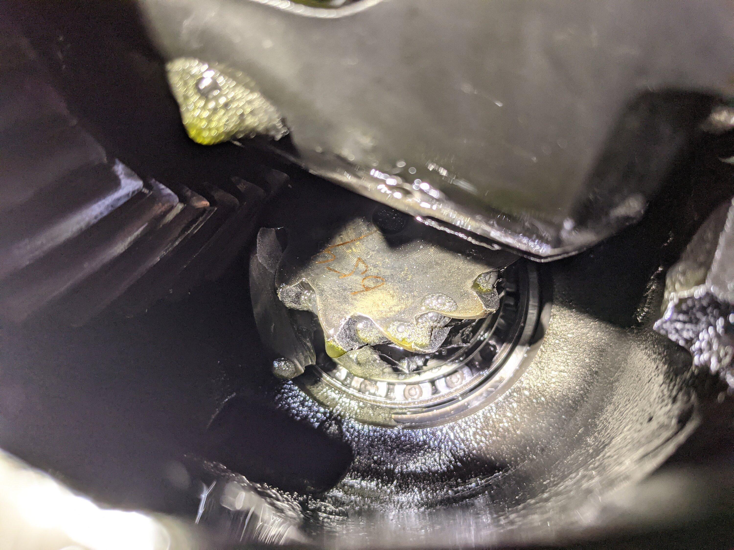

Hope this helps? Not only that, in most cases of the install is completed by certified vendor you get a nice warranty. I went down that rabbit hole with my Tahoe. FYI, steer clear of Yukon Gear and Axle ring and pinion sets........since they were bought out they out source to China now. My pinion gear shed 4.5 of it's 11 gears when I picked my son up from soccer practice back in the fall. Had to do a complete rebuild because of it.
Below are pics of the carnage. Both times the ring and pinions with master rebuild kits (bearings,seals,sims, hardware and fluid) we're installed by professionals........I just had Murphy say F you with some bad chinesim parts lol.

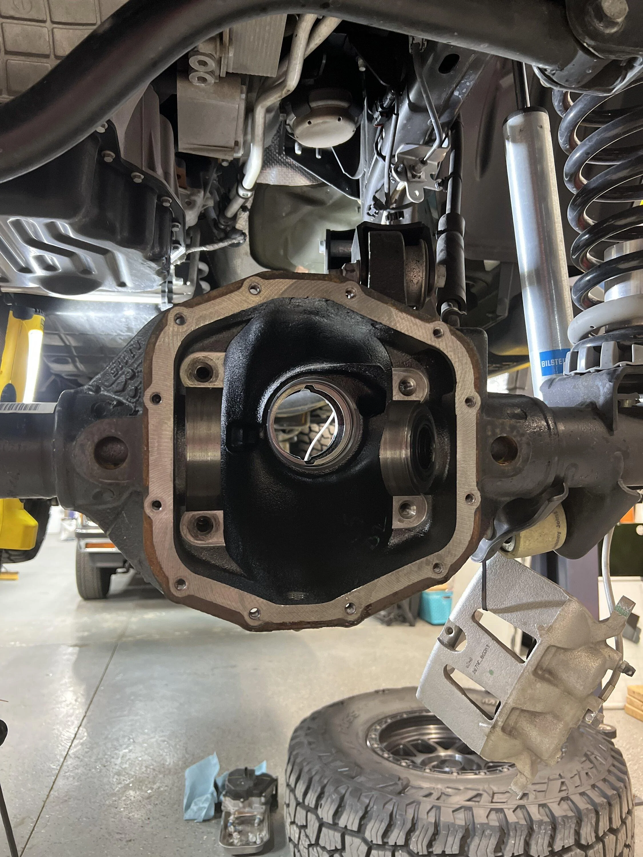

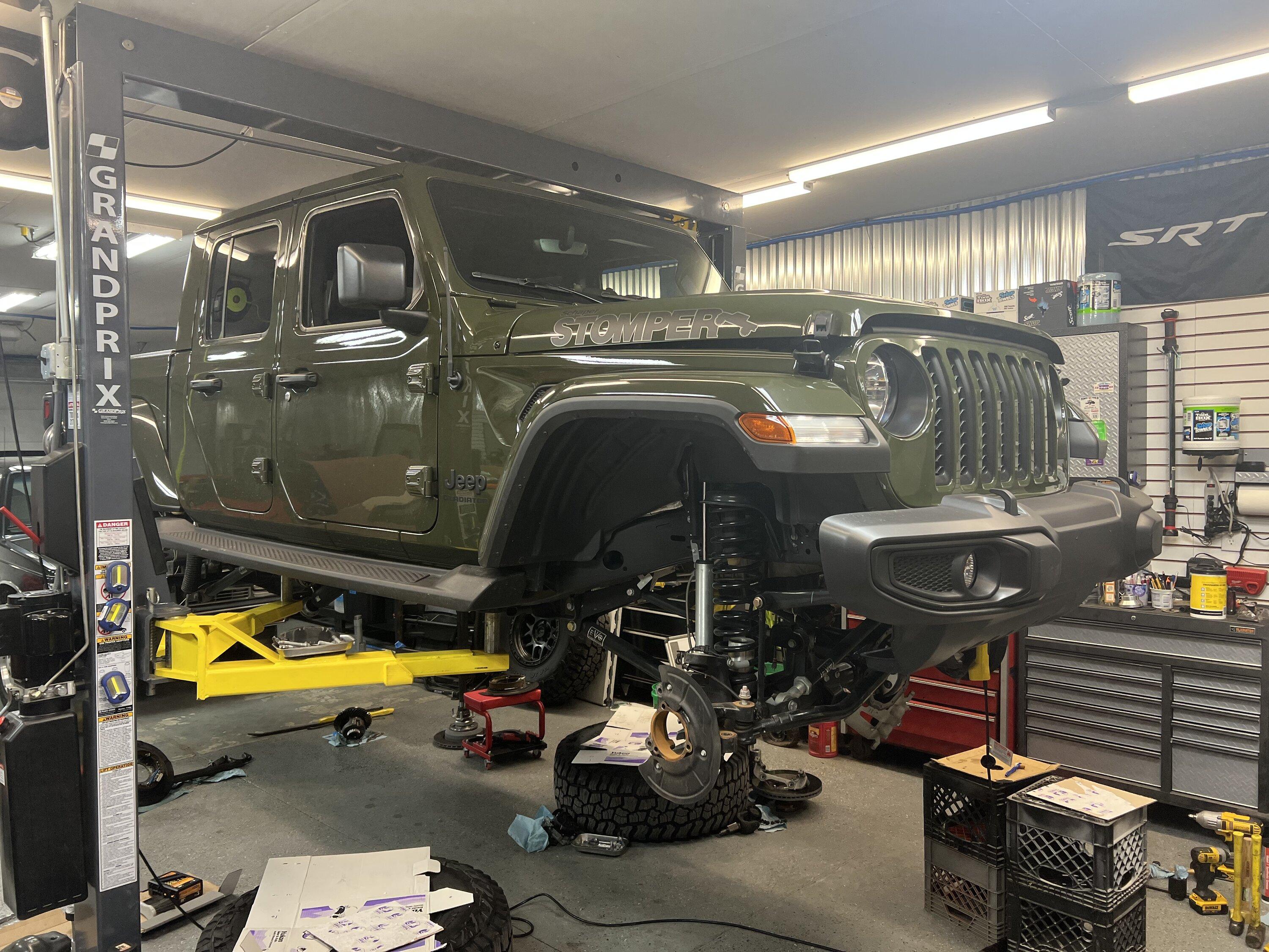

Installed my own Yukons. they turned out with an acceptable pattern. Your gonna need a press, bearing splitter, indicators, bearing/race drivers as well as all the normal tools. Gonna take you a while cuz it’s very time consuming.

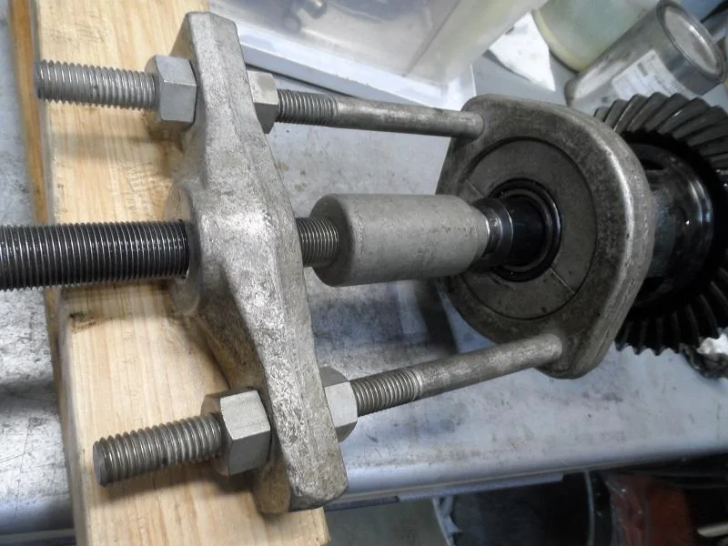

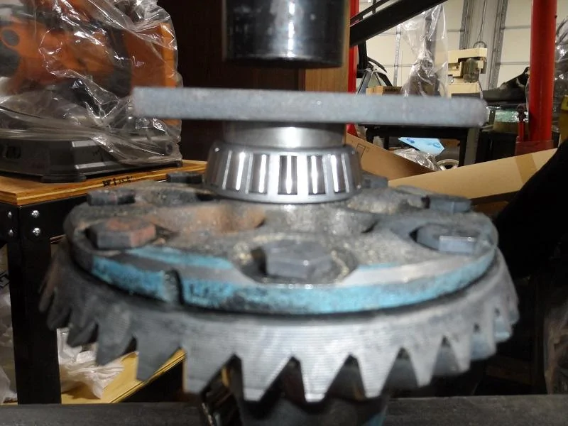

I'd do it as I was trained years ago and have done all of my own cars, and some for others.
But it's not a matter of taking out old and bolting in the new when swapping gears.
Replacing only seals and bearings isn't a big deal. but swapping gear sets can be a different animal.
You need to set pinion depth, pinion bearing preload, backlash and so on and get the pattern right. And you want both sides - drive and coast sides of the ring gear, to look good.
You'll need gear marking compound (whitish is best, IMO - some use Prussian Blue, but a white or yellowish is more easily seen on the ring gear teeth), and all of the other stuff others have mentioned.
Shims, bearings, seals, I have drawers full of Kent-Moore and other seal and cup drivers, and have made my own by turning down old bearing cups, a press, dial indicator, micrometer to measure shims, and do some math to sneak up on the right backlash, etc.
Ring gear needs to be torqued properly and with an alternating sequence or you can warp things.........
It's heavy work, the torque on things - like the pinion - not for someone only equipped with basic hand tools. I've had to break out my 3/4" drive set more than once.
I either use a bearing puller, or a Dremel with a cut-off wheel and a chisel., or I'm darned good at bearing removal with a torch.
