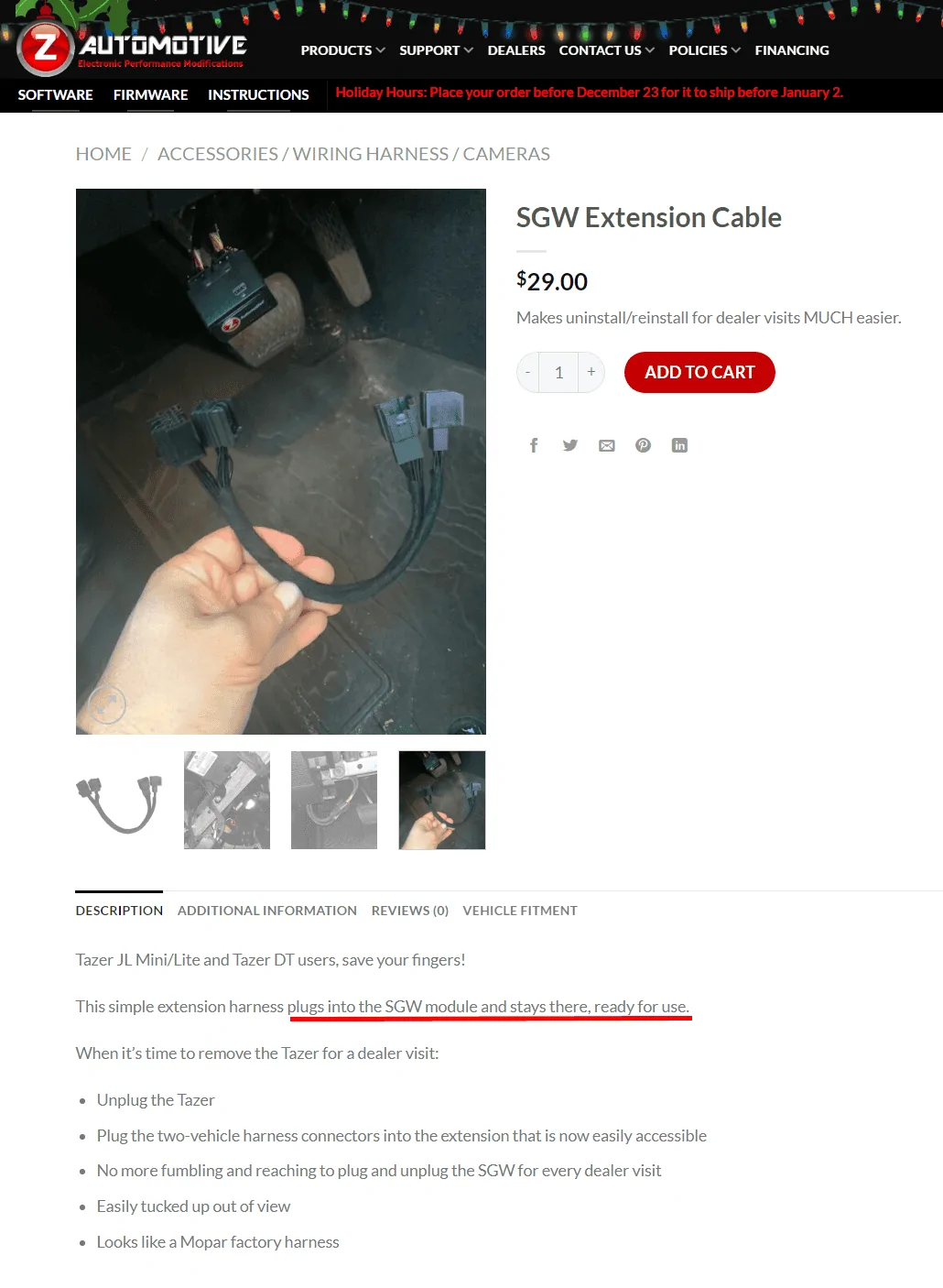

i took the two wires out of the gateway, plugged them into the extension. Then used both the Tazer and the OBD reader w JScan to look at and change a few things. I unmarried the Tazer and rebooted several times before i used the JScan. So i have to take the end of the extension and reach up and insert it back into the gateway? Im pretty good sized guy, to be able to get to the gateway i take out the panel right under the steering column for more room. The remote would not work w the Tazer married/unmarried and was working prior to any of this. I toggled the auto start stop w the JScan and nothing changed.
251
40,632
54,387
No, don't do that. You plug them into the gateway and LEAVE them in the gateway always and forever. You don't take the extension out of the gateway.
You don't use them in the factory cables.
It's not going to. You can't disable it. Even taser doesn't disable it - taser only recalls the last button state - a LIVE function. Nothing can actually disable it. Taser tells the PCM "OK, driver has pressed the button" even if you have not. No software can disable ESS.
Process:
Unplug factory cables from security gateway
plug extension cables into security gateway
plug factory cables into ends of extension cable
Now choose either A or B:
A. If you want to connect a taser ->
DO NOT take anything out of the gateway
Disconnect the factory cables from the ends of the extension cables
Plug taser into factory cables.
LEAVE EXTENSION CABLES DANGLING FROM THE GATEWAY
A. a. If you want to remove taser ->
Unplug taser from factory cables
Plug factory cables into the lower ends of the extension cables
B. If you want to connect an OBD bluetooth adapter and use JSCAN or AlfaOBD
Plug orange security bypass cable ends into factory cables.
Connect OBD adapter to the orange security bypass cable
use JSCAN or whatever
B. b. If you want to DISconnect an OBD bluetooth adapter
Disconnect the orange security bypass cable from the factory cables
Reconnect factory cables to the dangling ends of the extension cables
Once you use the EXTENSION cables, you never ever have to reach up and unplug them from the security gateway - ever. They are ALWAYS plugged into the gateway even if you have nothing plugged into them.
From the time you plug in the extension cables, the bottom ends of the extension cables is what you work with, NEVER top ends at the gateway.
Orange cable is NOT the extension cable.
Orange cable bypasses the security gateway and is needs for the SOFTWARE.
* You do not use the orange cable with taser.
Taser connects to the factory cables - not to the extension cables, not to the orange bypass cable.
The extension cables extend the gateway connections down for you so you never have to reach up there again.

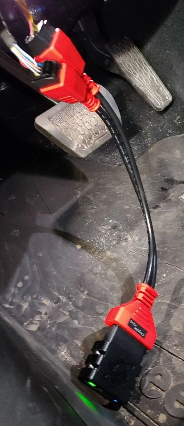

You do not use this cable with taser - this is what I call "the orange cable" even though mine is black and only the ends are orange.
It connects to the factory cables, not to the extension cables, and it is only ever used with an OBS adapter and JSCAN or AlfaOBD. My OBD bluetooth adapter is shown laying on the floor in this old pic -

Well shite, i have it all hosed up. This wasnt explained by Z-Auto when i bought this crap. No wonder its messed up. Awrighty then...back out in the cold. Thanks for getting me sorted out.
Well, that info is right in the description of the extension cable when you buy it. Guess they figured that was explanation enough?
