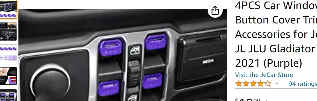

What about purchasing something like this and then adhering a piece of abs rod to create a joystick adding leverage?
SQQP Window Switch Button Cover Trim Interior Accessories for 2018-2021 Jeep Wrangler JL JLU & Gladiator JT(Purple) https://a.co/d/bSZ9yZ4

That would go over like a lead balloon, not to mention - wonder what the wiring inside that switch panel is like.......... since it's a lot of wires in there.

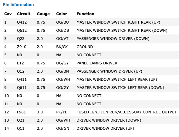

This is the back of the panel and in the middle is the window lock knob.
Pretty sure this is your wiring

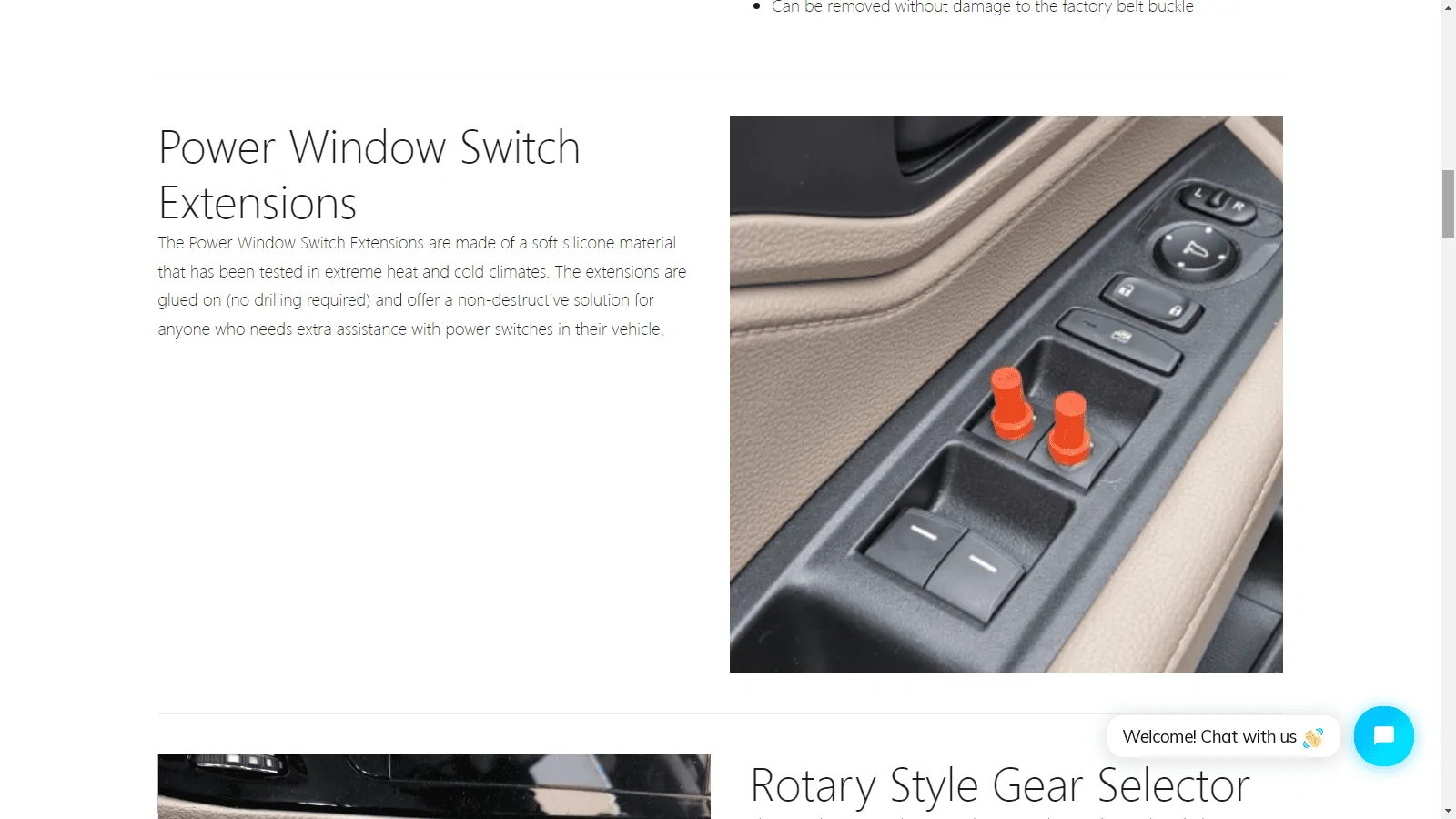

From that thread:
https://www.mobilityinnovations.com/products/driving-aids/extension-controls/
Jeep Gladiator Replacement window switches - that are DIFFERENT ?? 1681321635646

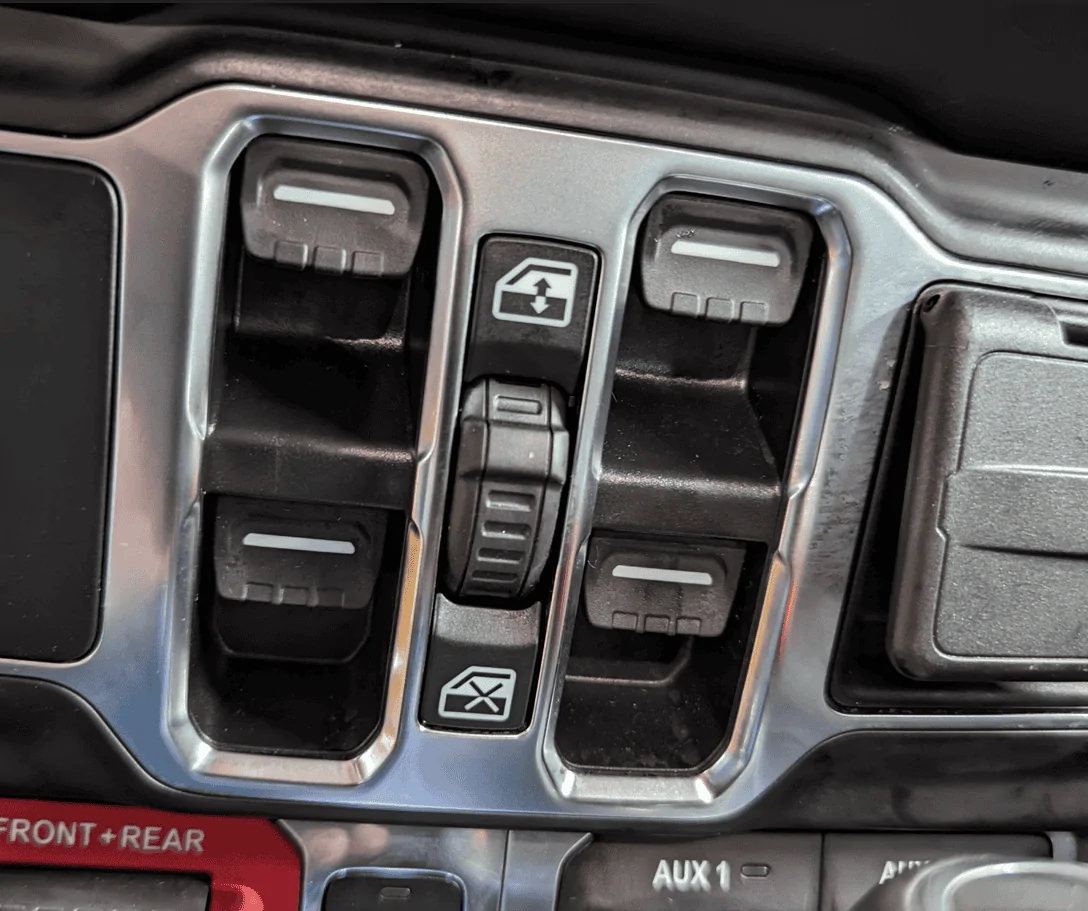

It would seem the first thing to try is an extension on the switches. That's the least intrusive and destructive.
I contacted Jeep Junkie about the set of switches and the last few inches of the dash harness leading to the switches. Holy CRAP! I can buy NEW MOPAR switches and the whole harness for what they want! $350 bucks. You gotta be kidding!!!!
I can get something on eBay for under 100 (free shipping) and new switches for 129.
Maybe they misunderstood and think I want the whole set of power windows and all wiring and hardware!??!
I could almost get 3 new switch sets from Benny for that price.
I have a set of these coming later today - to see how easy it might be to extend the switches because they are made to fit over them ->
Jeep Gladiator Replacement window switches - that are DIFFERENT ?? 1681323243631
250
40,609
54,303
The JL Switch box has four ears, almost looks like you could flush mount it. What about making a wiring extension and sink it into the cover under the steering wheel on the left side? Or even under the headlight switch. Maybe there's room above the dash speaker? Cut a square big enough for the face to pass through. And then buy the jeep cubby to go where the window switches are now.

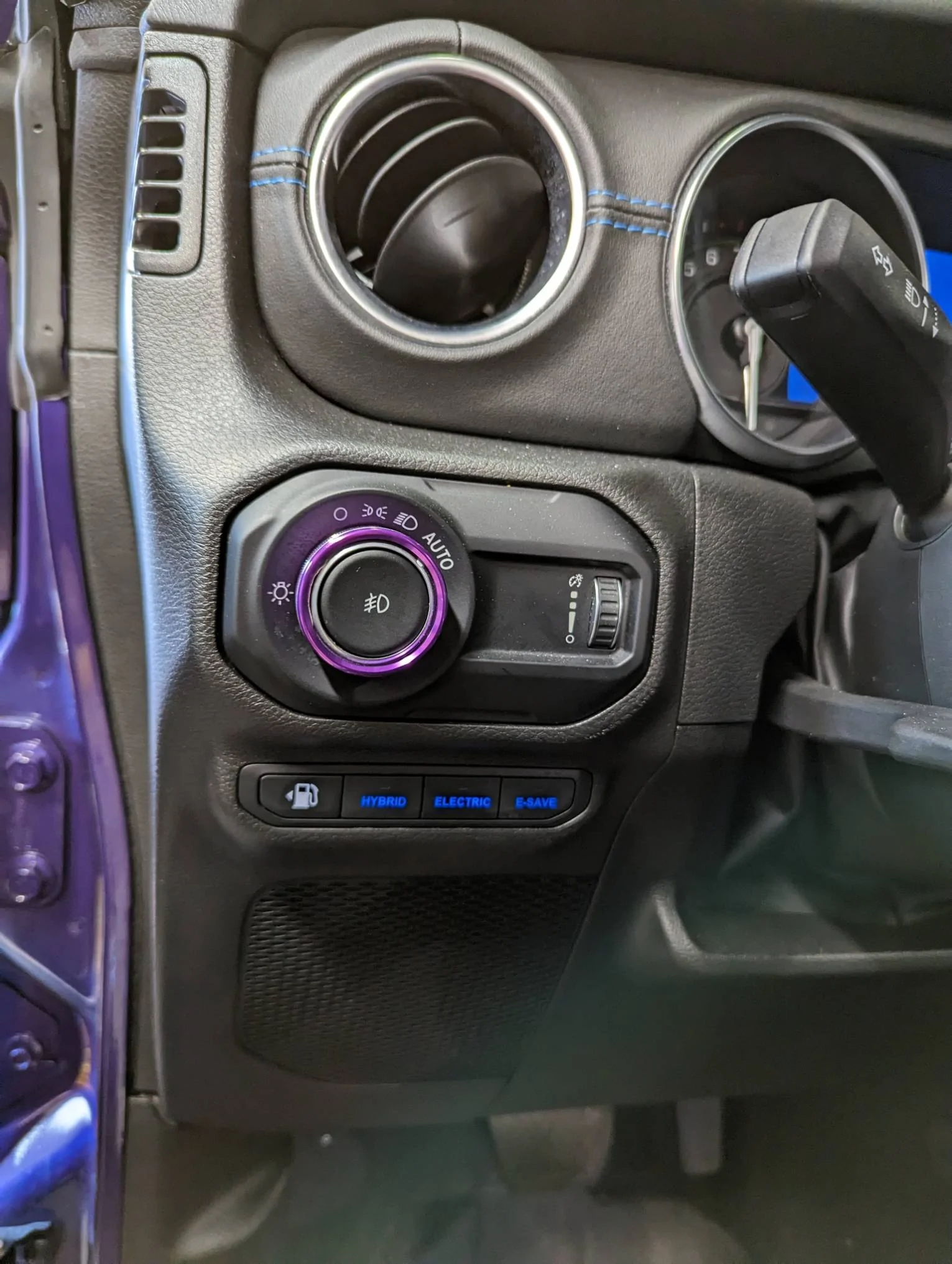

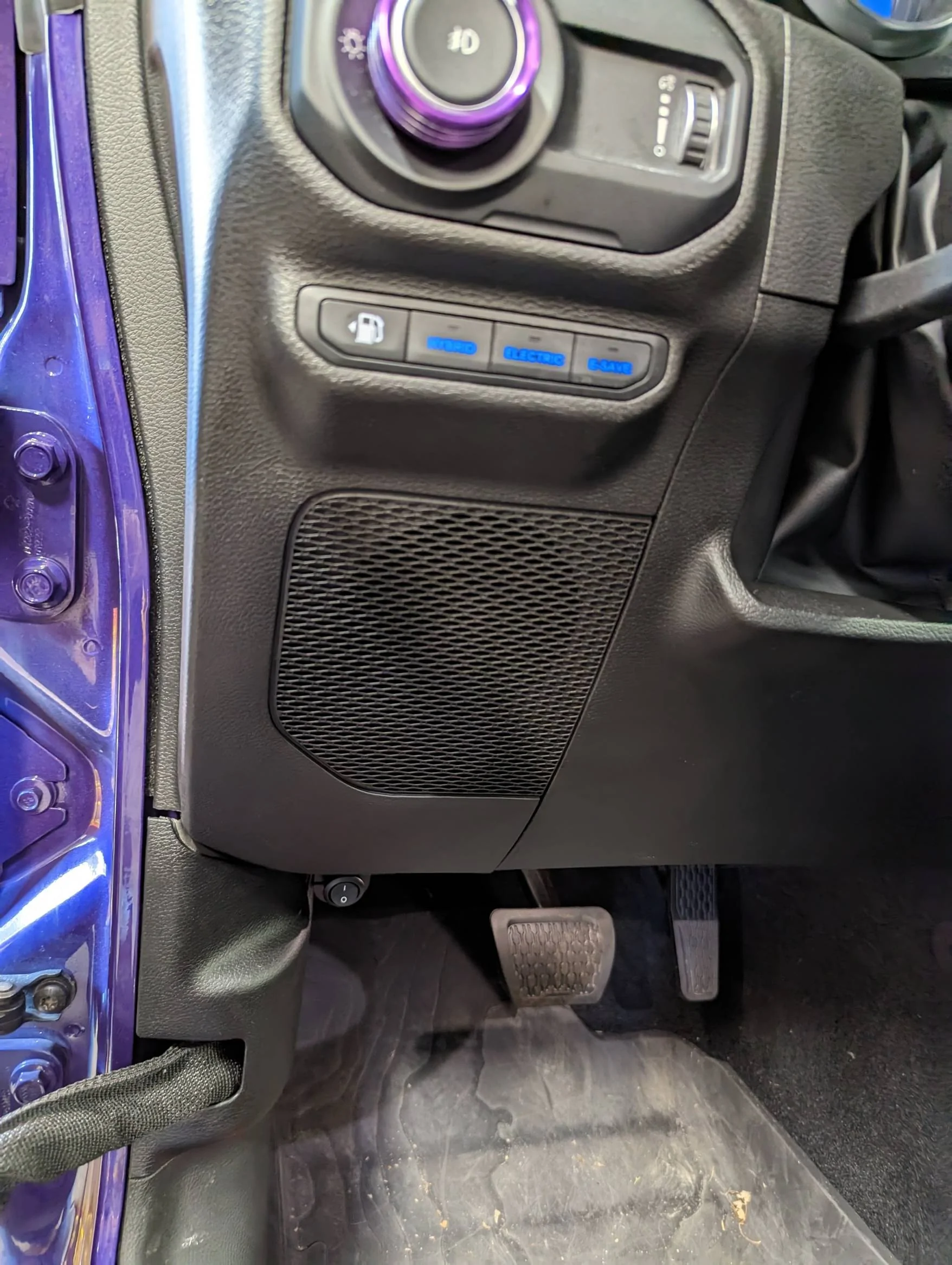

There's no room on the dash around the steering column at all. The speaker is down low and below that is cheap weak plastic. Nothing substantial, and no room.
There's just plain no place on the left side at all - you have the speaker, the light switches, then the HVAC duct and above that you are up on top of the dash where there's no real estate unless you want to loosen the seat belt and lean forward.
It's not possible to relocate to a more convenient place on the dash. It's packed.
And the most embarrassing bit is - after 34 years........
I went in and said ok, the one touch up works now, so you can push the button as usual to get the windows down but don't have to hold the button up to get them to completely close.
She asked - so I don't have to pull on the switches? I can just push?
No, the buttons are the same, you still have to pull out to make it go up, just that you only have to pull and release and they keep going up.
Then she showed me something that if I knew, I never gave it a thought.
She showed me that she doesn't have the ability to turn her hands, especially her right hand, "palm up".
Her right arm has no working elbow and the bones are such her arm can't twist around and show palms up
So she can't even TURN her hand to get under the button to get a finger under it to pull.
So I asked - how have you been doing the windows on my truck and with this new Wrangler?
She hasn't. And the times she goes to a drive-up window like for fast food or a bank, she has to pull aside, put the thing in park, lean way over and half laying, reach the button to pull up on it.
No wonder I have never seen her roll the windows down or up while driving. She can't!
She's been pulling over, stopping, leaning over across the console and doing it that way.
So back to the drawing board.
They are auto-up now but that still does little good.
The buttons will absolutely have to be replaced with ROCKERS that she can PUSH for up and PUSH for down. LIFT will not work as she can't turn her hand "palm up".
Embarrassing - I'd never paid attention before. Here she does all of this quilting, sewing, cross stitch, rug making, you name it, and can't even turn her arms palm-up.
So this means - the switches MUST be replaced - ROCKERS.
Push on the top to get the window up
Push on the bottom to get the window down.
I guess it's time to pull out all the stops and see if I can't hire some outfit to make a set of custom switches for these Jeeps.

12 wires, a couple of them are probably 12gauge or so.
