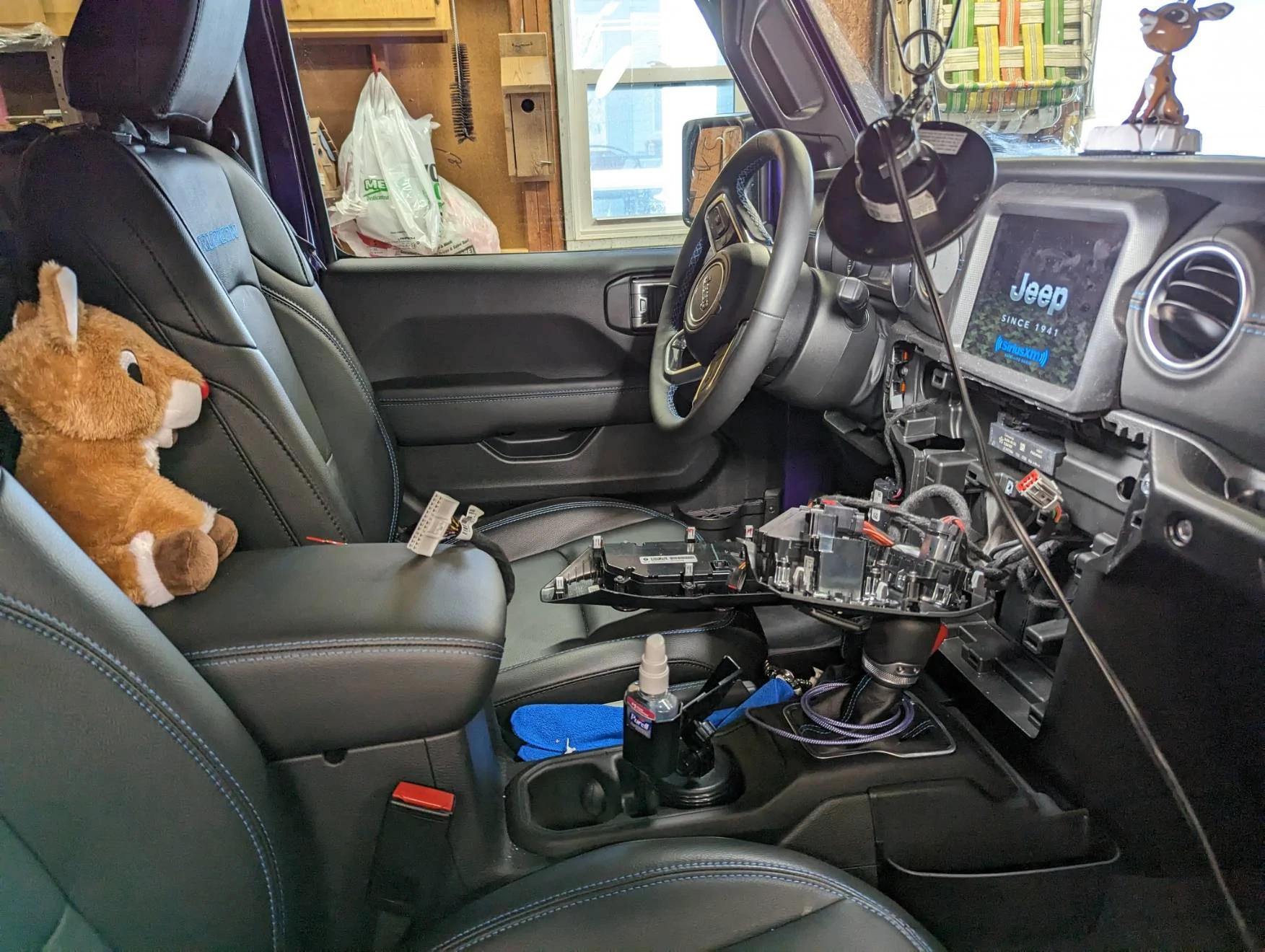

I went back to her JLU 4xe, removed the fob, opened hood, disconnected battery stuff, reconnected, closed hood (after triple checking the hood switches), pressed brake pedal, pressed big round button. Vehicle gave the green "ready' and I could tell it was powered up. I put it in D and moved forward a couple of feet. Yeah, it moved!
Reverse, moved it back where it was. Again, no errors.
So it was able to be put in ready mode and "driven", contrary to the hood open message.
I plugged in the level 1 charger again and it started charging normally (which it should not have needed since it was only unplugged for 24 hours and sat 3 or 4 days plugged in prior to that - it should have been at 100%)
At any rate, I now no longer see the hood open message and it seems normal.
Whatever happened during install resetting things and starting it (putting in ready mode, engine never started) seems to have clearned things up.
Still spooked, but hoping. She really needs the power up part as well as the switch mods.
Anyway, will think and see about ideals later now that that bit is over (at least for now - hope forever)

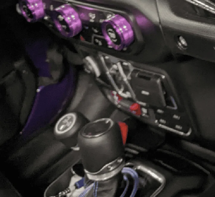

Just curious - thought the auto up module you added had a fob function to activate windows… or maybe it was something else I was thinking of. Not that it matters since it seems to be giving you problems anyway.
another thought I had - you mentioned getting those purple switch covers -
hot glue makes a good temporary connection - i think you see them using it for that paintless dent removal. With the switch cover on, you could hot glue on various extensions to experiment to see what works the best before building a permanent solution without damaging the rubber switch pieces. An alternative might be whatever it is women use for attaching those fake fingernails. I have no experience with it so do not know how strong it is but assume it is not permanent.
The switches themselves offer very little room for modifying to add on - a ’fake fingernail’ of sorts might allow the extra area you need to attach a toggle extension.
I have the 6 sp so there is limited room between the shifter and the dash. Not sure how that varies on the 4xe, but it seems like just a longer switch by maybe an inch or so would allow the extra leverage to operate with just the back of the hand or a knuckle- if there is room.
I don’t quite know exactly how your wife’s disability limits the switch operation, but wondered if a ‘T’ extension would allow her to grip between the fingers (palm down) to pull up. I seem to find it easier for myself to operate the switches palm up so I can see how difficult it would be if I couldn’t rotate my hand to palm up.
for my last off the deep end idea - pull the switch module out of the dash, replace with a cover plate - they must have a mopar part number for the roll up windows - and mount the switch module on a flexible stalk out of that cover plate with extended wires so it can be placed in a more convenient place.
these are all just wild and crazy ideas that hopefully help you find a viable solution.

That part, at least, is the same as the Gladiator (automatic JT, that is). When in park, there's very little space between shifter and switches. That limits things as she's got to reach over with her left hand, and use both hands to push the button and pull the shifter back into reverse or drive. So it's not like you or I reaching in with our right hand, there's plenty of space for us. I've got to watch how far anything sticks out on the switches or she'd not get her hands in there to shift into gear without hitting a window switch.
Jeep Gladiator Replacement window switches - that are DIFFERENT ?? PXL_20230412_154233629
Not a ton of space there when in park..........but the switches may be just high enough and just far enough away from the shifter to make something work.
If you've seen a JT with automatic, you've seen this part of a 4xe Wrangler as well. That bit is the same (thankfully)
you’ve got a scosh more room on the 4xe - I believe the manual shifter is taller. it physically blocks the switches from being operated straight on. Hopefully it will be a simpler fix If you only need to modify the drivers window switch it.
I think you’ve summed up the basics for what I hope to design, an outward extension that can easily be toggle up or down, similar to a t shape, though with the orientation of the buttons it might end up looking more like a L on its back.
What I am honestly hoping is that I can disassemble a unit and create a whole new replaceable switch by creating a mold off of the original. That way there won’t be a worry of glue or rubber failing from use.
