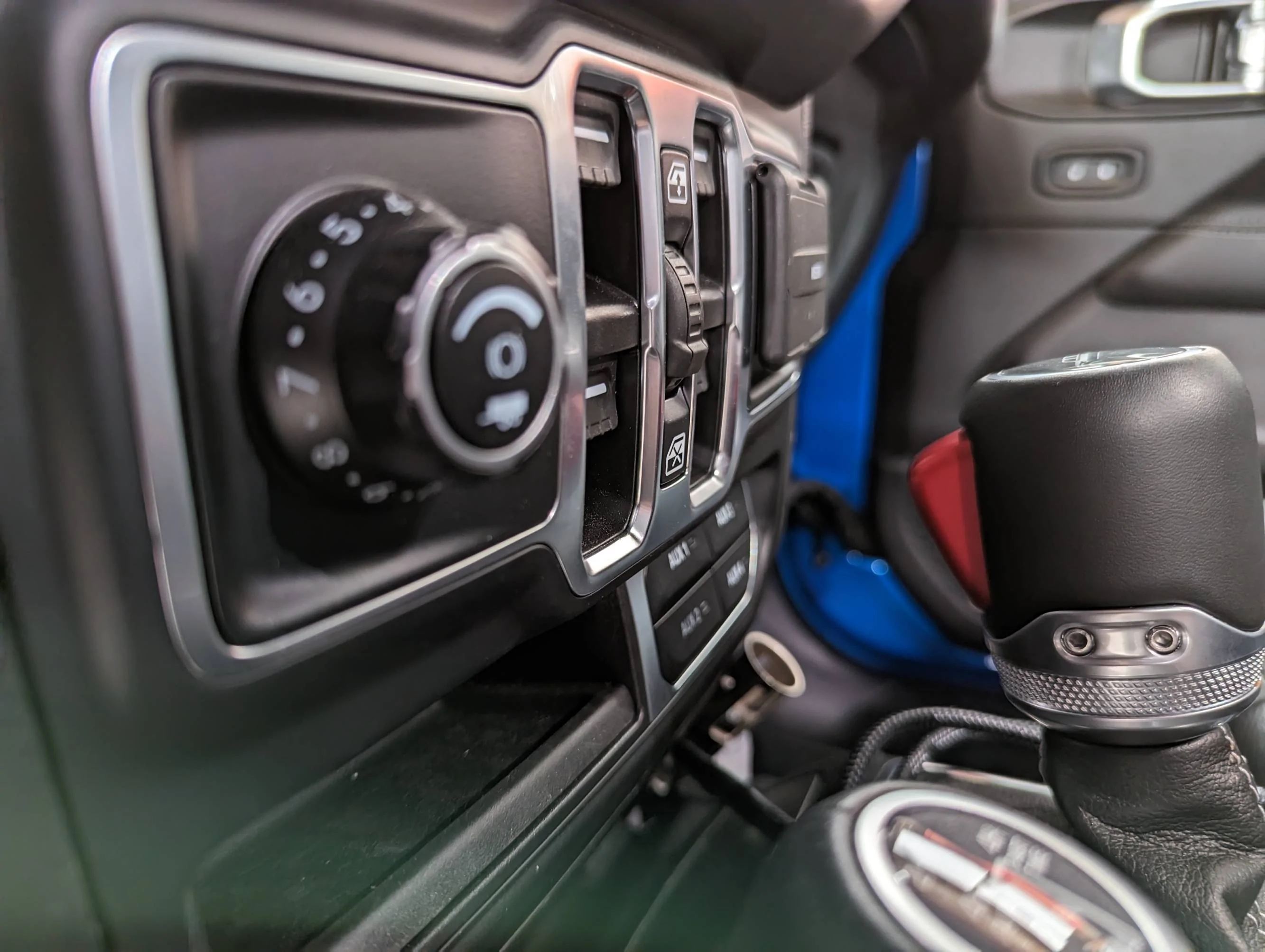

you’ve got a scosh more room on the 4xe - I believe the manual shifter is taller. it physically blocks the switches from being operated straight on. Hopefully it will be a simpler fix If you only need to modify the drivers window switch it.
Yeah, from the perspective of the photos, I believe the switches are a bit higher compared to the top of the auto shifter vs. compared to the top of the stick shifter. So it may be easier with an automatic. And once the automatic is put in drive, there's a ton of room. It's only moving it to or from park, or maybe going into reverse, where it would even be close.
Her license is restricted to an automatic. (I thought there was something about power windows and locks as well but I may be wrong on that.)
The front window switches are in the clear for the most part and the left side switches are a straight line reach (for a person with normal arms) in any case so the most important switches shouldn't be a problem as far as the shifter.
I didn't even drive a manual transmission JT because of my wife's restriction and because of towing so I can't say I know how close those would be, but the automatic shifter is short and not really in the way.

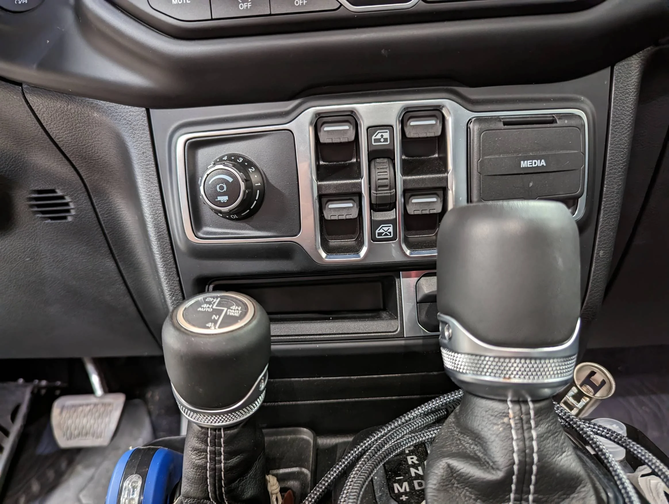

The only real issues at this point are the window switches - which I also hate and believe are way too stiff and clumsy to operate.
I will give it to you that the window switches have a little more tension to operate that I am use to, but the thought of it being an issue that needs to be fixed never crossed my mind but I see your emotional investment to it is different than mine.

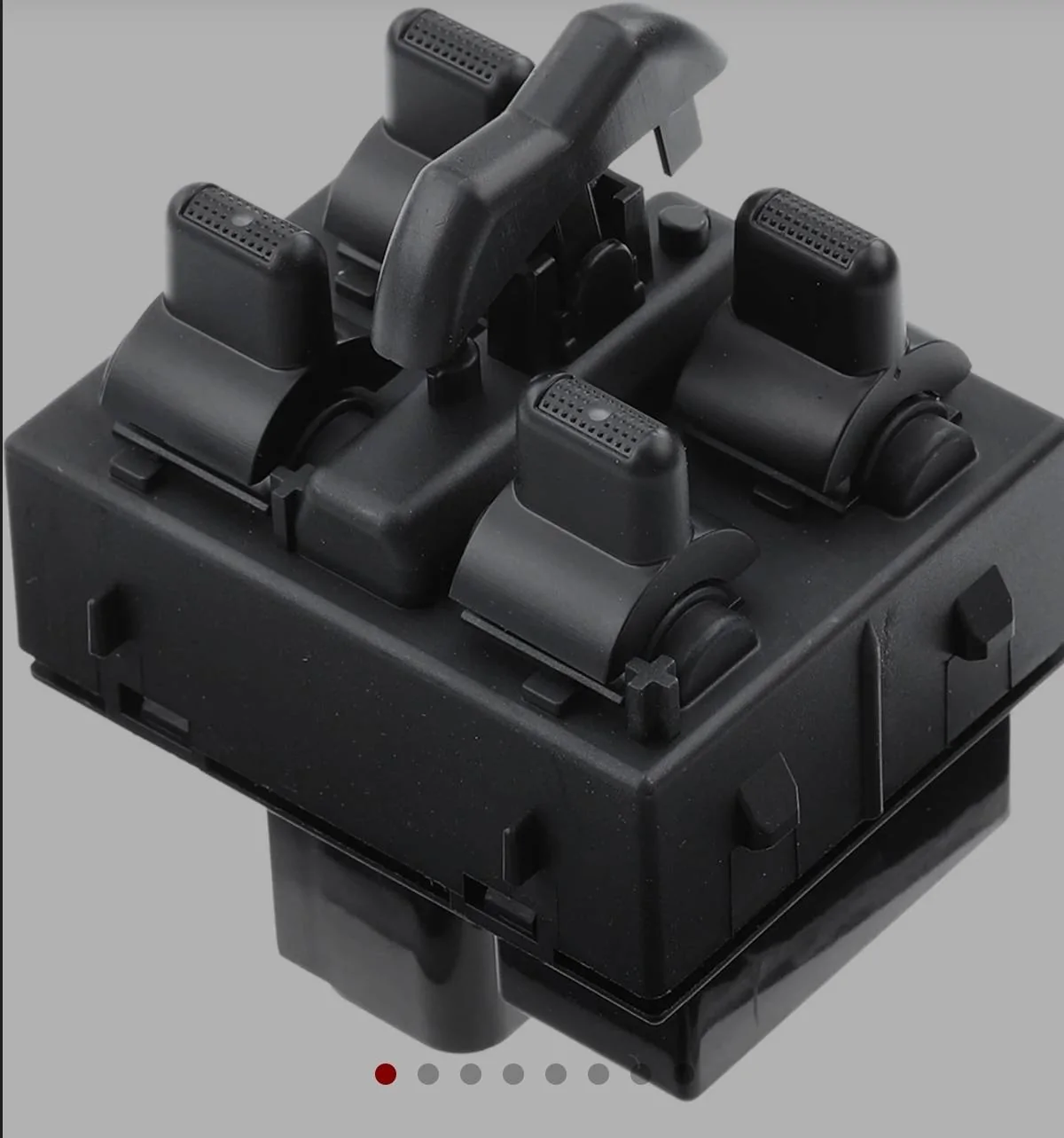

With my wife's handicap, she can't easily reach and pull up on those hard to operate window switches clear in the middle, clear up front, that you have to hook a finger under and pull up to raise the window.
Does anyone make a replacement switch set that is more of a rocker or toggle and not a push/pull switch?
I get the location (sort of) but the type of switch is just dumb if you don't have good working fingers and dexterity.
So looking for a set of switches that replace the originals - do not want simply another set of Jeep switches, that can be operated easily - easy to move, don't have to hook a finger under and pull hard.
(even I hate the switches themselves - could be a lot easier to operate, take less pressure, softer switches, rockers. )
If not, I may have to drill into these and put some sort of thing on them that extends them out more like a toggle switch with some LEVERAGE.
Would something like this work?
https://a-premium.com/product/Front...uZ9LAY6sK4t9xEcF30qX3gx_nPnBH_NkaAu-qEALw_wcB
Been loooking at different sites to see if anyone makes the switch panel for JL/JT but coming up short.
Good question. I've been looking to see if there was an "after-market" power window kit for the JT or JL thinking they'd likely have their own switches (cheaper for them to make and supply than buying or supplying OEM MOPAR switches).
Nothing. I was thinking if there was a power window conversion kit, say, for a basic Sport JT - maybe the switches would be lighter and easier. But so far, nothing.
I have also wondered about the JK switches - I could swear someone said they were easier to push, didn't have a stiff spring but I can't recall the switches on a JK, my Jeep driving and repair experiences predates the JK by quite a bit so other than my brother's - and I didn't ride in or drive it - I can't say I know what those switches are like.
But pictures, and assuming they may be lighter, I wondered.

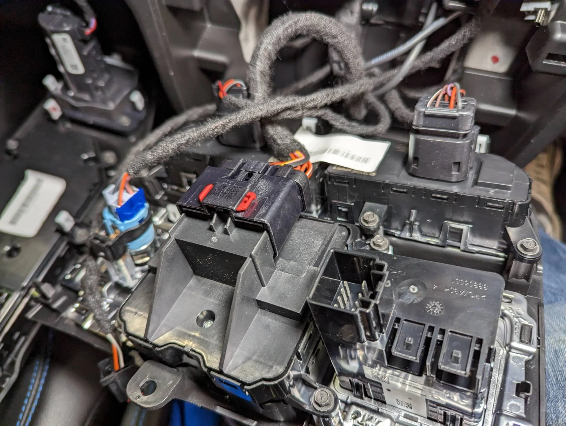

The only thing may be the depth. I've not seen the back side. The JT and JL have very little space behind the switch array. The connector on the back points down. The wiring harness goes into it from the bottom up, not directly into it from the back.
In fact by the time you shove the 3W harness in back there, there's no room left for air.
(switch panel tilted down. The big harness goes into the switches from the bottom.
Blue is the 12v outlet)

I also question the switch operation - since I do not personally know how the JK switches work.
The JT and JL switches have 4 positions.
  • Center or neutral, off, not operating the windows (at rest position)
  • Pull out/up to raise the window.
  • Push in to first detent only to lower window until you let go
  • Push in to second detent to engage auto-down mode, window keeps going down until it stops.
So if the JK didn't have auto-down front windows, it won't accommodate that function of the JT/JL
If the JK did have auto-down front windows, then all a person has to do is figure the pin-out of the JK compared to the JL/JT and make an adapter.
If it didn't, that lets that out - bummer.
Since I honestly don't know the JK well at all - I can't comment on that or answer those questions about the JK switches.
But - that style would in their native form be easier to operate, and even easier to modify to a rocker type situation instead of their present toggle design.
Executive summary - I don't know the JK, can't say how they'd work in a JL or JT. I don't know if the JK had auto-down front windows.
But the appearance alone would seem to make them easier to use or modify.
