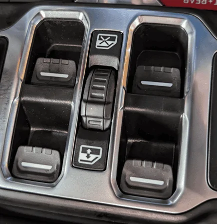

As I understand it, she can't reach under the switch and pull because she would have to twist her wrist to reach under the switch. This may sound like a crazy idea, but you can decide whether or not to look into it. How about pulling the switch bank out and remounting it upside down. This would fit in the stock opening, no wiring modifications needed, cost nothing but the time to do it. This would allow the switches to be pulled as needed without reaching under them, and they could still be pushed to lower the window. The downside to this is a short learning curve to remember that the lower right switch is now the driver's window switch instead of the upper left switch. Just an idea, maybe it helps. Good luck with the switch project.

A couple of thoughts on how to approach this.
1) I am guessing that she only cares about the front driver's side window switch and that modifying all 4 in the current location might actually be more difficult for her to use than just modifying the front driver.
2) I am also not positive about how far to extend the switch horizontally to be ideal for her (both from a dexterity and from a leverage perspective). If you already have a good idea, then skip this, but you might want to drill a small hole in the middle of the light strip and then try a series of different length screws to see what she likes/prefers
3) Her preference for length will drive the best method of doing this, but one generalizable method that I like is whatever you want to extend the switch with should ideally be plastic. Then glue it in place (taking note of the rubberized issue with the switches that you noted above). Let the glue cure. Then heat 2 brads with a torch while holding them with small vise-grips and insert them through the extension and the switch. Then trim with a dremel and paint.
Things that you could use to extend the switch that I can think of or have used myself in the past: trim the business end off of an existing switch (or cannibalize your current one) ... or insert the brads or leave the screw from above and use one of the puddy type epoxies and form it roughly as desired and then fine-tune with a dremel and/or files ... add paint or a rubberized coating
There are a million ways to attack this ... hope this helps

It might be possible, if the switches operate the same in all the different positions (that is, do they all have the same detents for the factory one touch express down or is that only on the switches for the front windows). I have never actually paid attention to it, but it is usually good to have things where the factory put them.

Also a thought. Maybe simply moving left wire to right and right to left. Front two windows are now on the bottom with auto down, but they're at least on the correct side. I don't think it even cares about the ground wire, the ground is likely common. So possibly just a matter of repinning four wires.
40,499
54,017
Still stuck with the stiff switches with a short handle, just up-side-down.
Since the motion to lower or raise would be counter-intuitive, it would mean repinning of connectors.
The switches angle will mean more of an up-push than a natural straight or down push (since the switches are below the hand)
Looking at the example below, they'd each be moved down lower when turned around. They are each at the top of their space when in the stock position, they'd be at the bottom of their space if flipped.
If a person is going to go to the effort of remounting and rearranging the switches and them repinning the connector, it doesn't make much sense to me to keep the same switches, only up-side-down.

You could curve a finger in above each switch and pull down, but you'd need to reach down further and push upward in this situation. And you've moved each one down about 1", further away. You would absolutely need to use screws or pins to extend the switch handles outward.
The more I think of it, the more I'm going to see if I can find and hire someone to put rocker switches in one of these switch arrays.

I seem to remember JK switches being far less pressure to operate. I'm sure you'd have to fabricate something to bolt these in, I don't know if this box is bigger or smaller then ours, and probably re-pin the connector or get a pigtail, but...for 30 bux...maybe worth a look? Maybe even cheaper if you have a pick-a-part yard near you.

Pulling downward would be ok up-side-down - still hard to pull, especially being an inch or so farther away from the driver, but then the other direction would be harder, trying to push with upward force which she doesn't have. So it's trading one problem for another.
I'd have to check to see if you can even plug the connector into the switch assembly on the top vs. the bottom like they are stock.
After seeing things in this thread and watching her try to operate the switches, I can't see doing anything other than replacing them.
So, I'm looking for SPDT momentary rocker switches, fairly shallow if possible and someone to hire to make the change to a used switch array.

It would seem the first thing to try is an extension on the switches. That's the least intrusive and destructive.

I have a set of these coming later today - to see how easy it might be to extend the switches because they are made to fit over them ->
Those don't extend $&!# They are super thin. Other than color, can't tell they are there by feel.
Still, after seeing my wife try to operate the switches last night, there's nothing that can be done in the way of extending them out that will help.
It's just plain the act of lifting.
If they were push top to roll up, push bottom to roll down, like rocker switches mounted vertically in place of these, it would be fine. A push is fine - push in or push down works.
Lift motion not possible.
Pretend your arm is several inches shorter and you can't twist it out of the palm down orientation - it's impossible for you to turn your arm fingers or palm pointing up. No elbow, can't rotate arm, fingers down or to the left only.
Now try to operate the switches. Push or poke motion is fine. Lifting not possible.

The other monkey wrench - the window switches - I didn't really pay attention or realize - they are not simple SPDT NO (NO = Normally Open) momentary switches so I can't simply replace them with other switches.
They have 4 positions.
Neutral or center (off)
Up for window up
Down to first detent
Down to second detent.

A creative genius with design and printing would likely be a better solution than trying to totally rebuild a whole switch array, especially finding that these aren't just up/center/down switches.
If there was a way to design a lever that when pushed, could duplicate the up position.
Down is fine.
She would have to use a knuckle to push up. That's what she does now to push a switch in or down, to push one of the HVAC controls and so on - curl a finger as much as possible, use a knuckle.
Anything that could turn these into more of a rocker type - push for up, push a different part for down.
I doubt we even have a picture of her with her right hand showing. She's always made sure that if there's a camera in use, her right arm is hidden. Weeks before we met years ago, she had a guy she met through either a friend or some mail type thing come to her door. He was all prepped for a date. She opened the door, she said he saw her arms and made some excuse that he had to cancel.
Down is fine.
I've got to see what I can to do get the thing driveable again since the 3w module has it all screwed up, and if I can get it to where it can charge, run and drive, I'll get back to switch ideas. She'll want her Jeep tomorrow - it's 5:30 now so you know what that means, A long late evening to sort out why this stupid module crashes 4xe's.
Ok sounds good, I’ll take what you’ve said so far and see what I can come up with. Working on sourcing a broken window switch right now to scan and convert to an electronic rendering to base it off of. I’ll update here with any progress.
