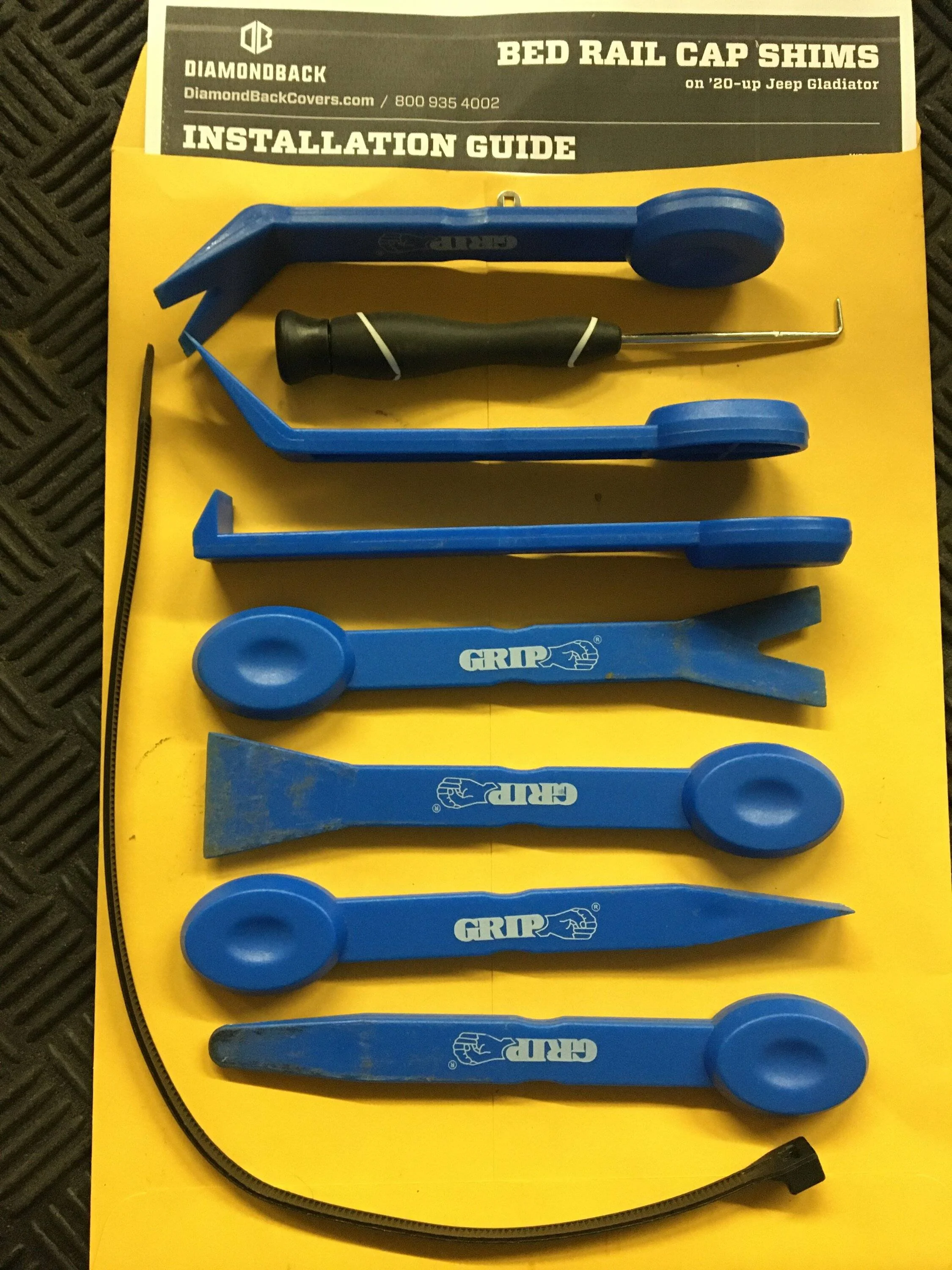

The lever might be the way to go , but it doesn’t have to be permanently attached. Window switches are not something you need to be manipulating like a stick shift. Put the window up or down and it’s going to stay that way for a bit. You just need something that can be an extension for your wife to easily reach the switch and then pull it up or pussh it down. only you and your wife know just how long that needs to be. I’m thinking as an example the panel removal tools that have a hook on one end and a grip handle on the other . Most are not very long but it gets you an idea if the concept will work.

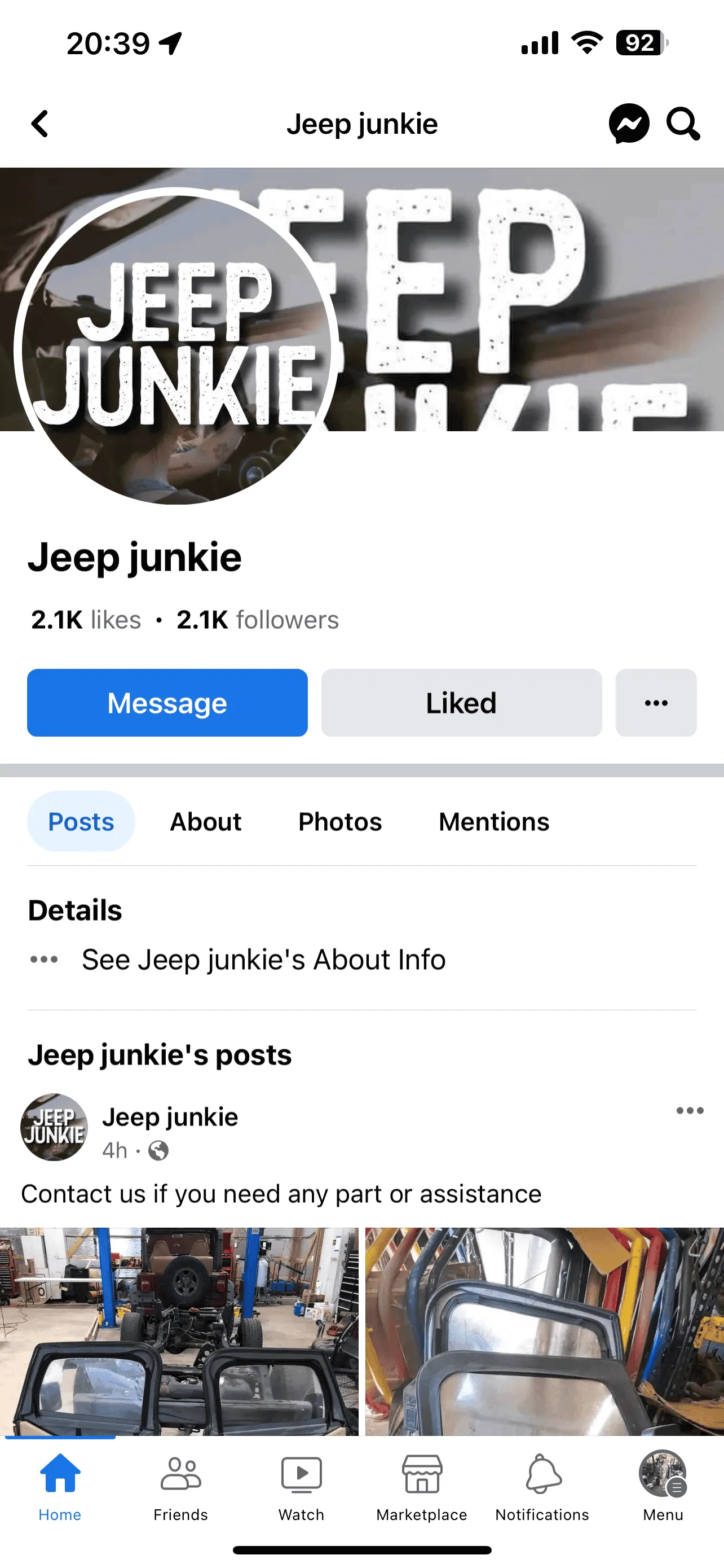

These guys could be a source of cheap parts as well. I see them post daily on trashed jeep stuff. Engines, trans, sensors, axles you name it they have it. Half doors, hard tops, winches bumpers all of it. For cheap too. Im hoping to get a good 4.0 and 6 spd with transfer for my TJ to modify From them.

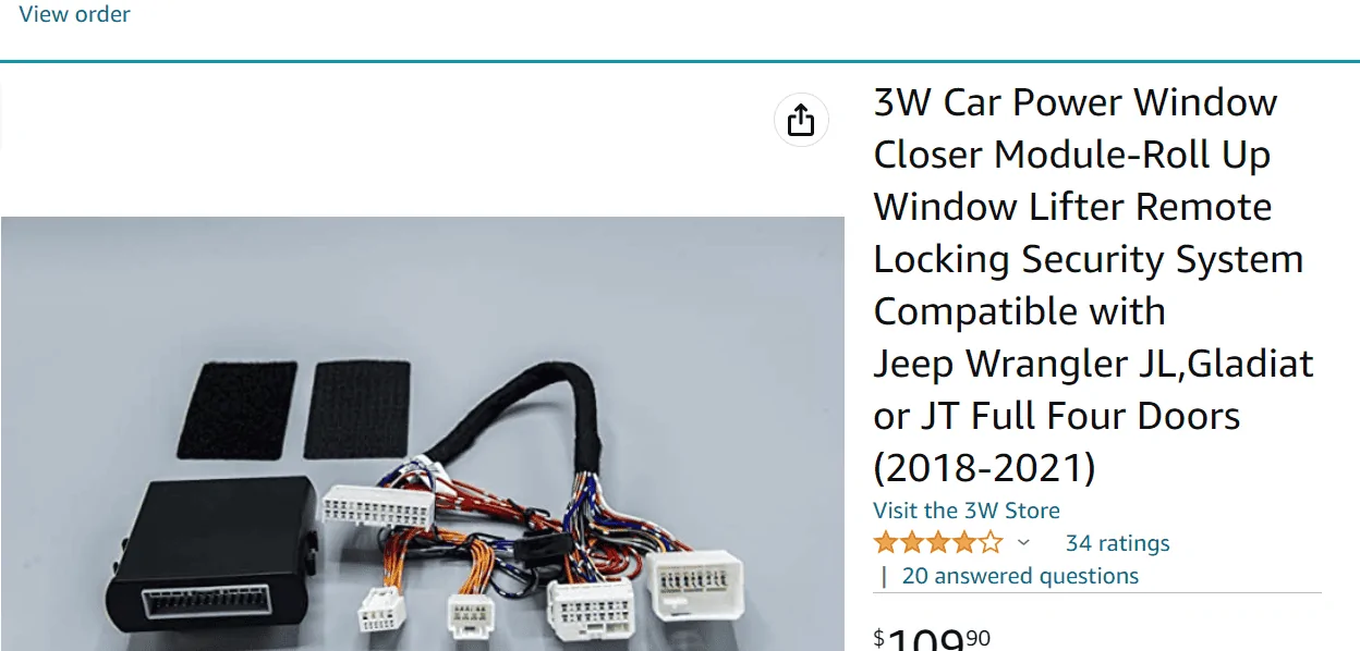

Would something like 3W Liners control module help? May be worth contacting them to see if they could customize functions.
https://3wliners.com/products/jeep-...ll-four-doors-2018-2021-window-control-module
Like said earlier in this thread - I already have that module.

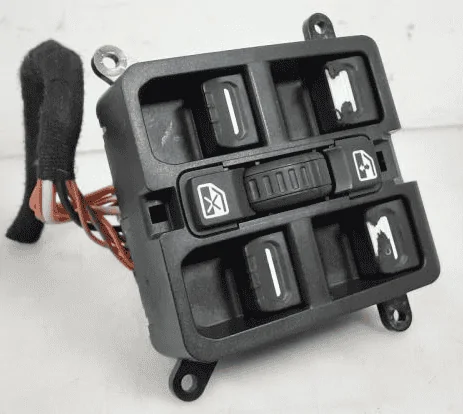

So what I'm looking for is a way to modify the switch - making it a lot easier to "pull" (lifting would be better than pulling - these are a push down or pull up to operate) It's hard to get her fingers under the switch to pull up on it. Strong spring resistance, very short handle or lever on the switch.
So it's the switch itself that needs to be changed out or modified in some way making it a lot easier to operate. At least with the module she won't have to lean clear forward and keep a finger under the switch and hold it up to get a window up.

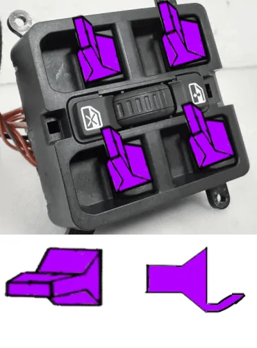

So, like I said, I'm no CAD guy, but this was my idea. 3D print something like this, and attach to the face and bottom of switches with strong 3M double sided tape. Maybe use modeling clay to get the exact shape of the bottom and face so you dont need to buy/sacrifice a junkyard one.

Yes - and do it in purple.
The only "gotchas" may be - (see image below):
The switches are lighted. They are translucent with a black rubbery coating covering all buy a slit for the light.
The rubbery covering peels off, meaning you'd need to ensure however you adhered the new "handles" to the switches hit as much of that surface as possible or it would peel away.
Did some looking at pics of used switches on the internet. Even those from 2 year old Jeeps showed nasty peeling of the black coating on the switch levers.
Your idea has merit, IMO. It appears to do two things I'd look for in replacement switches (like I was originally looking for) -
It extends the lever, giving you more leverage over the high-rate spring in the switch
It moves the motion from push/pull to up/down which should be easier to get a small, weak finger under.

I'm not sure if it's possible (or at least economical) to 3D print in translucent purple. However, it might be possible to mold in or drill out for a small light pipe to transfer the light to the end of the new switch cover if you really need to retain the switch lighting. Or maybe just a small hooded/shrouded led in the dash above the light switch would be just enough light to find them in the dark.
As for the rubberized coating, maybe the best bet if you go this route is just buy a switch panel that is already worn and just peel ALL the rubber coating off, and mount the covers to that. If you trade it in, swap back to the nice barely used original switches.
