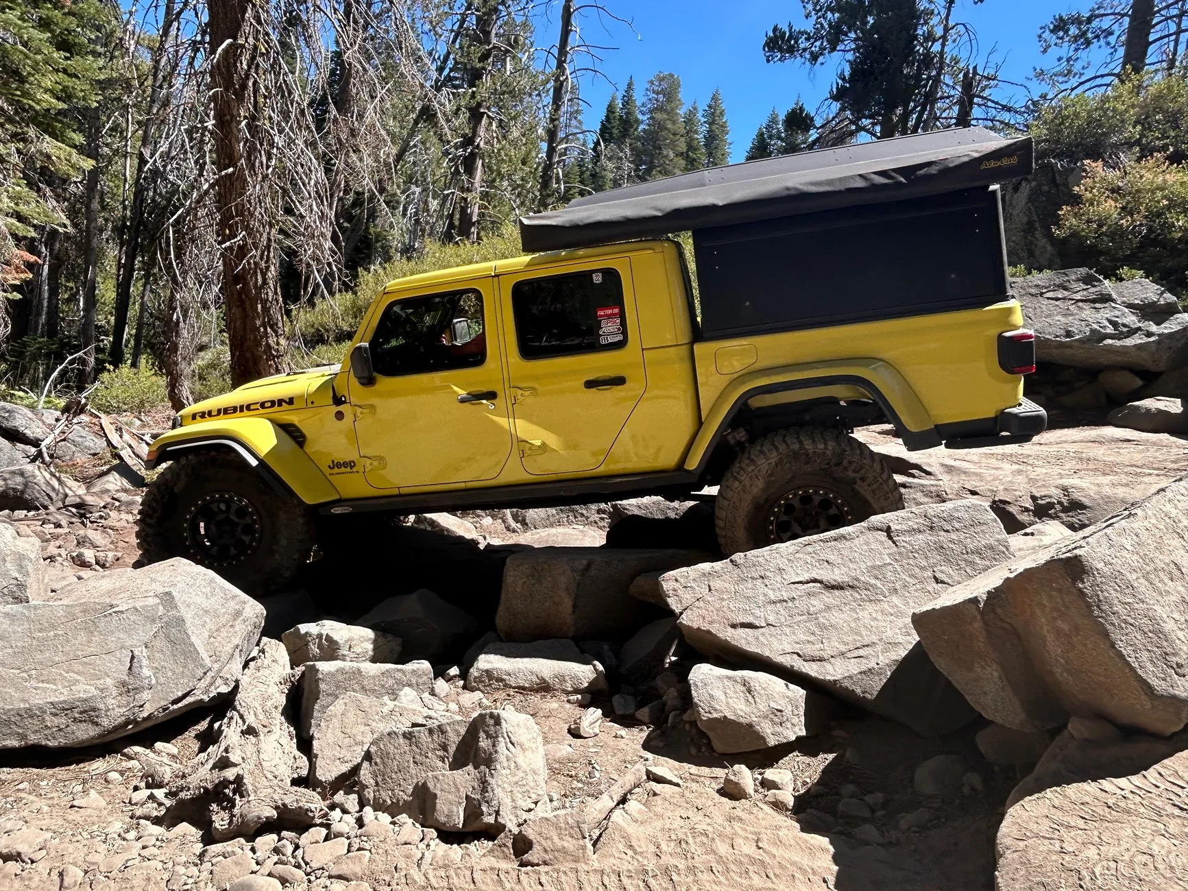

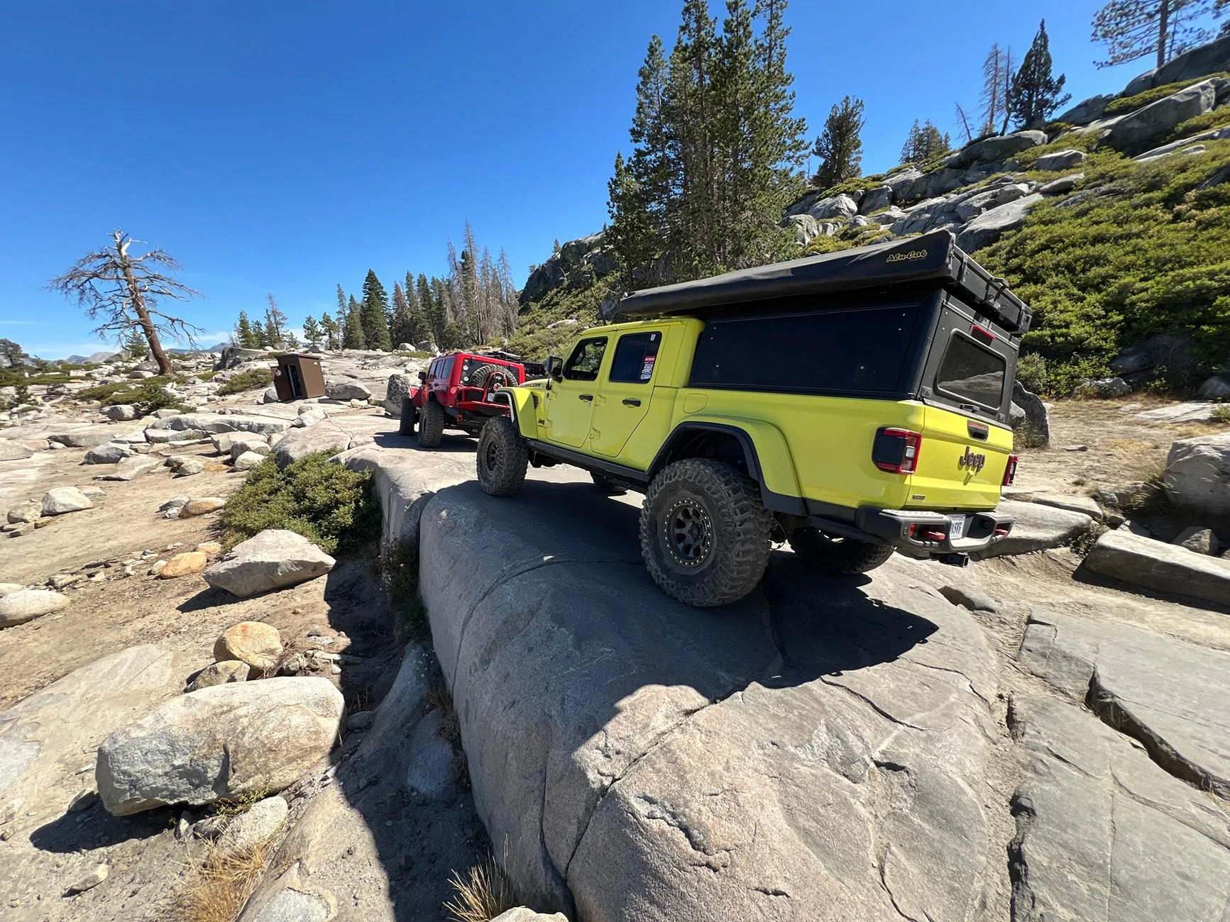

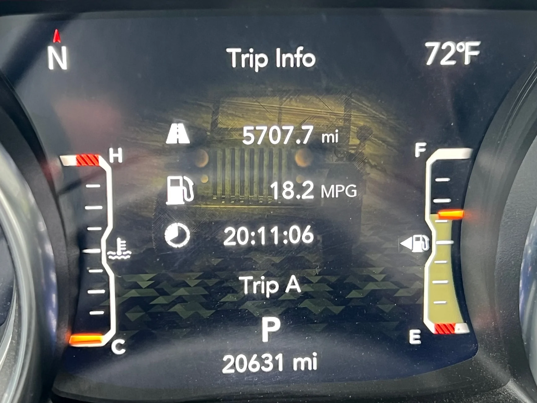

Yes, you can run 40s on stock D44s.
This Is my JTRD daily driver and I offroad on 40s. It’s running 4.56 gears; front axle is trussed, gusseted, RCV, Adam’s driveshaft, 2.5T tierod and drag link, and PSC steering; rear is stock plus Adams driveshaft. I recently drove ~5700miles cross country from VA to hit the Rubicon, Colorado trails, and then back home., averaging ~18.2 mpg per computer.
