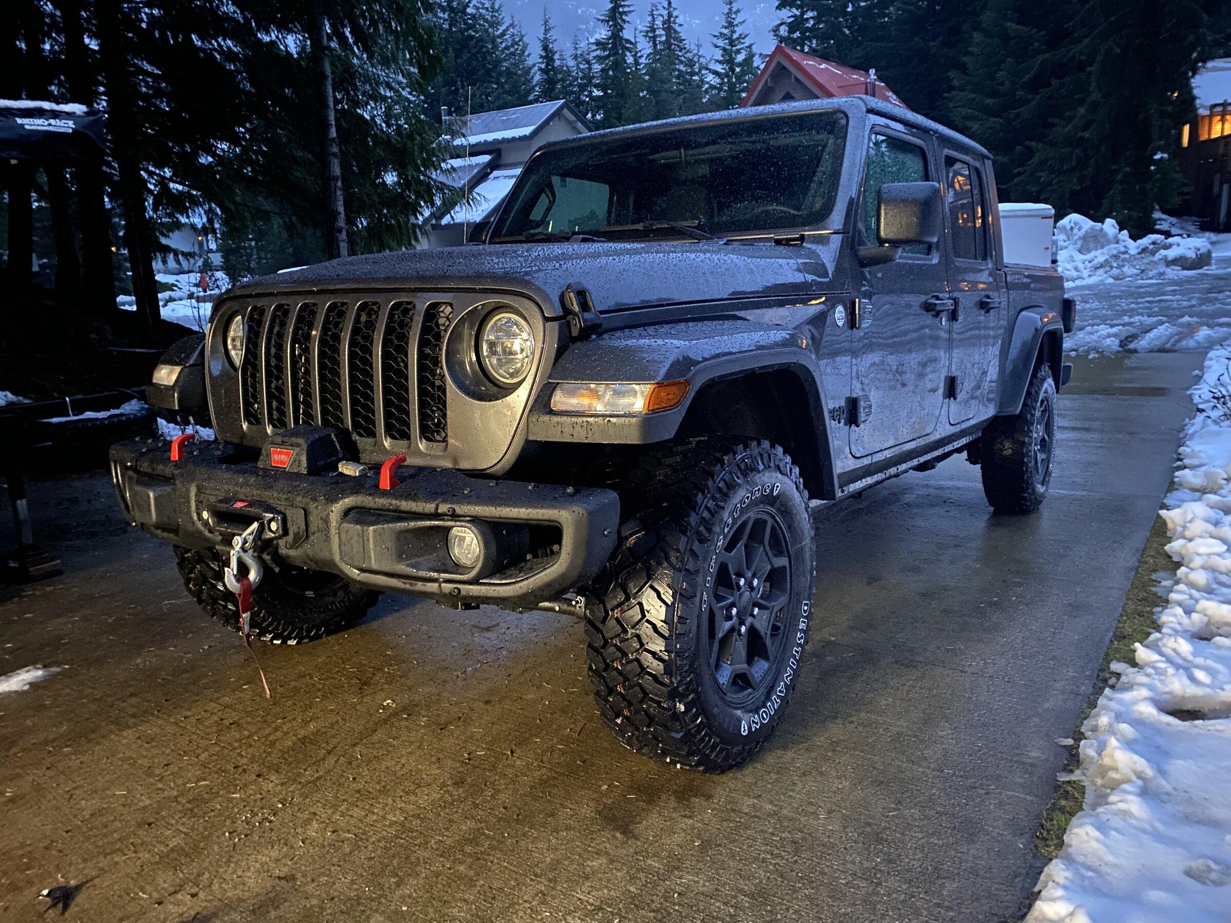

No issues on mine running 255/75/17. Going to 2.5” soon as my bumper/winch dropped my front end .5”. I had about 2.5” on my last and at that point I added control arm drop brackets, felt and drove like stock again.
Jeep Gladiator Ride quality with Teraflex leveling kit? 78BFC9E7-E830-4C85-ACE2-805563C27474
