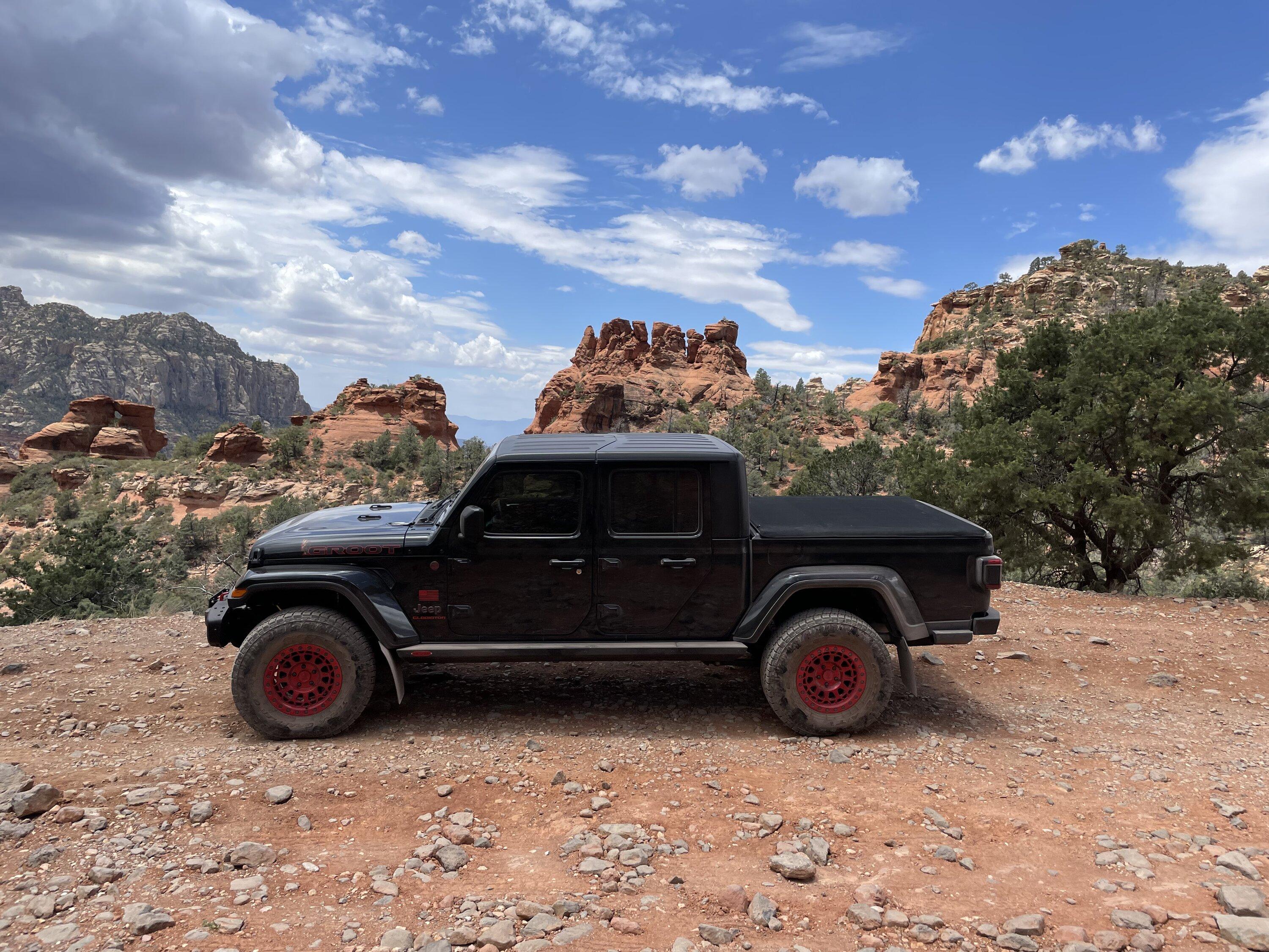

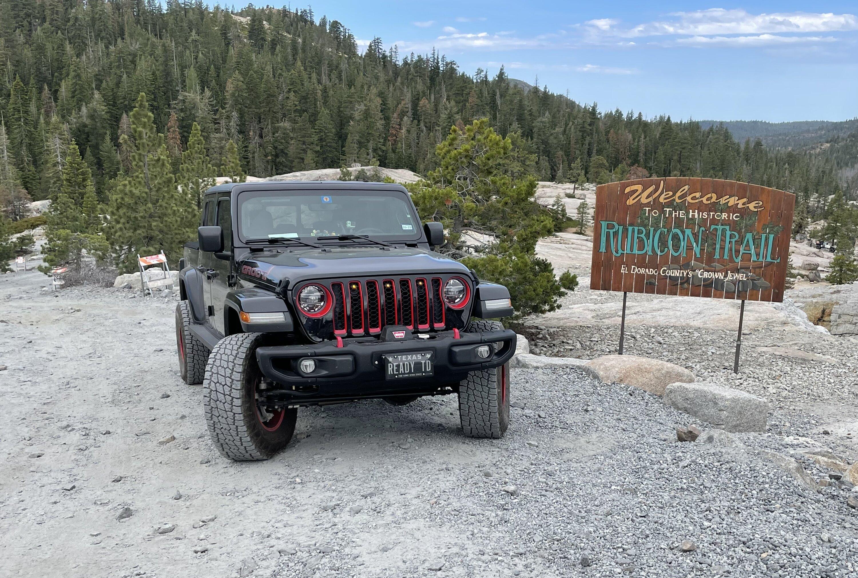

Lower the air pressure in your tires. It makes a big difference. I have an Overland with a Mopar 2" lift and 35" Nittos and set them at 32 lbs cold because they will increase4-8 lbs on long trips in the summer. In cold weather I set them at 35. On my stock 18" Overland wheels and tires, I did the same.
Just finished a trek to the Rubicon, plus 4 BOH trails, and back, to DFW over two weeks and 4080 miles and it rode fantastic!
