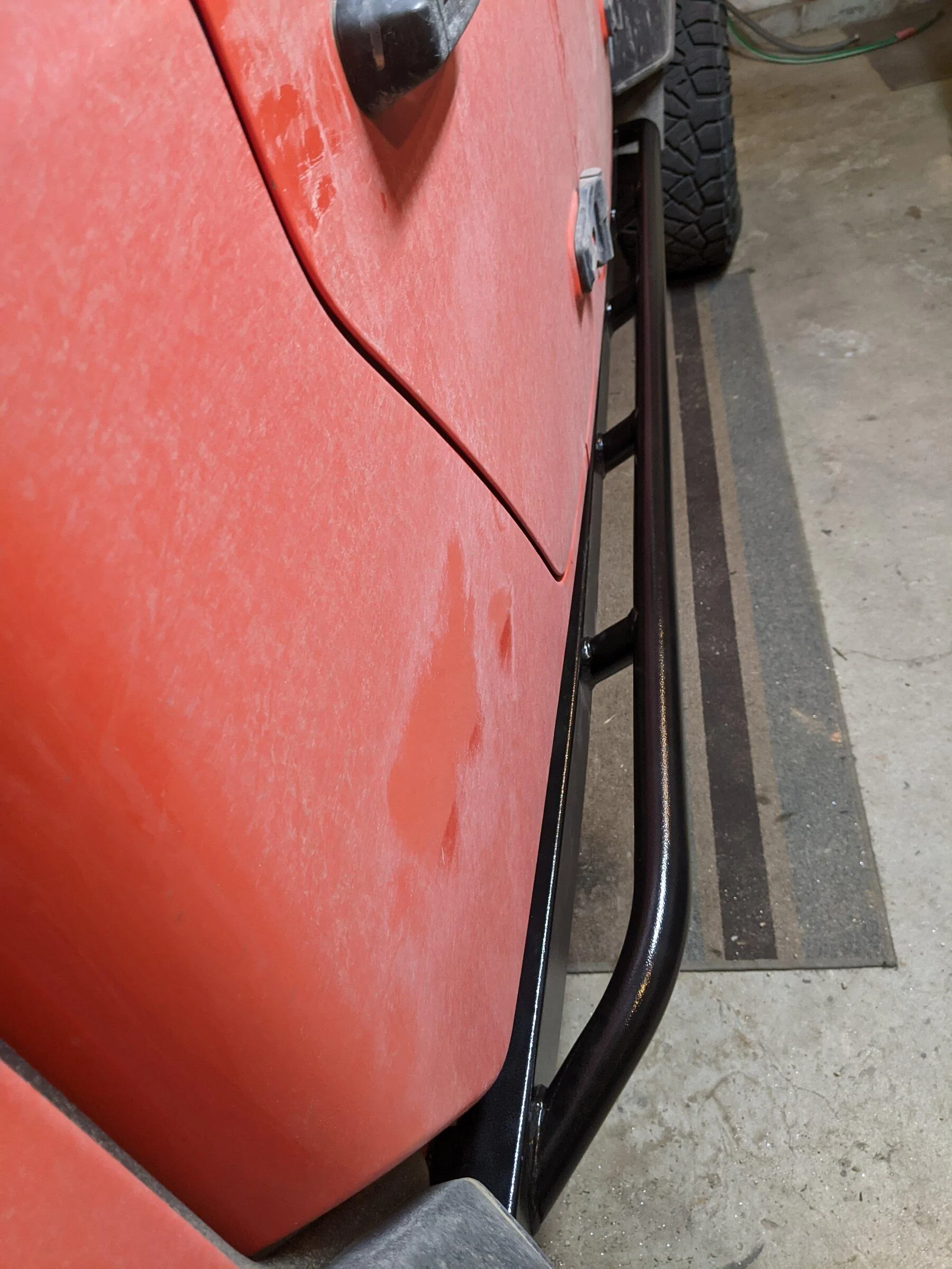

Got mine installed today and they are well worth the $700. The fit and finish is excellent and the heft of these is undeniable. 3/16 and 1/4" steel mounting brackets with 3 body mount bolts, 4 tub bolts, 8 pinch weld bolts per side. These things are going no where. Removing the factory body mount bolts was easier than I figured it would be with horror stories of broken bolts. I used a 1/2" breaker bar with slow and steady pressure and had no problems other than the occasional loud SQUEEK from metal on metal as the factory bolt loosened. All came out pretty easy. The manufacturer install video on youtube is spot on. I watched it several times before I did the install and it went just as shown and expected. I did have to use a step drill on several of the pinch weld holes to get them to align. I touched up the raw metal with Rustoleum primer enamel to prevent ant corrosion down the road. The primer isnt visible once the rail is installed. Glad I changed my mind and went with the angled version. They work perfectly as a nice step into and out of the jeep. The wife even heartily approved.
My only question was why the kit came with 2 additional body mount bolts and washers? The JT has 3 per side, same as the JLU yet the packing list shows a total of 8 bolts and washers included. Weird. Sometimes a vendor will throw in a extra nut or screw in case one gets lost but these bolts are like 4" long and 1/2" diameter. You would be hard pressed to lose one. <shrug>.
Pics to follow

Go slow with a long breaker bar. Loosen a quarter turn then retighten, loosen a half turn then retighten a quarter turn, loosen 3/4 turn then retighten a half turn. The bolt will skreech and squeel, keep going slowly back and forth. The goal is to slowly clean out the thread locker from the threads. I didn’t use any heat but others have said some heat on the bolt heads to warm up the bolt helps as well. Take it slow and easy and it’s no problem. Even if it seems to be loosening up, keep the same process loosen and tighten and you will be fine. You got this!

My experience exactly. Don’t rush to power straight through removing the bolts. They are going to make some disconcerting creaking noises but if you take your time and use the method described above, IMO the risk of snapping them is minimal. Also, having an extra set of hands/eyes when mounting the rails is very helpful, they are pretty heavy and awkward to hold while trying to line everything up. Good luck!

What these guys said, plus a little heat helps. When I did mine I held a heat gun on the highest setting to the bolts for 3 minuites because it was all that I had, and did small 3/4 turns, then backed off.
I was able to get them installed in about 3 hours, I went very slow, plus I had to remove the existing steps that came with my truck. I didn't have anyone to help me lift them in place, so I used a jack with a wood block on one end to assist in the lift and hold in place until I could get the bolts on the pinch seam seated.

Really the drivers side was uneventful... the passenger side needed to have the holes all widened on the pinch seam... the body bolts did not give me too much grief... just go slow, when they start to seize back them up a turn and go forward again. Took about 3 hours with removing the old ones.
