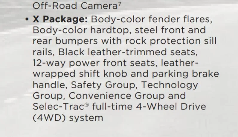

@ShadowsPapa did you or anyone else ever get to the bottom of this? I’m replacing my bought-back 4XE with a JT and I’m interested in an X for the AWD option. There are some VERY juicy deals on 25’s right now…

From what the dealer says, and experience with pictures of dozens of JT interiors, the X does indeed come with the full time t-case. And having just gone through a similar process researching JLUs for my wife - seems that the Rubicon X is the only way to get one in a JLU as well

It looks like I can pick up a JTRX in the 45K ballpark, which seems crazy…
Wow, about 8K under my 25 JTMX with all of the discounts and incentives applied. That would be hard to pass up if it's equipped as you like - but an X has almost everything already.
