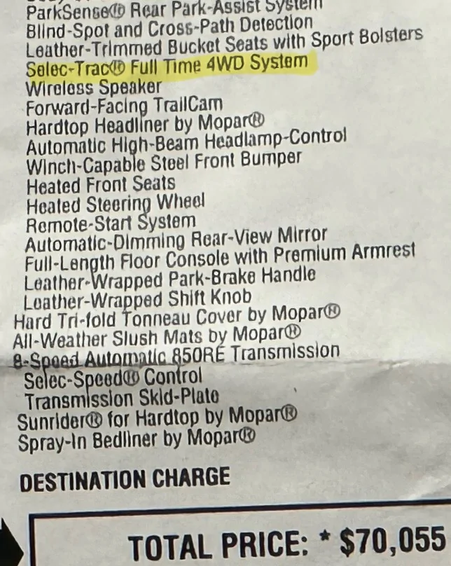

I got it in my Mojave X.
I spent hours looking into this - dozens of dealer web sites, capturing their photos and window stickers and so on. It only shows up on the build sheet.
I have a Mojave X
Not on the window sticker but is on the build sheet and is in the marketing pamphlet from Jeep.
This is what I found on every Rubicon X or Mojave X on a dealer lot, and this is mine -
I've got snips from dealership photos as well.
I was looking for Selec-Trac when shopping. Mine was right on the Mojave sticker though. Weird the variance in being in it or not. I heard something about Jeep swapping out the option later as availability came and went so maybe thats caused the situation. I got my 24 in Feb 25. I could not resist the dramatic price cuts.
Jeep Gladiator Rock-Trac Full-Time 4x4 System? IMG_8081
Gatorized
Sep 13, 2019
1,905
1,800
ME/NH
Wow, looks like they might have discontinued the full time 4WD system??
Here is my window sticker.
Yes, when I was shopping at the beginning of the year (for a 2024 model), the Full Time 4x4 was a line item on the Rubicon X package window sticker. I see it nowhere on the 2025 window stickers I have pulled up. Seems to me it's more than just an error or omission. Now I'm thinking about driving to one of the nearby dealerships here and look inside a 2025 X to see what the shifter looks like.
It’s right there in the optional equipment column - as it should be.
part time is listed as standard, unless replaced by optional equipment.

Not on mine or hundreds of others, it's not. Want to see my window sticker or those of many others?
Sorry, it's not there on any I researched. Not listed. Even dealer was baffled. Go check out other threads on this.
I never found it in a single 25 window sticker, and worse, it's not listed at all in the big order guide! Not anywhere under any name or code. I have the PDF

Yes, but it is not listed in the new 2025s. If you read the thread you’ll see it explained. Shadowspapa showed it is in the photos on various dealers websites but it is not listed on the window sticker.
