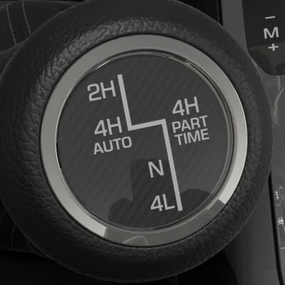

so I am still searching for more information on the Rock-trac full time t-case. from what I have gathered so far my current assumptions (based on things I have found and its hard) I have come to the following conclusions about this option:
1) Selectable 2h, 4w full time, 4w lo, 4w hi part time
2) when in 4w full time uses a clutch type system to allow transfer of torque between front and rear just like AWD
3) when in 4w lo or 4w hi part time, engaged with chain and gear for a true lock, keeping with the rubicon trim and sought after true locking t-case
4) with the ability of 4w full time (AWD) the front axle joints will come with CV joints instead of the U-joints.
5) this system has been available on EU jeep models for some time now, finally bringing it to the US.
6) the fact that it is highly probable it will have CV joints does not bother me, I planned to swap to the RCV chromoly axles anyway regardless of U or CV. and coming from a Tacoma, IFS and CV joints, doing stupid stuff with that truck, I only ever once tore a boot.
I have been trying to confirm this 100% through jeep, however they are hesitant to reply since I currently do not have a VIN, due to the fact its on order through military auto source and has not been scheduled for build due to requested delivery of March.
my conclusion, if the above information is accurate, I will add this to my build order, having the ability to go from 2hi to 4w full time is beneficial to me in rain and snow covered roads, with ability to still get 4whi part time with a truly locked case for off road use.
appreciate any feed back.

The 4:1 Rubicon case has a larger chain and 4:1 crawl ratio, where the stock (sport and other models) one is 2:73 irrc. The auto 4H just comes on if your wheels start to slip. Since all JTs and all wranglers can just be manually pulled into 4H while moving this feature basically just does it for you.
4H, or 4L, isn't pavement friendly. Needs slippage or wide turns.

so my initial assumptions about gear selection was accurate, can select 2H, 4H Auto (like all wheel drive), 4H part time and 4L part time.
Still waiting on confirmation of engagement, is it all clutch/viscus or a combination of chain, planetary gear and clutch/viscus.
looking at the mopar website on diagram breakdown for the Rock-Trac Full Time 4WD, it does show a clutch, chain and planetary gear system.
seems like the best of both worlds depending on where you live and road conditions throughout the year.
