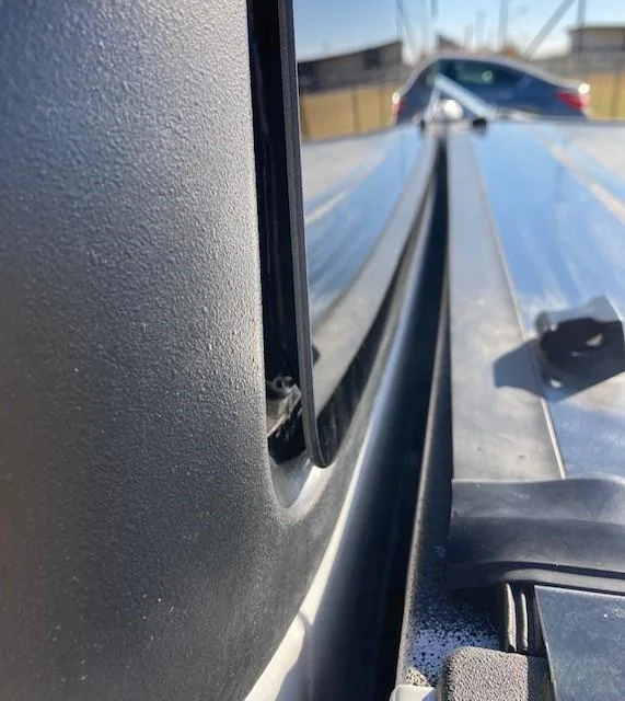

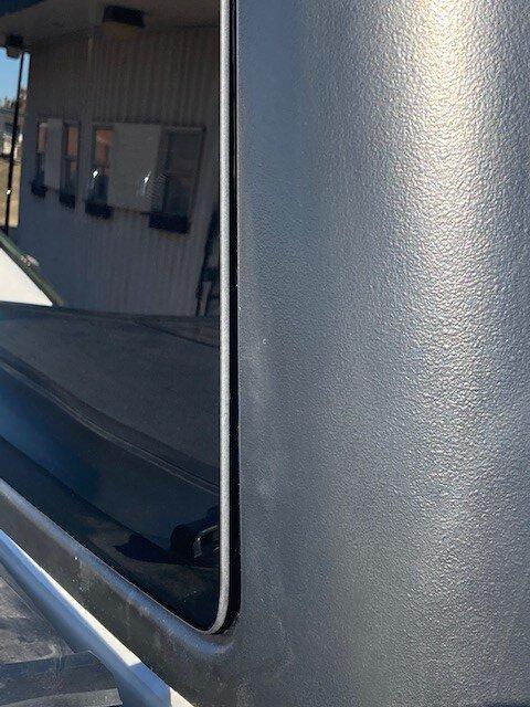

New here and ... "me too". Rear window leaking above left passenger, took to dealer and they had to get approval from FCA then order a replacement rear glass. Sent it to "the best auto glass shop in town" and it came back installed crooked:
Jeep Gladiator Roof leak in back Right1
Jeep Gladiator Roof leak in back Left2
Called it to the attention of the service manager and he agreed it wasn't right, so they took it back to glass shop and they straightened it out somehow.
Three days later and was leaking again, this time in the center above the slider, and the defogger also isn't working. Dealer's taking it back to "the best auto glass shop in town" to get them to take another look at it. Comment about the defogger was "hard to check if the weather's not right" so I suggested maybe putting a current tester on the battery to see if the current draw changed when it was on vs off.
At least they've been providing a loaner, so far I have almost as many miles on it as my JT over the past couple of weeks. :crying:
Clearly they don’t know how to test a defroster ??‍♂ All you have to do is use a multimeter and place the leads at opposite ends of the grid lines. If you read voltage it’s working, no voltage and it’s not. This will work no matter if it’s 100 or 0 outside. This is making me look even less forward to getting mine swapped, especially since the dealership already broke one of the trim panels above the back window trying to diagnose it ??‍♂??‍♂
