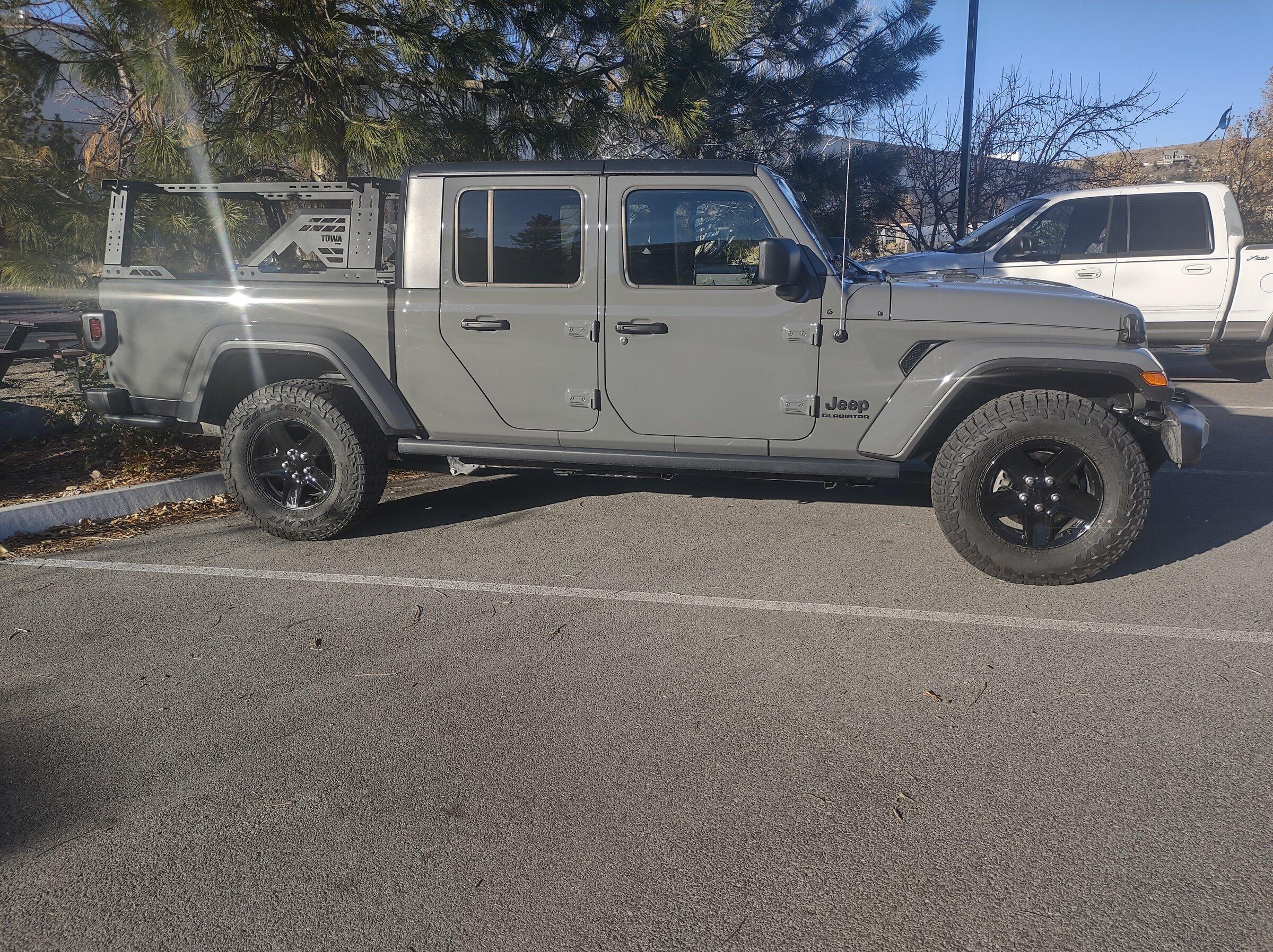

I've wheeled with my leitner rack and have had no issues whatsoever with COG. It has been super convenient and does not impede rear view mirror at all. The only time bed racks will is if you do a short or mid height. With a full height you dont have that issue.
However I am getting rid of my leitner rack as I am getting a GFC so i will not need it anymore. But leitner is the way I would go without fail.

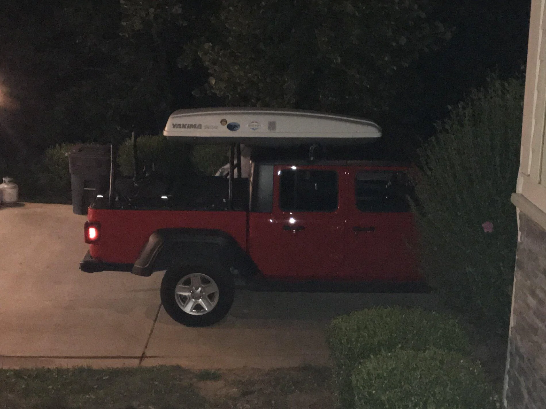

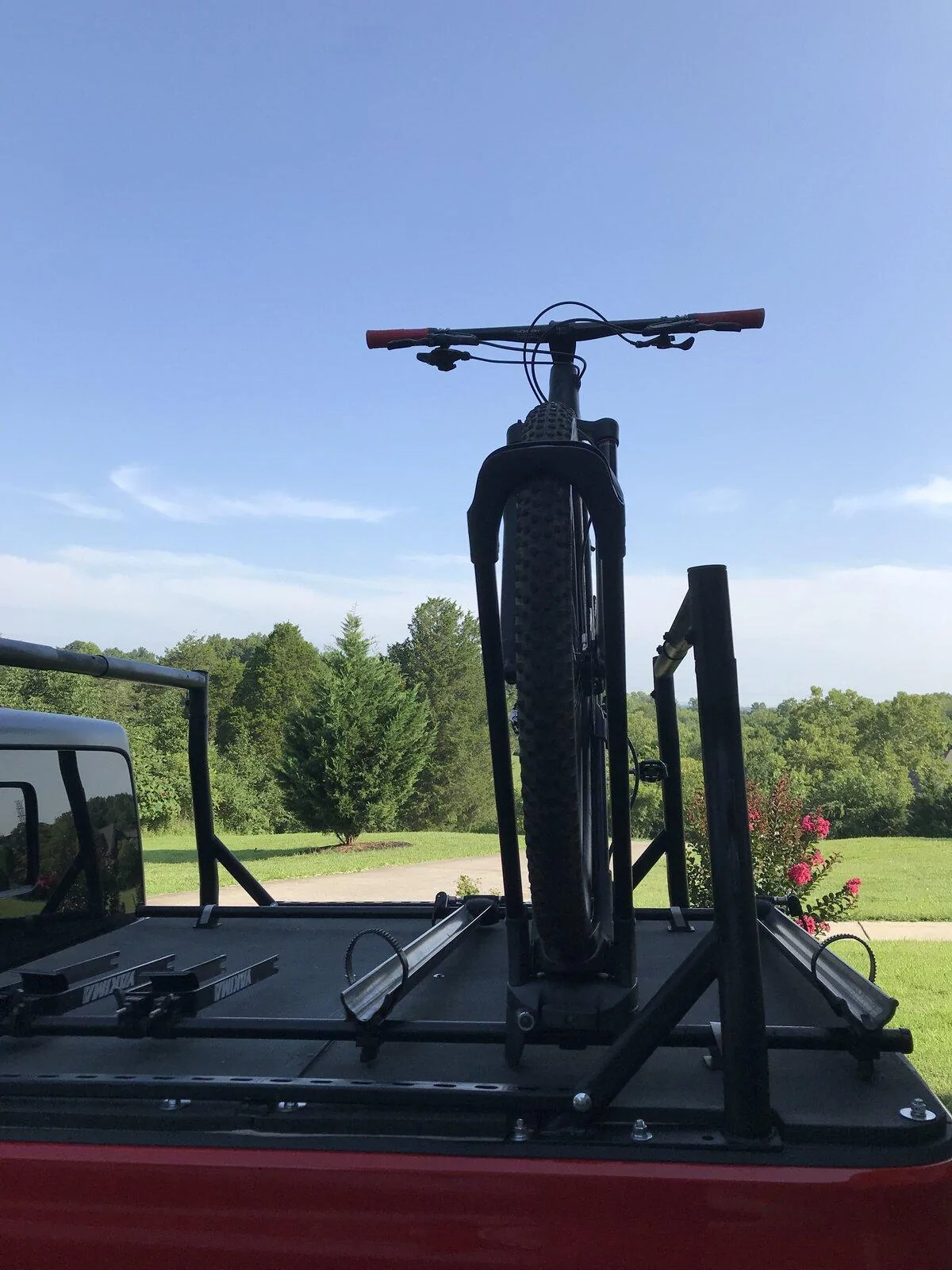

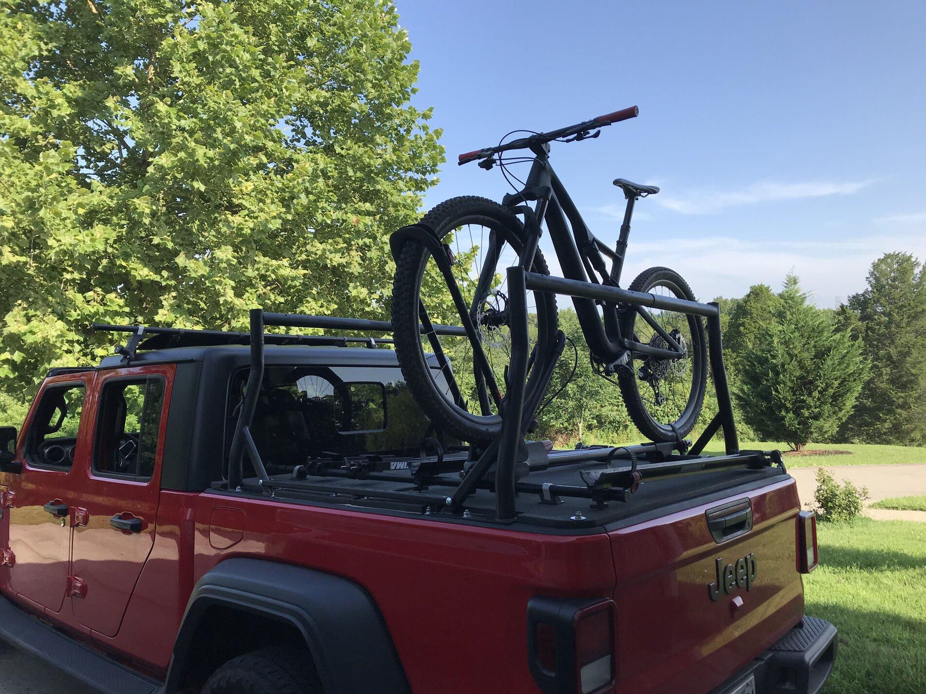

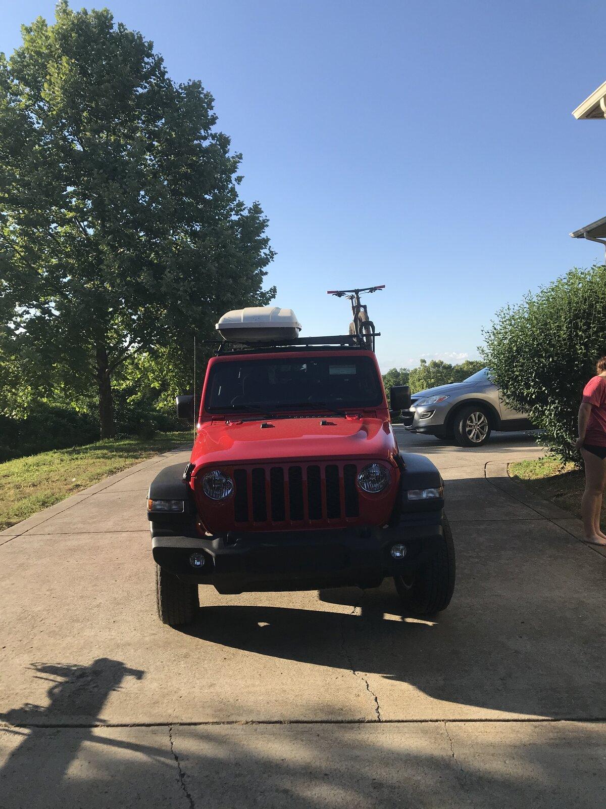

I like a hard cover with mounts for bikes and cargo, drawer system and bed rack. The bed is a lot more useful than an open 5x5foot box. I made mine and was given the Chinese bed rack. I took off fender flares and rail caps on the bed and uses existing holes in bed rail to mount the rack. I also cut the rack down so that it didn’t stick up so high and matched the height of my hard top mounted single Yakima bar and faring. I have about $200 in this set up $180 was for The textured deck paint and plywood for the hard bed cover.
I already owned the Yakima racks from 20+ years of road and mountain biking.
I hate hitch racks, I have an expensive Yakima one, as my expensive bikes sit back there ready for any idiot on the phone to bump into at a stop.
1st pick is bed side mount for bikes. I liked second set up better as bikes are protected better.

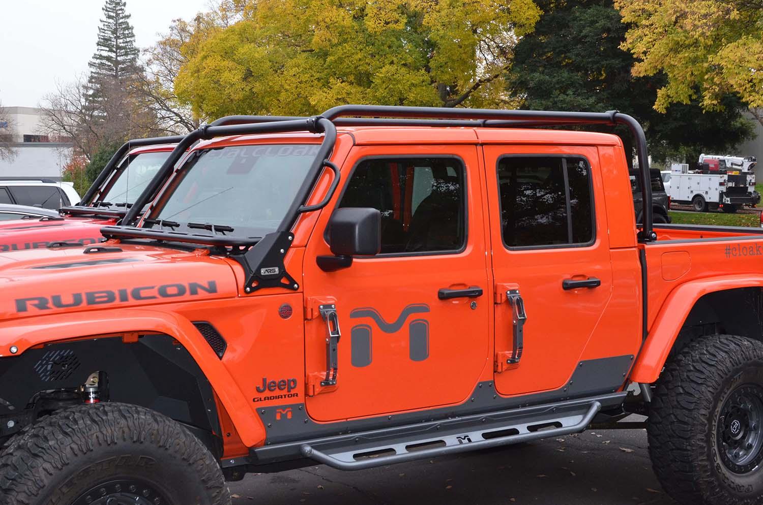

Adventure Rack Systems
Summit Sponsor (Level 3)
ARS
55
49
Rancho Cordova, CA
www.adventureracksystems.com
2021 JT Gladiator Rubicon
Manufacturer
I’m looking at ways to expand storage for a road trip later this year and exploring roof racks and cargo carriers. I feel like I’ve identified the pros and cons of each, but I’d be curious to hear what y’all are doing and why.

One other consideration would be systems that utilize the space over the cab. We just rolled ours out last month (the ARS "OverCab" system). It allows you to mount a RTT up top and still keep the bed free... or just use it for construction, kayaks and longer items (since the Gladiator beds aren't very long).
