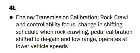

Yes, you did. This is what you've said. It clearly shows you want to go faster in 4L.
This is where you're getting all these replies talking about how it works and why you probably want 4H. Keep in mind you've posted up in the "Issues" section, which implies you have a problem. The problem, as you describe, is that you can't go faster in 4L reverse. I would recommend using 4H instead.

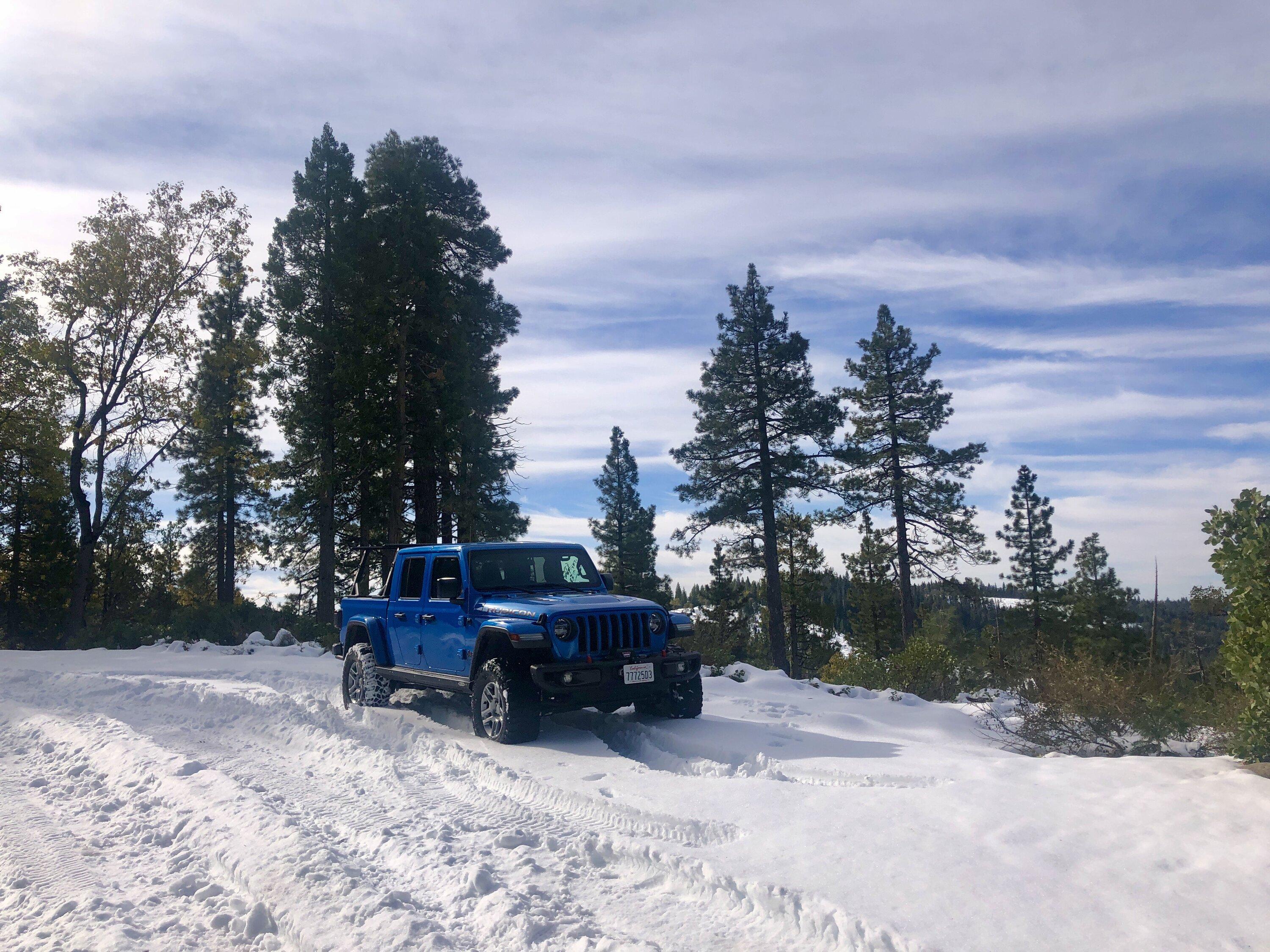

I did not post this in the “Issues” section. I posted this in the “General Topics” section. A forum administrator decided to change it to the “Issues” section.
I never said anything like how do I eliminate the rpm limits or how do I make the truck go faster than 3500 rpms in 4L Reverse. I simply asked has anyone else noticed these limits in 4L Reverse.
As already noted, 4L Reverse at around 3500 rpms was working fine for the conditions I encountered. Shifting into 4H would have required bring the truck to a stop, and I would have lost the use of the front locker. At that point I may have been stuck.
I never have tried to jerk people around. I have been called names in this thread as well as poked fun at, but have never responded in a like manner.
