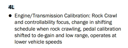

Just to clarify for those looking on and who want to test this -
He was in Off Road + mode.
That's only Rubicon (perhaps Mojave???)
So don't bother taking your Overland, Sport, Sport S, Overland High Altitude or anything else out and trying it.
And when you try it, be in 4L with OFF ROAD + engaged.
OR+ de-gains the throttle and since it's likely connected, only a JT with OR+ can try to duplicate his experiences.
No use me trying as I don't have Off Road +
True, I was in Off Road+ when I first experienced the rpm limiting in 4L reverse, but have since noticed the rpm limiting by just putting the truck in 4L reverse, no Off Road+, no lockers, no other changes. Sorry I didn’t clarify this earlier.
