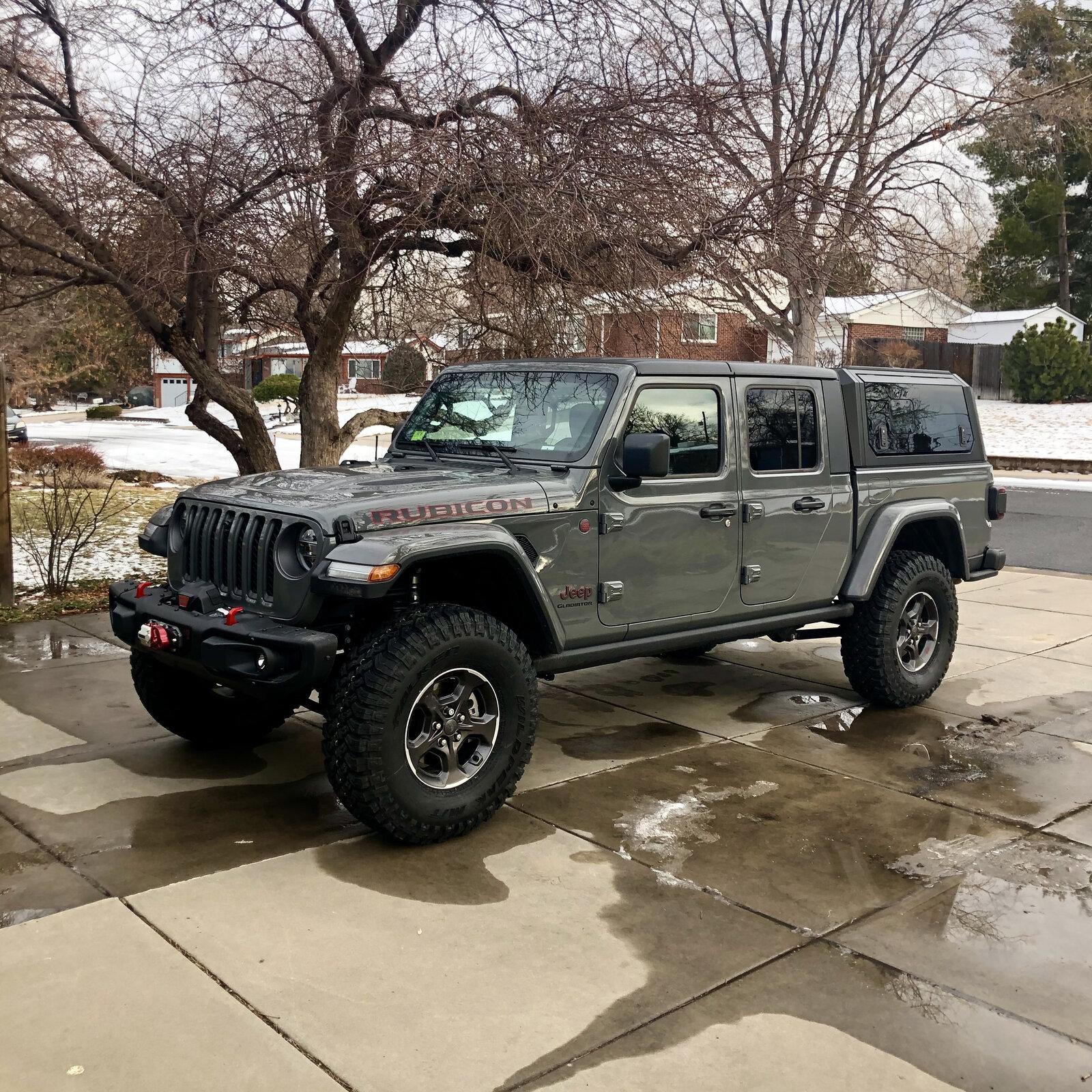

Just an update on how she looks with a lift and proper 37's under her...
Jeep Gladiator RSI Smartcap IMG_4427
@RSI North America Inc I too am wondering if we are able to lift the cap by the roof rails using M8 weld nuts and eye bolts. I plan to lift from all four corners where there are two bolts attaching the rail to the roof.

That is a good looking truck! Have you noticed any type of squat from the rear or did the cap level your truck any? I will eventually have the same setup when my cap arrives, already have the steel bumper, winch, mopar lift, and decked bed storage.

Talking with Clayton Offroad they recommended I add a .75" spacer to the rear to account for the 170lbs of standard bed weight, i.e. weight that will almost always be there. I did not do that because I could barely get the rear springs in as it was. I'm pretty sure I did not have the control arms loose enough to drop the axle all the way. I just measured and currently I sit level with the topper, a 37" spare in the bed and no .75" spacer.
You may want to factor in your Decked System weight.

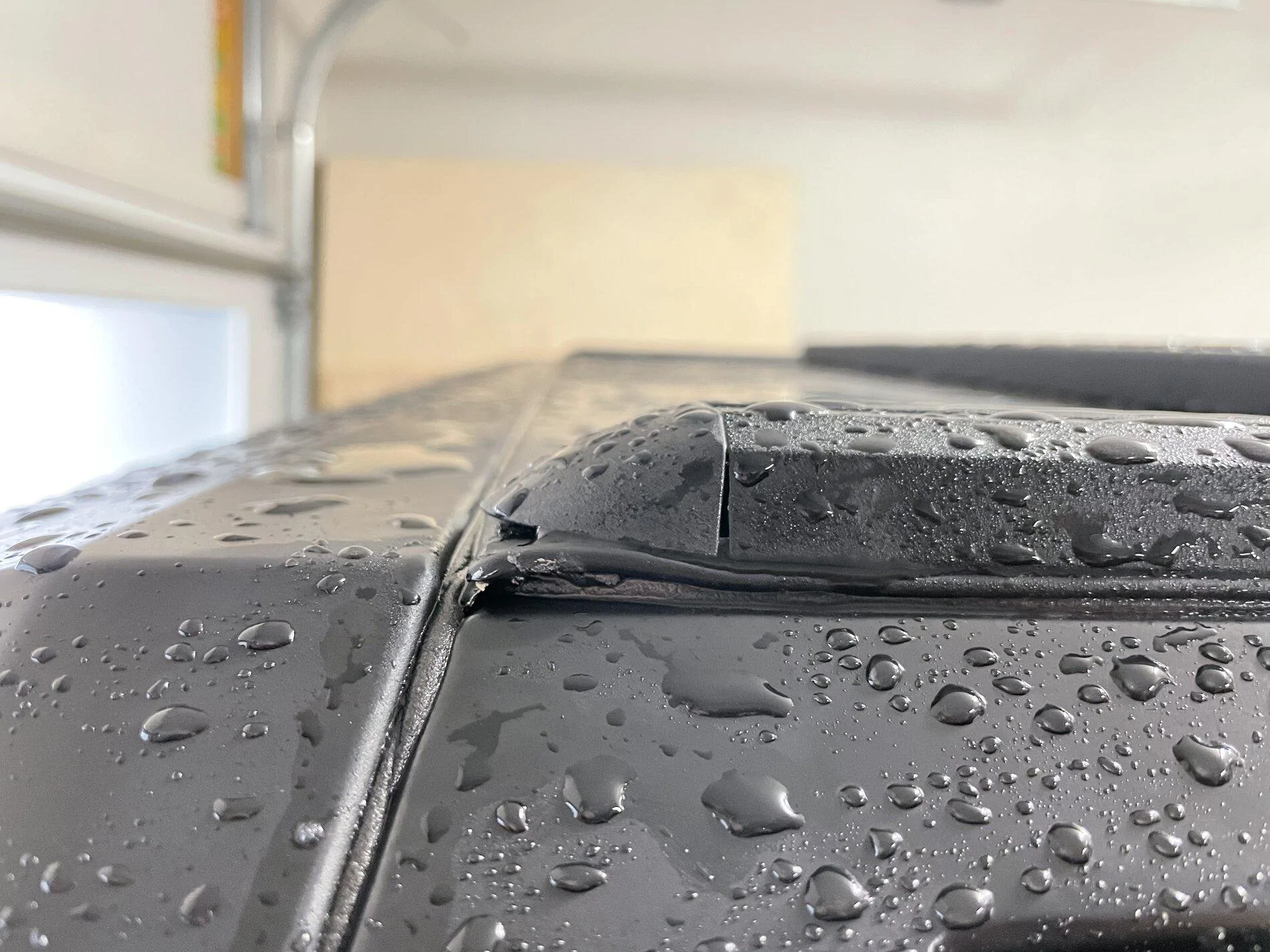

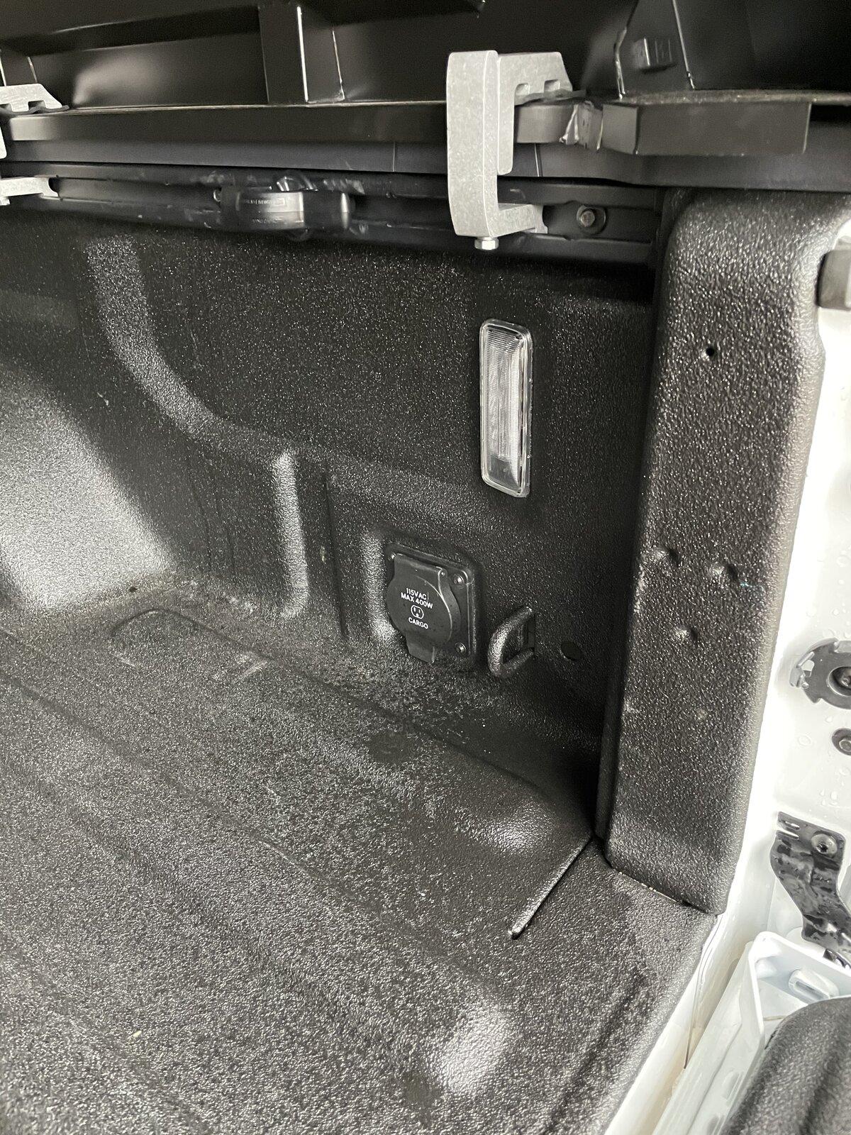

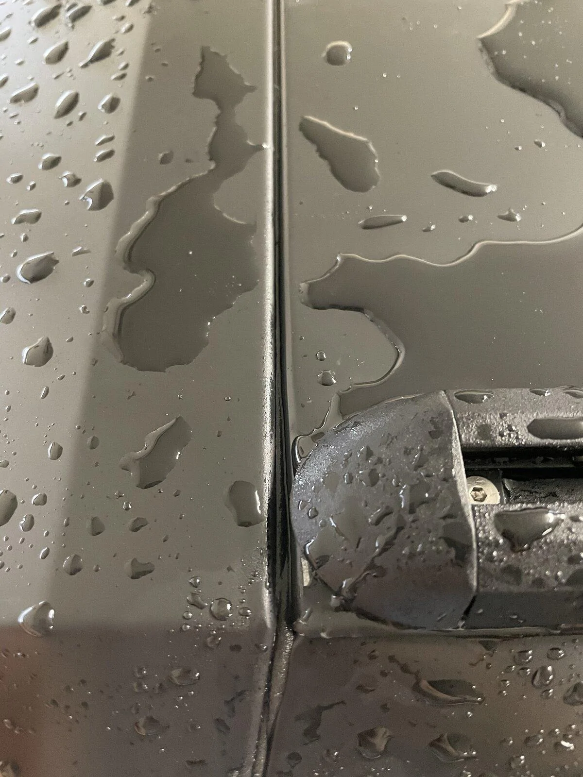

Had my first chance to test out the weather resistance of my cap and it failed. I’ve got rain coming in steadily on the rear passenger corner from the roof. I knew I had a slightly damaged roof panel after inspecting so I wondered how it would fare. On the bright side, the rest of the bed is bone dry so I’m confident that it’ll seal properly once corrected.
My dealer didn’t mention any of the damage to me after install so I’m not particularly happy about that either but that’s an issue to raise with them. @RSI North America Inc what are my options here? I don’t think it’ll take much work to correct. Just looks like the roof panel needs to be straightened out a bit and touched up on the paint.
