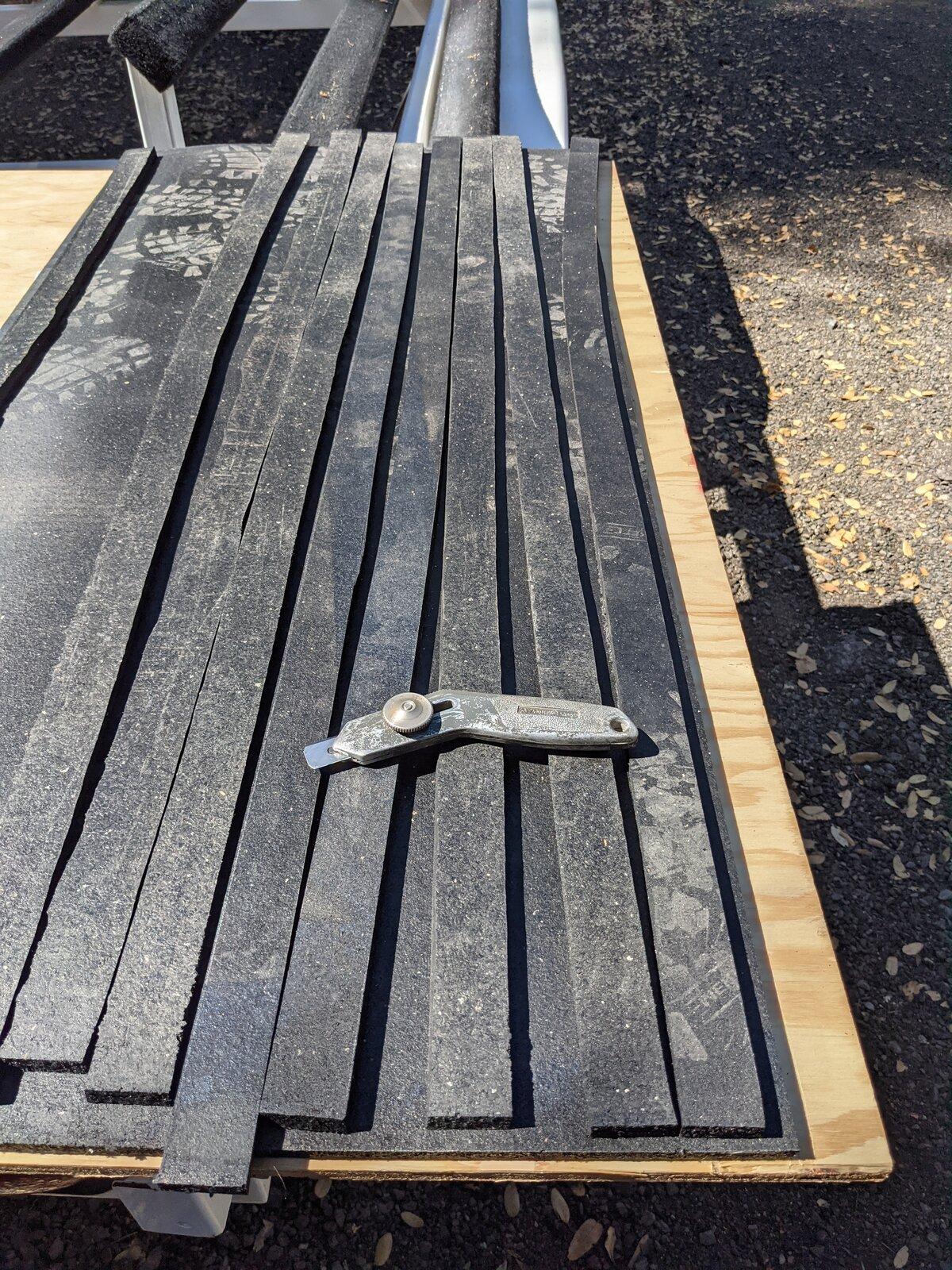

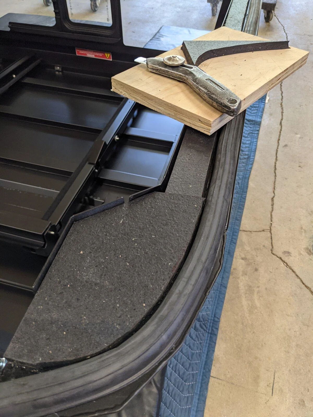

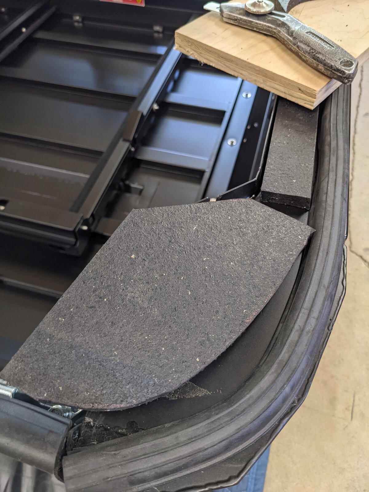

I had to take the topper off for some warranty work and was not looking forward to holding spacers in place while I was putting it back on. I was also not happy with the dented top rail although most of it popped out in the sun. I wanted to find some way to distribute the weight better on those plastic top rails. I went to tractor supply and bought 1/2" stall mat for $27. I cut it into the correct size strips and installed it on the topper. that is 1" on the front and 1 1/2" on the sides. I used silicone to hold it in place so i can peel it off if I'm not happy with it.
I did use the red hardware store rubber material on the door end to give it an extra 1/8 inch of clearance.
By far the easiest way to cut this stuff is with the carpet knife and a straight edge.
BTW anyone in the Bass Lake/Yosemite area can have the rest of the this material if they want to pick it up before the next trash day.
This stuff stinks when you first pick it up but a day in the sun did wonders on airing it out.

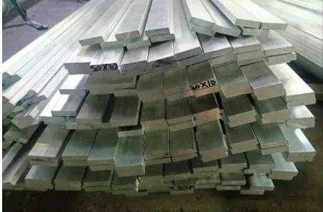

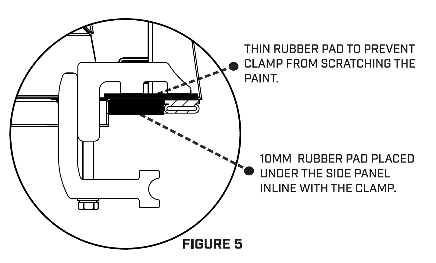

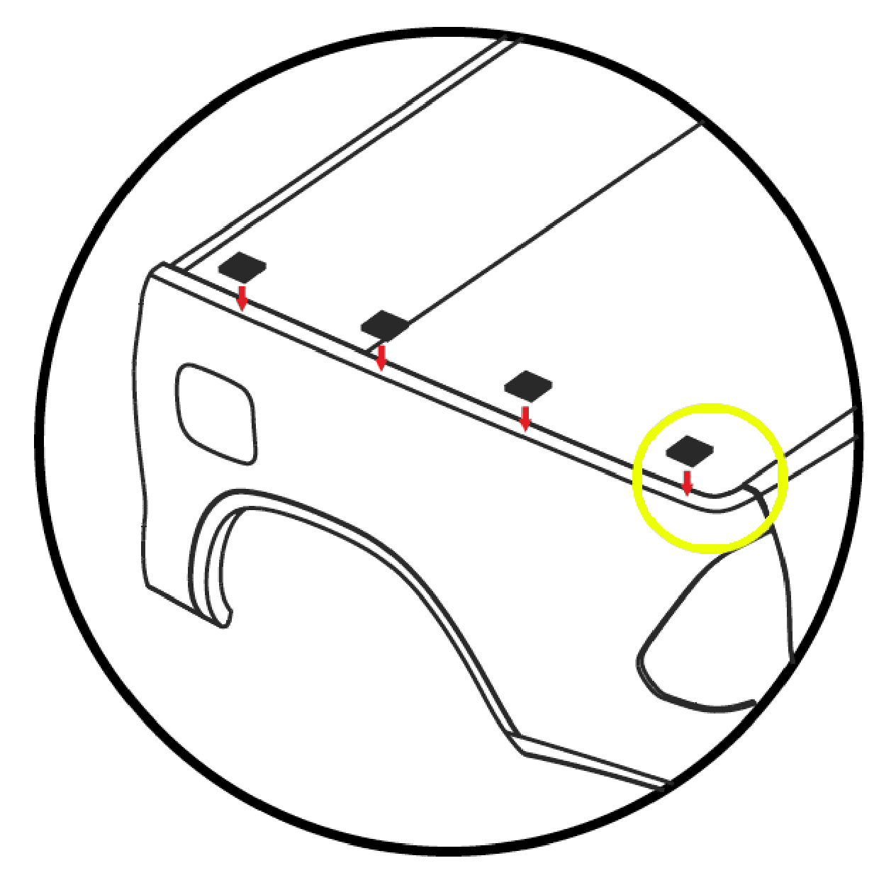

Thanks for sharing this. I was wondering if I can use the flat aluminum bars to spread the pressure more evenly.
According to the information in previous posts:
Jeep Gladiator RSI Smartcap Screen Shot 2020-11-15 at 11.04.33 AM
Jeep Gladiator RSI Smartcap Adding a Pad By Tailgate
Here is what I want to do:
Prepare some aluminum bars (H: 8mm, W: 38mm, L: 300mm), combine with H:3mm W:40mm rubber trim to replace those 10mm rubber pads, should be able to improve the bedrail cap problem.
Jeep Gladiator RSI Smartcap Screenshot 2021-08-15 155527
Jeep Gladiator RSI Smartcap Screenshot 2021-08-15 155729

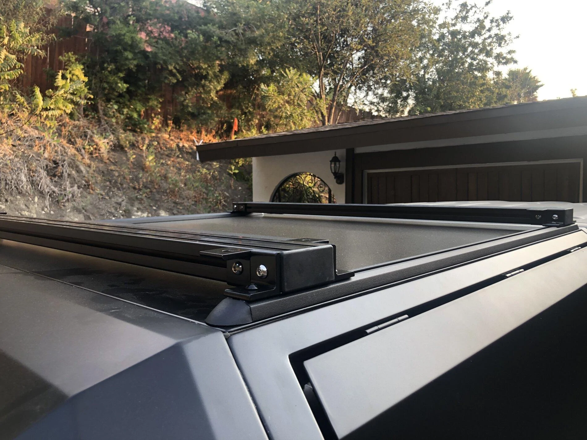

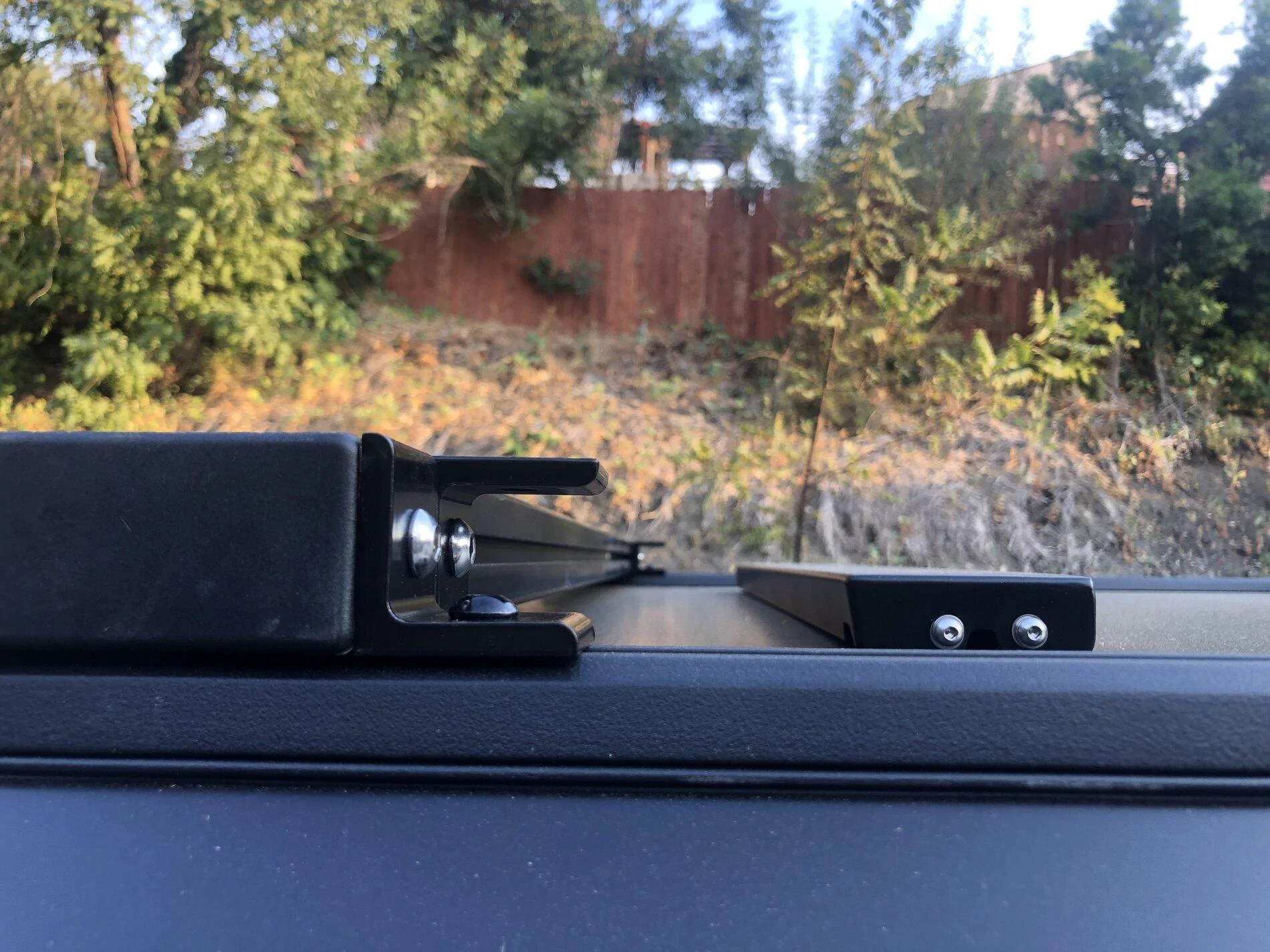

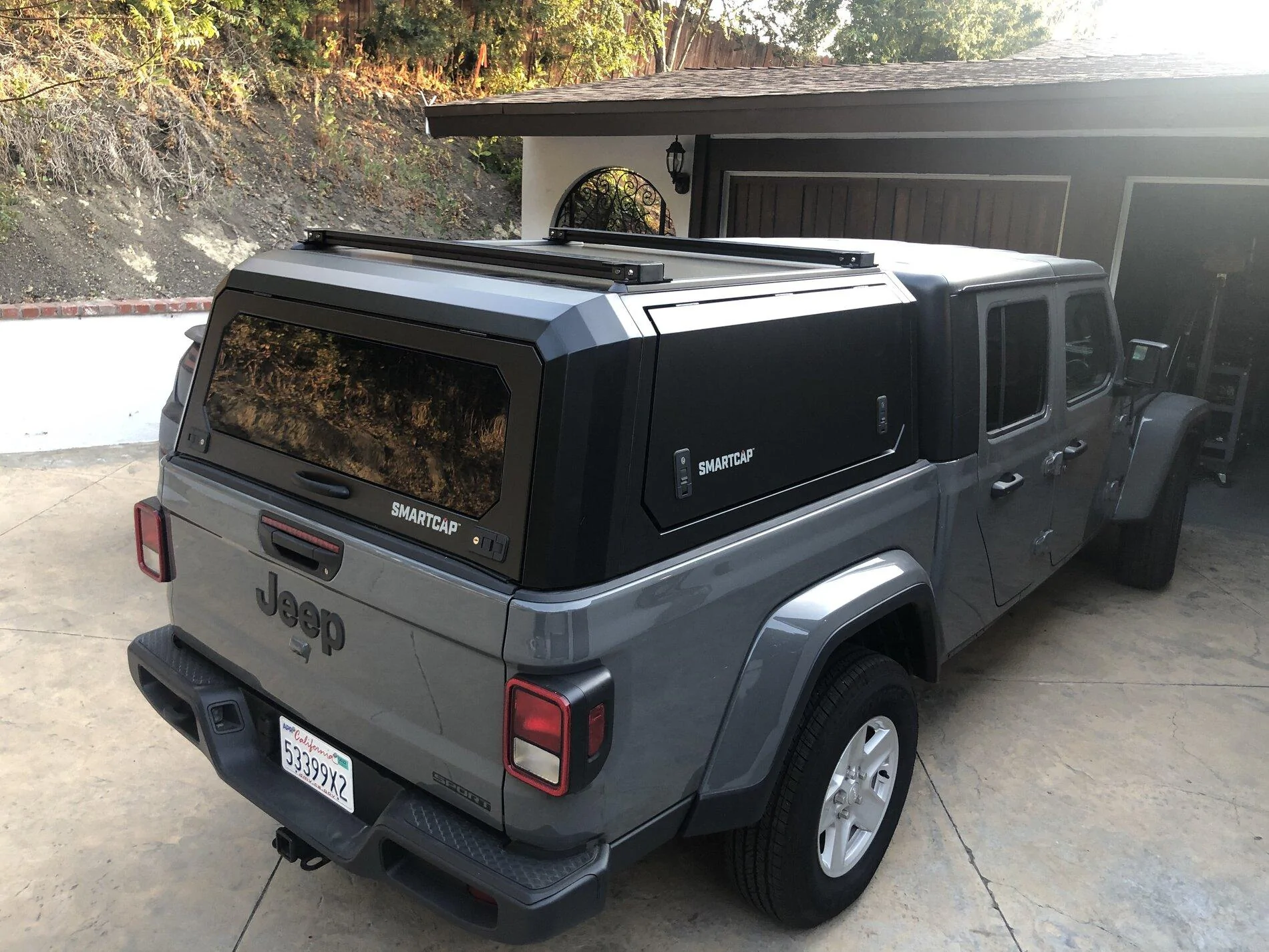

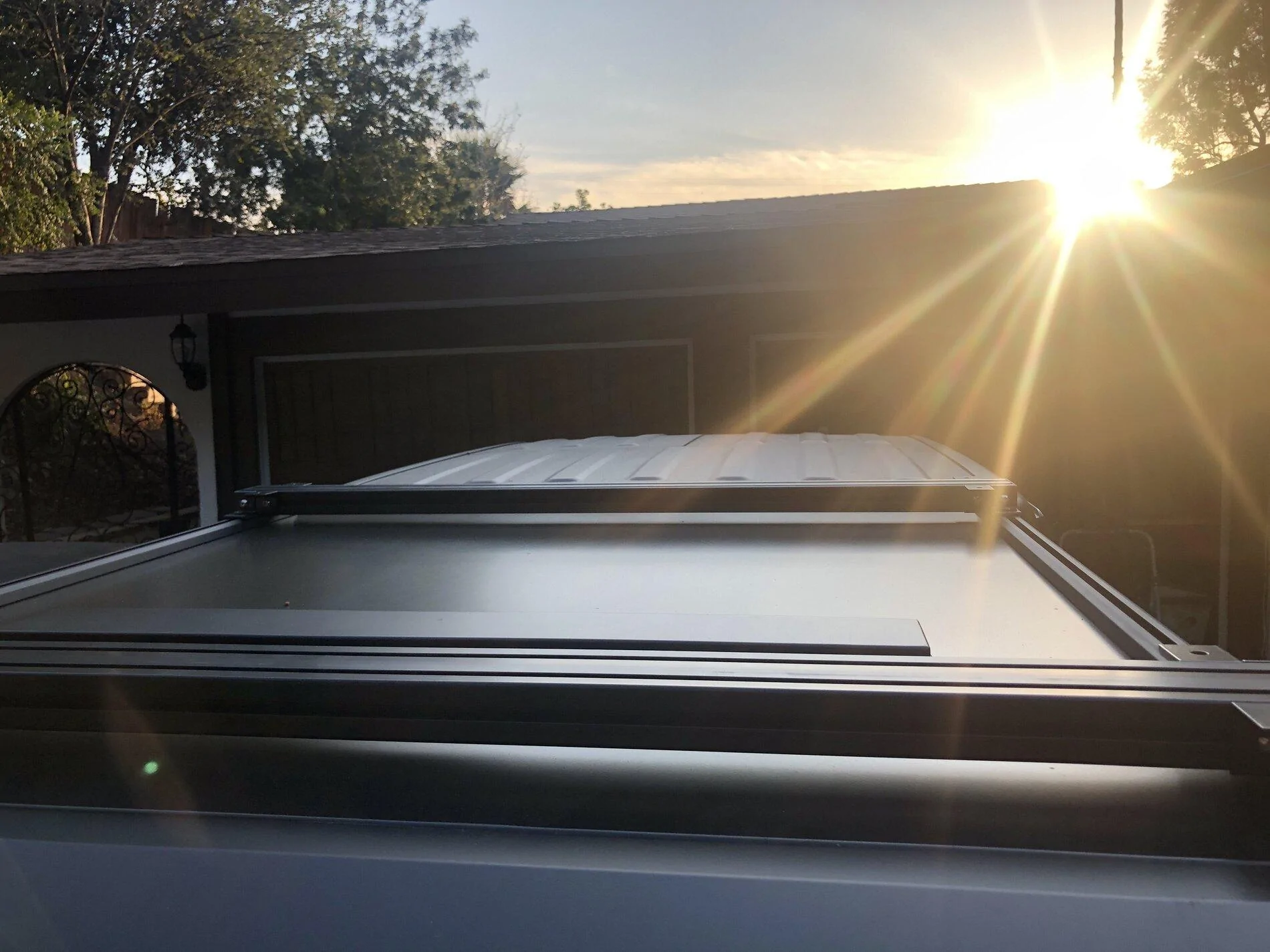

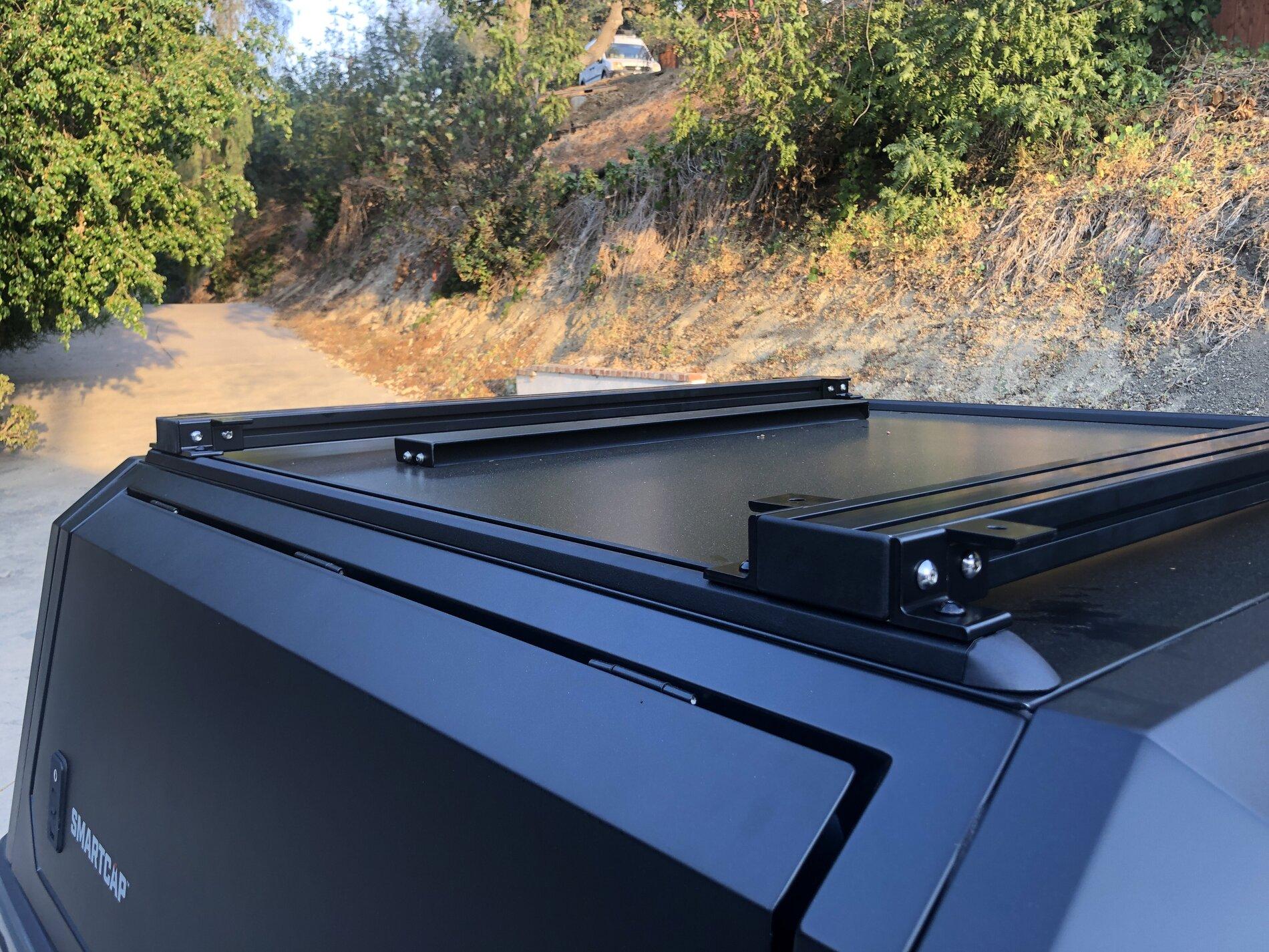

Got mine installed Friday, ordered it 2 days prior! Called a camper shell shop in the Los Angeles area, they called their distributor to ask for lead time and before they delivered it to the shop the next day. And it was installed on the following day. Lucky me considering lead times.
Anyway load bars were back ordered for month so I built something around T framing extrusion. I went with 48" of 40x80 mm profile (which also uses M8 which is the same size the weld nuts used in the smartcap rails), everything is mounted using 40x40 mm L-brackets and terminated with plastic end caps.
I'll be installing a Trustmade roof top tent which is longer than the bed and will slightly overhang above the cab. I wanted the everything as low profile as possible which is why I went with 40 mm profile as it will make the RTT sit real close to the top of the cab.
Attached a few pics in case it helps anyone

I got everything from mcmaster. The profiles are standard metric 40mm dual’s. They had black anodize for both the rails and the L brackets. And black plastic caps.
You can find those cheaper than mcmaster for sure, I was just in a rush.

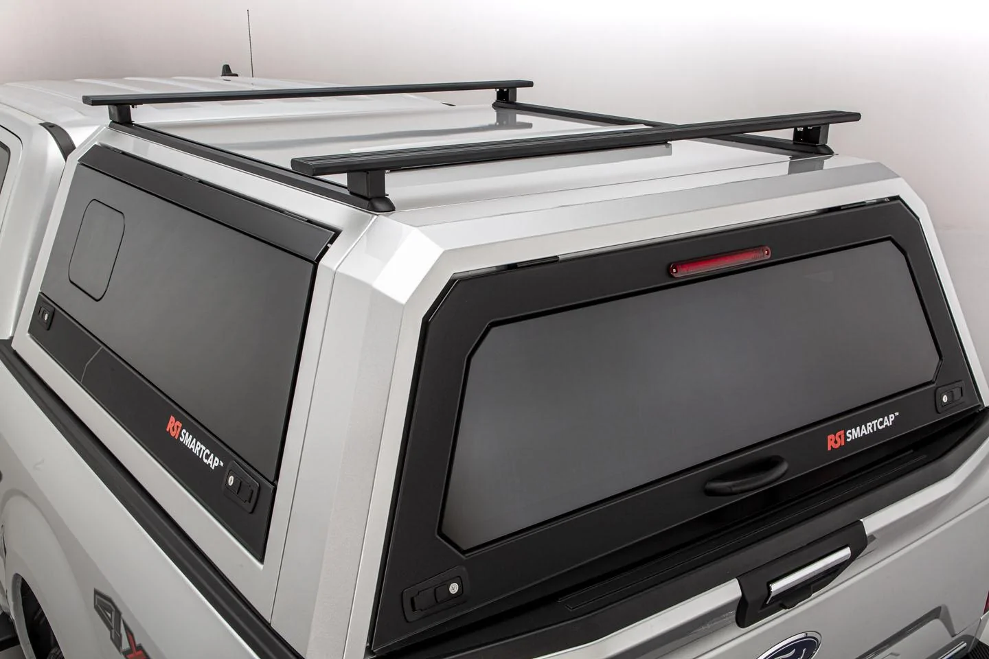

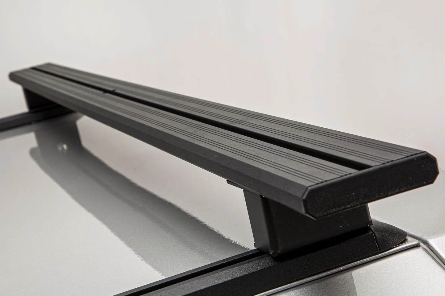

@RSI North America Inc What is the width and height of the load bars? Would you please post more detail images of the load bars?
The Load Bar dimensions are:
Length = 53.15 in (1350 mm)
Width = 3.15 in (80 mm)
Height = 2.56 in (65 mm)
Total Height above roof (including mounting feet) = 3.15 in (80 mm)
Jeep Gladiator RSI Smartcap smartCap-load-bars_1
Jeep Gladiator RSI Smartcap smartCap-load-bars_2
Jeep Gladiator RSI Smartcap smartCap-load-bars_3
