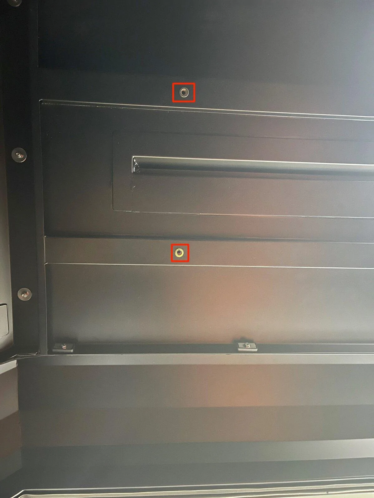

does anyone know the bolt size and thread that the inside roof the of the evoA accepts? i have a gazelle t4 ground tent which is > 5 ft long and i would like to mount it on a diagonal on the top of the roof (not quite a RTT lol)

We use an M8 x 20mm button head screw with a 1.25 thread pitch. Ensure that the bolt is not longer than 20mm, as anything longer will dent the roof panel on the outside while tightening.
