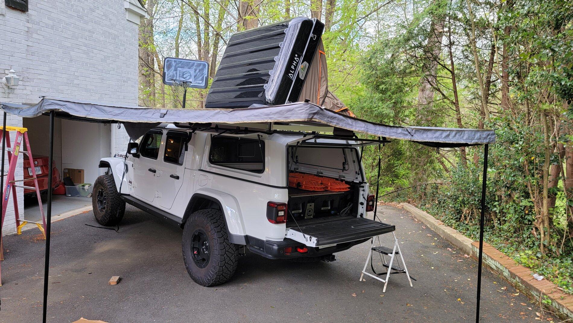

Hey Guys...thought I'd share a some RSI Photos with OVS Awning, RTT and link to a short walk around vid of my EvoC with load bars, OVS 270 awning and a new TuffStuff Alpha II clamshell Roof top tent installed. I had to slightly off center the load bars to driver side and offset RTT slightly to passenger side so that there was sufficient clearance for the RTT clamshell to open without hitting the awning in closed position. When the awning is open, there is not clearance issues with gull wing doors of Cap. The mounting clamps shipped with the Alpha II do not fit the RSI load bars, so I fabbed my own out of aluminum bars from home depot. 20210411_172656.jpg
I’m looking to go with the same setup. How much of a MPG killer is the RTT?

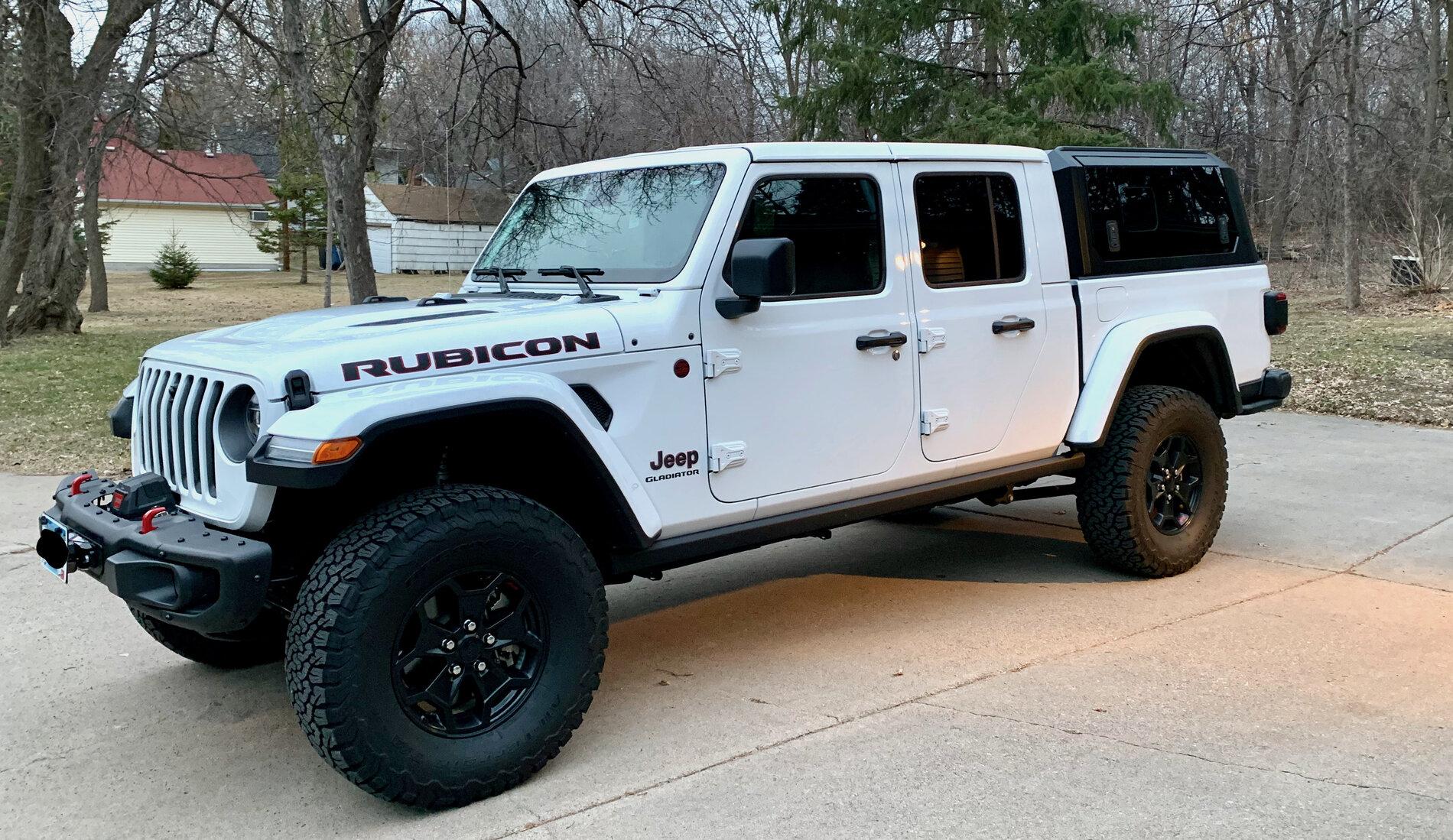

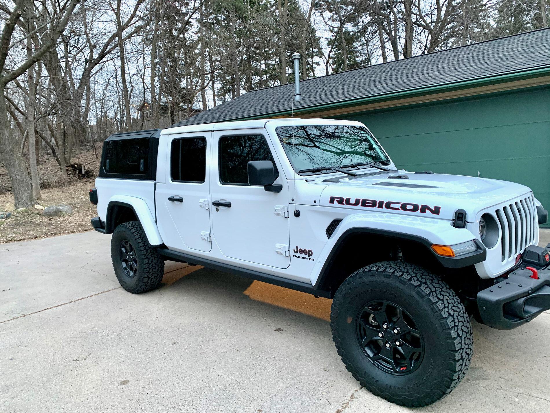

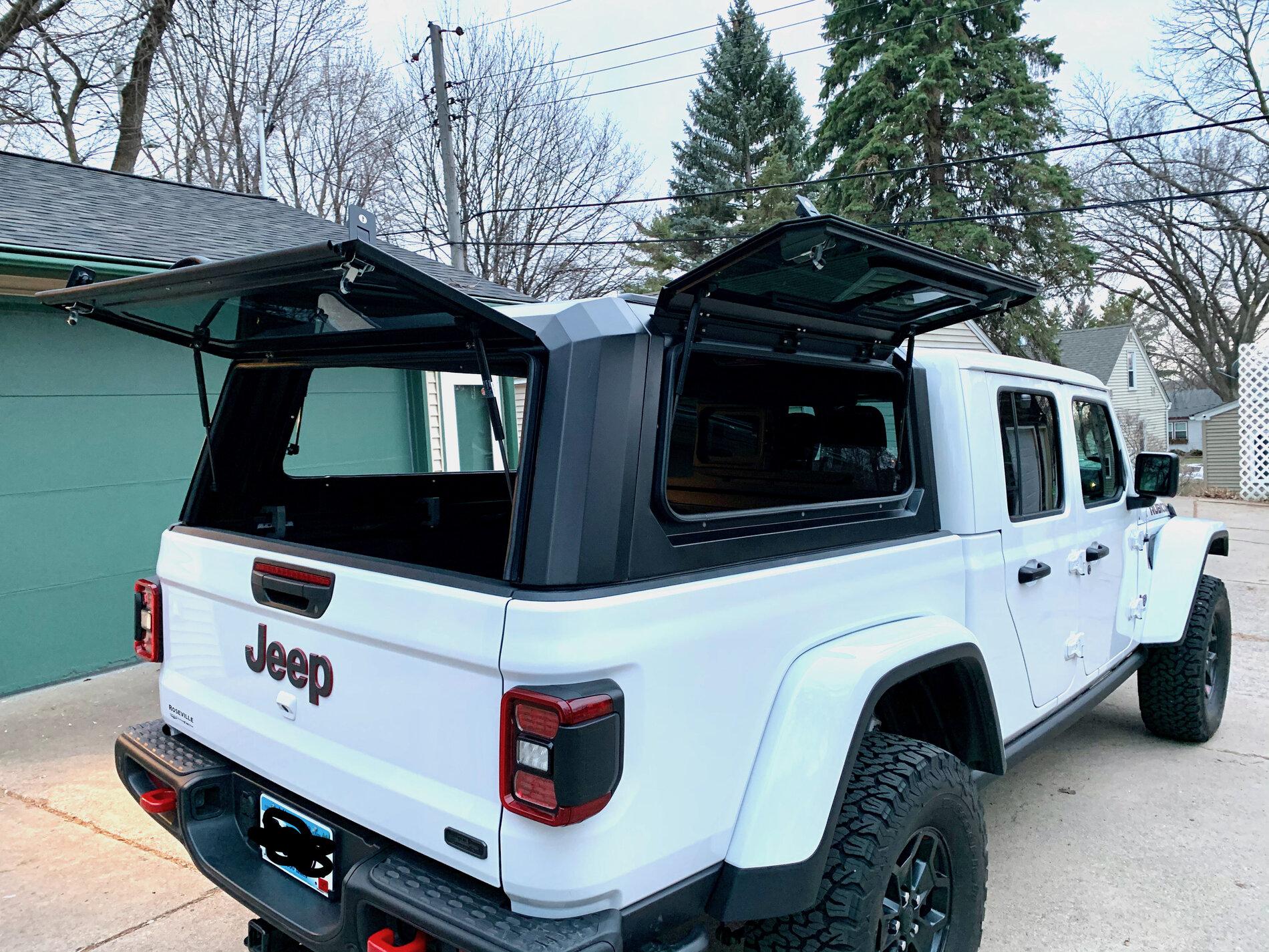

The White Rabbit
Jul 12, 2021
1,750
3,092
Sweeny Texas
2021 Jeep Gladiator Mojave
Self Employed
The long saga is mostly complete :)
Received my cap in November and through a series of unfortunate events instillation was delayed until a couple days ago.
I think it turned out pretty decent!
Front Runner load bars and RTT are going on over the weekend. Next week we leave for a 10 day trip! fingers crossed it all goes smooth from here on out.
I was hoping someone with a white hardtop would post. I am getting a sport for the features that really wanted color match but it looks pretty good with the white hardtop. Still would prefer color match but not will to give up the glass gull wings.

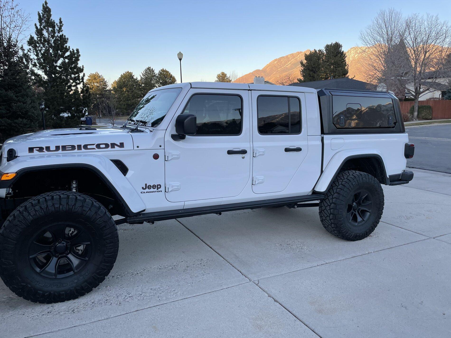

beelzebot
Nov 29, 2018
400
422
Utah
2020 JTR, 2019 Pacifica Hybrid, 2009 Mini Cooper S Convertible
I planned to paint mine Bright White to match but I like the black enough that I’m leaving it alone. My wife thought it must’ve come directly from FCA because it looks like it belongs. Might try vinyl wrapping the whole truck starting with the cap next year.
Jeep Gladiator RSI Smartcap 66903461-1FB2-4F8D-BD16-DA262362316B

Racer~X
Tony
Apr 28, 2020
45
22151
White Gladiator Rubicon Launch Edition
Honestly, I havent bothered to figure it out bc the Gladiator MPG is already affected by the 37" tires, RSI Smartcap, decked system and step sliders with armor, and awning, so I gave up carring. I get about 280mi per tank on the highway with a full loaded bed of camping gear.
