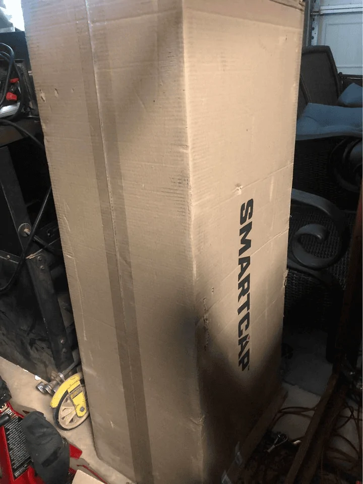

I am going to put this in the for sale etc. area as well but since I know at least 2/3 of you have the RSI cap, I want to put it here too. I have a completely new, unopened, driver-side full-bin. If anyone has a passenger side and is interested in a trade. I am in Oklahoma and I would drive a ways to meet you. I bought a Roof Nest Condor and it opens over the passenger side. So my driver side bin would be on the side of my shower. Totally not cool.

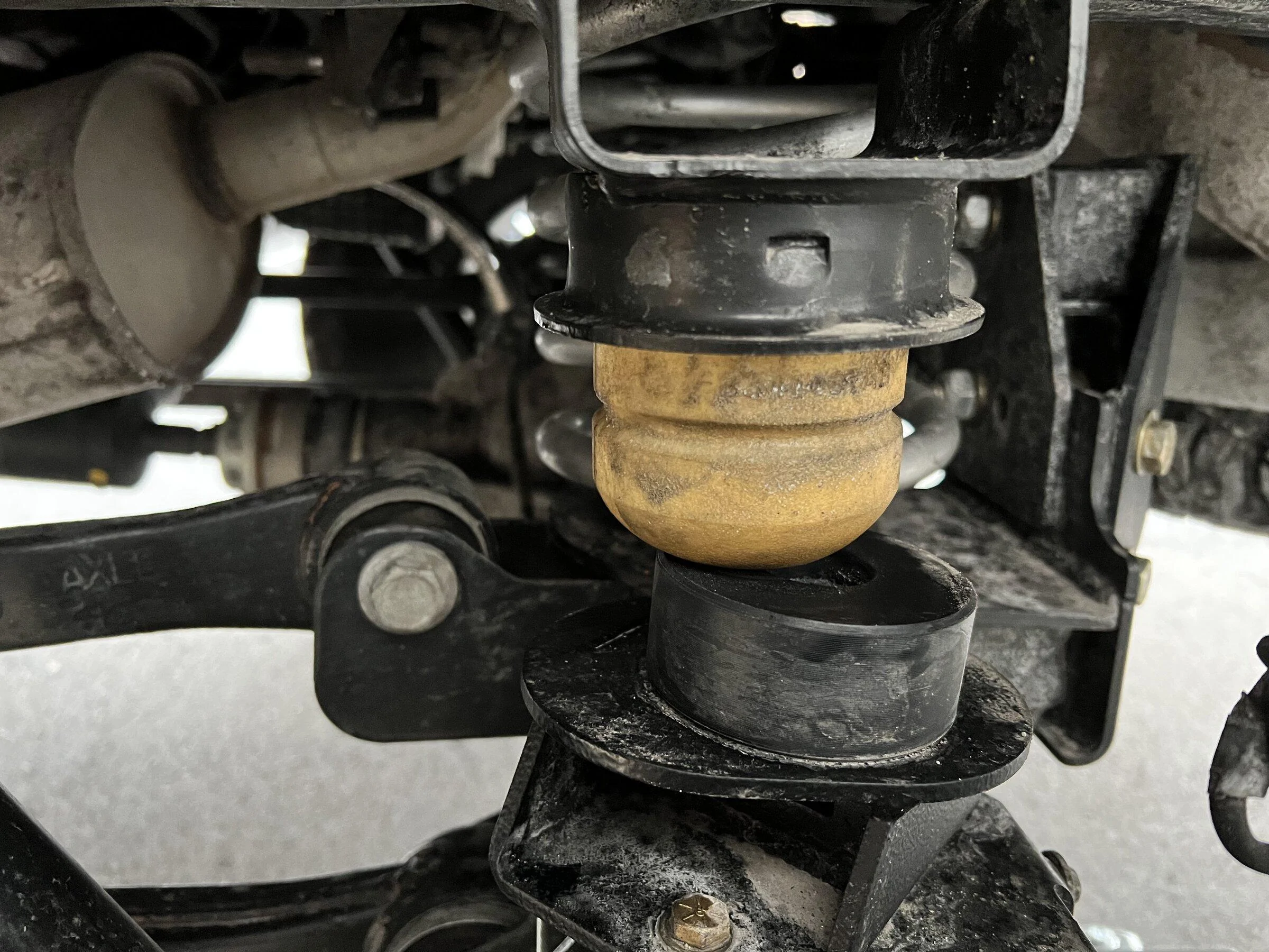

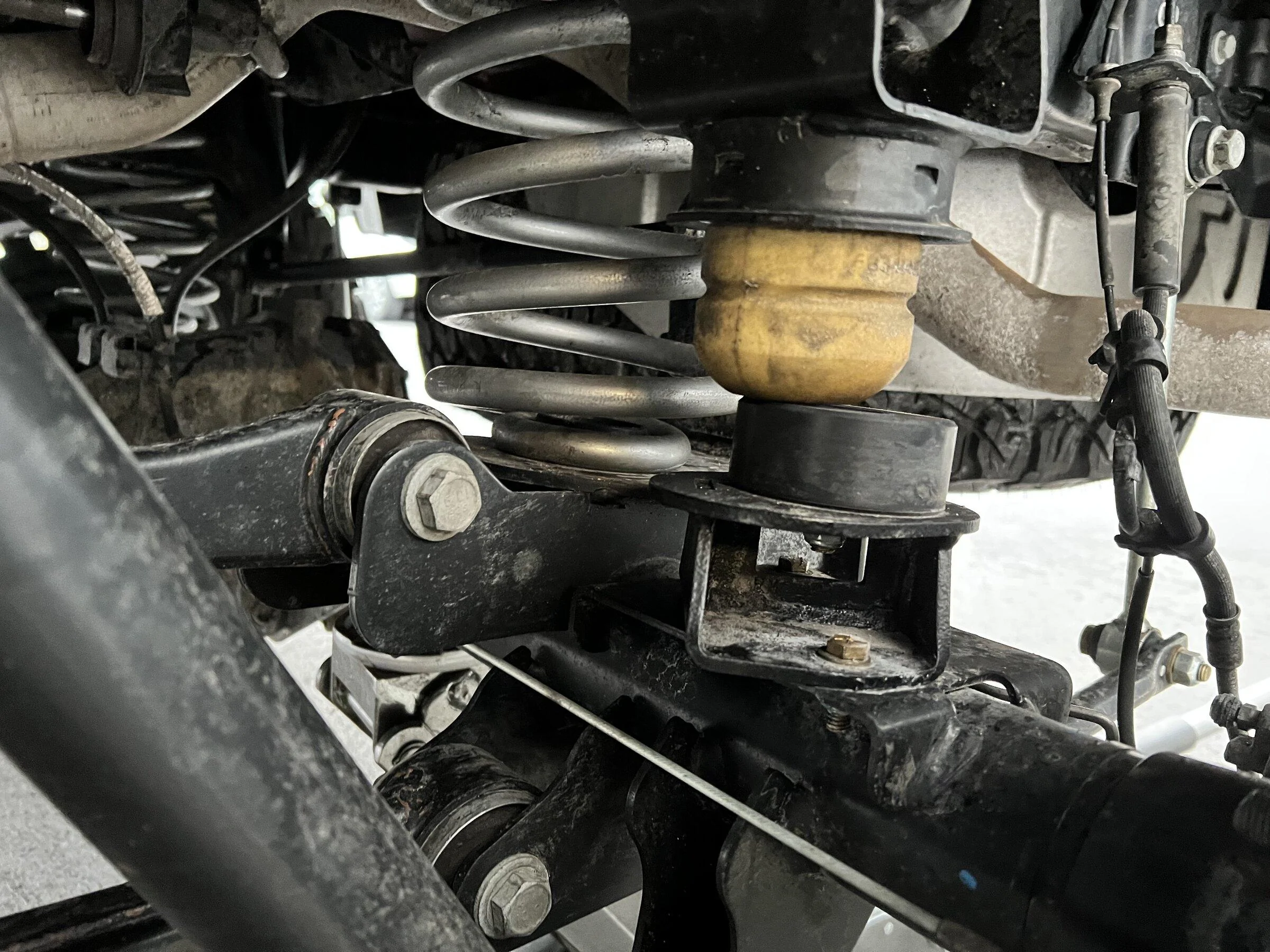

since the gladiator isn't really designed to be a "truck" it's a Wrangler with a truck bed attached & the stock springs wont take the additional weight.
No this is not true, the gladiator is not a wrangler with the bed attached. The Gladiator is a real mid-sized truck (if you doubt this look at the bed load capacity and the tow ratings… all much higher than a Wrangler). This has been hashed out on here for… well since the beginning. The JT front suspension is like the wranglers but the rear of the JT is set up on the dodge 1/2 ton pickup truck platform. No, the JT is NOT a wrangler with a bed.
The issue you are having is caused by the lift manufacturers using a leveling approach to the gladiator. This should not be done IMOP because the gladiator is not a wrangler and has the rake due to heavier duty rear springs on the JT truck… because it is a truck meant to haul things.
So, taking those stock JT springs out meant for the load rating for the JT. Then adding a “leveling lift kit” (whether they say they are doing that or not, most aftermarket lift kits do). This approach leaves you with springs not rated for the trucks factory load rating in most cases.
I have the Max Tow, and never had an issue with loads and even towing up to 6500lbs with the stock suspension (and with 500lbs in the bed).
Now with the 3.5” Rubicon Express lift, it has literally become a negative rear lift from stock height and is about 1” below stock height (originally the RE lift had an incredibly smooth ride for the first 2 months and it was level… I told the shop that recommended the lift and they ordered it, that I specifically did not want a leveling lift kit. I wanted to maintain the JTs rear rake with HD springs for load the same as the stock springs. Well guess what? That nice ride initially after the lift was due to soft rated lift springs and leveling the truck. ?
So, you may ask, how can a lift of 3.5”go negative? Just as was mentioned previously, the rear springs on my JT started to sag and then the cheap shocks blew. Mine is only staying maybe an inch higher than stock because of the bump stop extensions that came with the lift. The ride is so bad and unstable that I have to get it fixed asap. I had to remove the RTT because the truck would hit a bump and suddenly start to ride like a donk… buh donky donk. The JT bounces do badly in the rear now that I have to slow down to get it to stop. This last trip without the RTT now has the thing back on the bump stops as the springs have sagged that much further. I am 600 miles from home base right now! ?
I made the mistake of driving away with the JT not set up for its truck purpose. So now I’ll replace the rear springs and get some better shocks on all 4 corners… maybe replace the whole 5 month old lift.
The pictures are with 250lbs in bed, a 180lb XXL James Baroud RTT on the rack, bed rack and a hard bed cover made from 3/4 marine plywood. No where near the stock bed capacity of 1600lbs. With 180 lbs high in the rack, the drive was scary.

Thanks for the explanation, I wouldn’t have thought a lift kit springs etc. would be inferior to stock. I figured the stock springs wouldn’t handle it either. I had installed the JKS venture 3-3.5 lift kit with fox performance shocks a few months back. It’s a fairly level kit from front to back when it was first installed. Today there was an inch difference on mine. So sounds like they may have caught it in time before the bad things you had mentioned occurred. It sounds like installing the Ram 1500 springs will return it to factory specs for the rear, matching to the new lift height, now I think I understand why they recommend it.
