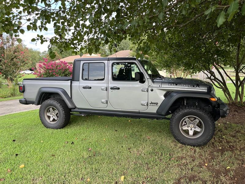

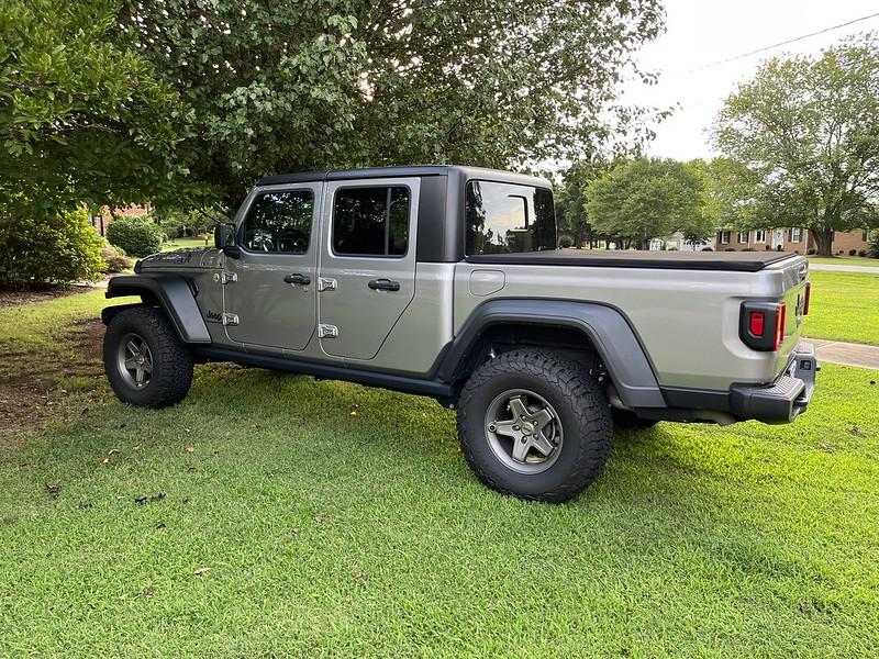

Ask, and ye shall receive. Just installed a set of JK Pintler wheels with BFGoodrich 315/70R17 about two weeks ago - lift is from Mojave springs, plus Rough Country 2.5" spacers up front, Daystar 3/4" spacers in the rear:
Jeep Gladiator Wheels question - JK wheels on a JT 52261626815_51d84edc04_c
Jeep Gladiator Wheels question - JK wheels on a JT 52260172522_f4899f8510_c

Different part numbers on the AEV website, may just be due to the different size lug nuts from the JK. At one point there was also some discussion about differences in the lug nuts shoulder angles, don't know if that was determined to be an issue or not.

I like those. I have a Sting Ray, so similar color and those look nice on that color.
Any issues with rubbing when fully flexed? Also did you use the stock lugnuts?

No issues with rubbing as of yet. The stock lugs were a no go though - had to get smaller splined lugs.
