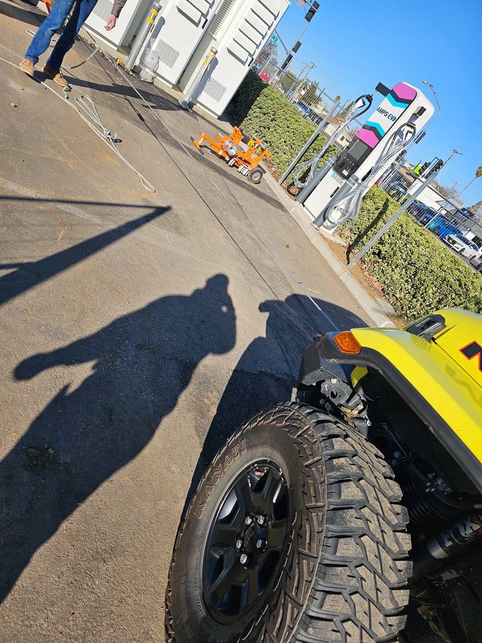

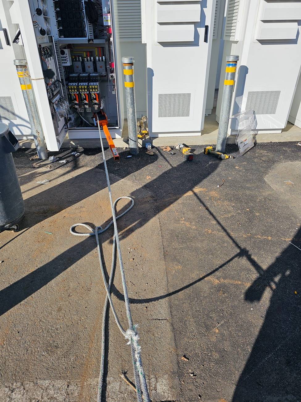

It was plenty sturdy enough to snap the 1/2" pull rope after we broke the 10k pound tugger without the slightest deflection. We were pulling hard enough that the Jeep was sliding forward with all 4 tires locked up on dry pavement. That rope has an 11k pound break strength and we snapped it several times. Weird how only after Jeep introduced their fake "winch ready" bumper that requires a separate winch plate did anyone start the crazy thought process that my winch shouldn't put any stress on my front bumper. For 80 years most winches on most vehicles were bumper mounted. If you buy a poorly designed bumper sure you might twist it in a hard pull but every winch plate I've ever installed also bolts to the front frame horns so the idea that the stresses are somehow different because it's a separate piece mounted to the same location (yes they have extra bolts through the frame, but it's not like they aren't mine to the bumper studs) is lost on me.
Jeep Gladiator Rubicon oem steel bumper on Mojave 20250211_091056
Jeep Gladiator Rubicon oem steel bumper on Mojave 20250211_091109
Note it's not under full tension in the pics and everyone was clear and I had a winch blanket over it when pulling.
