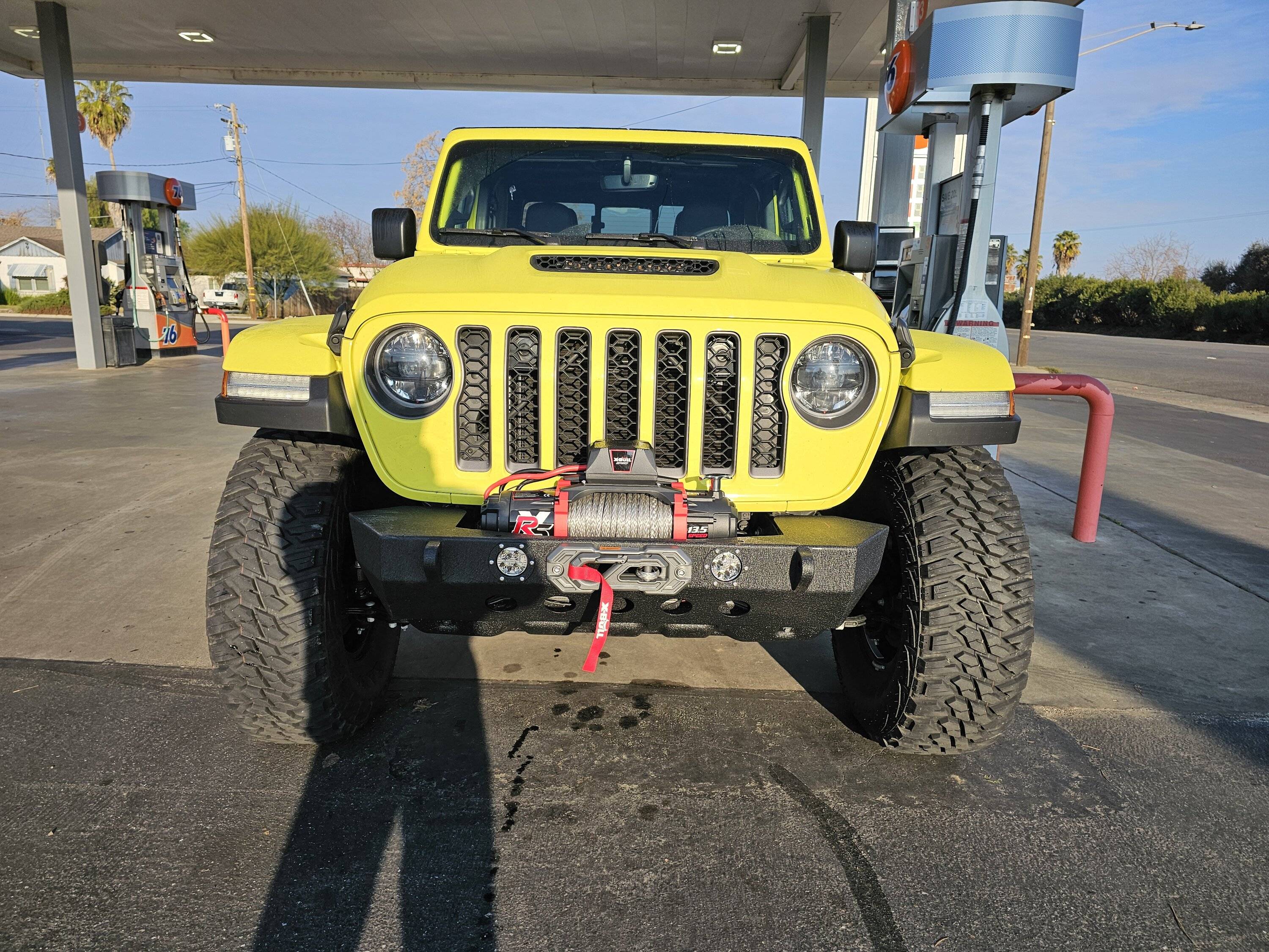

Jeep Gladiator Rubicon oem steel bumper on Mojave 20231225_085432
I bought a warn winch and warn winch plate. The built in winch plates on many many bumpers are not engineered well and put too much stress in wrong place. The winch plate should be designed to protect the frame ends and put little or no stress on the bumper. The warn does so based on my research.
I agree to a point, if you're running the stock sheetmetal "steel" bumper. You're stand alone winch plate shouldn't put any stress on the stand alone bumper, and if it does its bending. Now on an aftermarket bumper that is built around and welded to the winch plate it is all one integrated component and in my opinion far stronger than just a winch plate with sheetmetal bumper facia. The stock bumper isn't strong and open tow hooks are a safety hazard in comparison to proper shackle mounts. That being said, we do run the factory steel bumper and hooks with a winch plate on the wife's 2022 JLUR as it came with the steel bumper. There's 0 chance having installed winches on both that the front bumper on the mojave isn't stronger by comparison. Once you factor in the winch plate the weight is probably the same. There's no way I would go out and spend the money on the steel bumper and separate winch plate to mount a winch on a JL/JT. There are much better options for less in my experience. Sure you can upgrade to proper recovery loops aftermarket too, but now you're pushing $1,200-1,500 into a hodge-podge of parts. Even the factory bumper and winch plate would be obviously stronger as a system if they were welded together, but that kinda defeats the sales pitch of "winch ready" bumper... that isn't actually winch ready.
