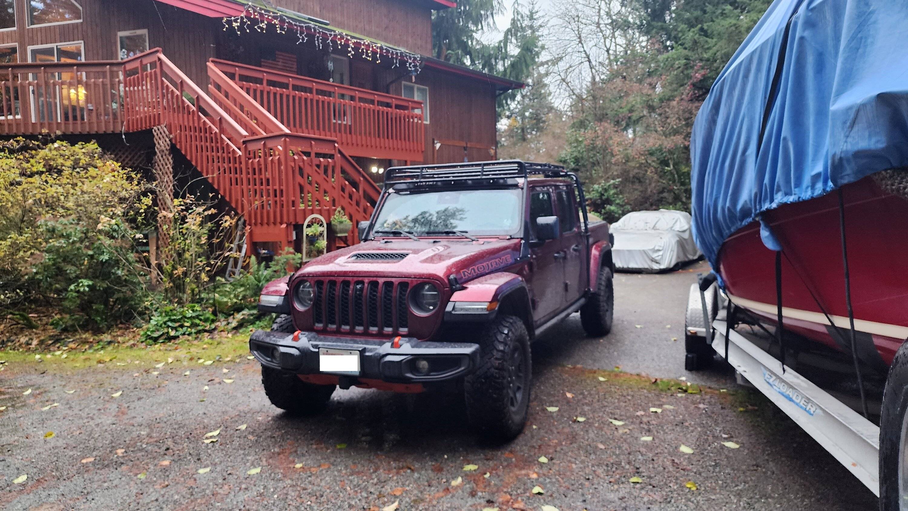

Yeah, that's why I went with a front receiver hitch and 8k winch on a Hitch plate. The winch rides in the bed under the tonneau cover until needed and then only when heading out into the wilderness. The stock tires/suspension does what I need it to do.

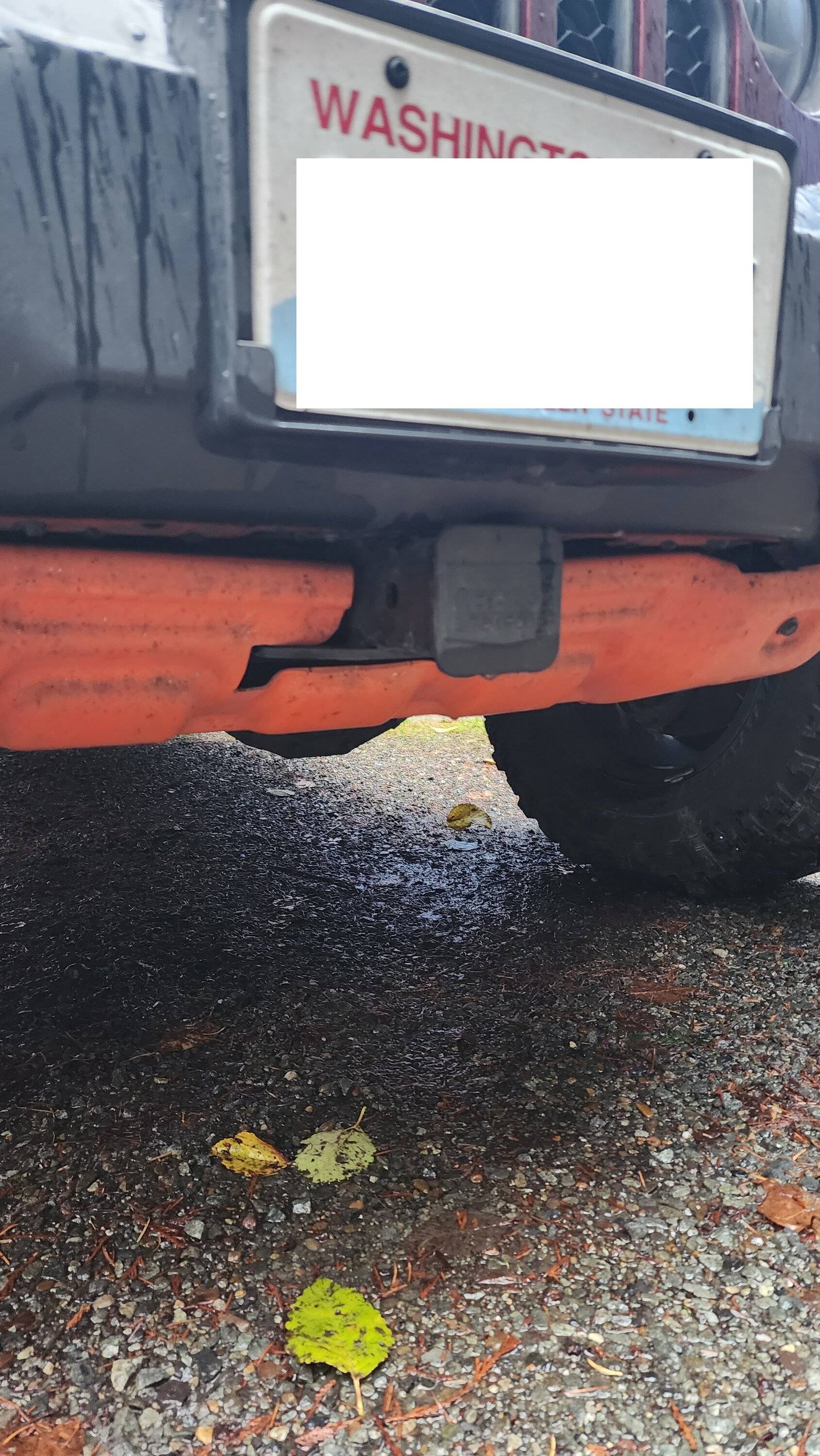

Yes! But only outside pics, I didn't take any during the install and its too tight to get my camera up behind the brush guard. I purchased a Curt Trailer Hitch #31086 from Autozone. I did have to remove the shock resevoir mounts and notch/trim them and reinstall so the hitch would fit. Also notched out the steel brush guard for the Hitch.

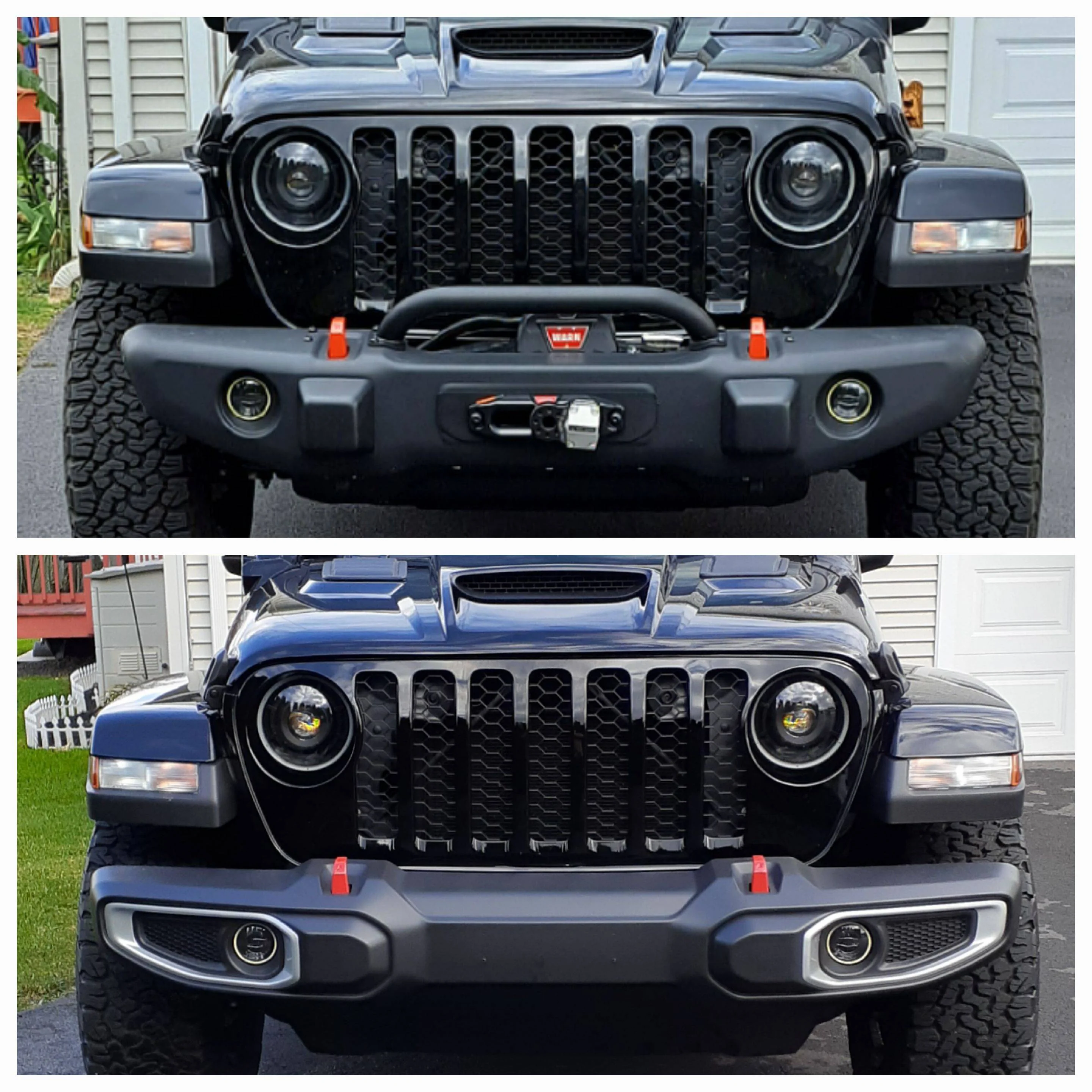

I just replaced the plastic bumper on my 21 Sport S with a Mopar Performance off road bumper pn#8221569AD
Mopar grill/winch guard.
Mopar steel skid plate
Mopar winch plate
Warn evo10s winch
All that added a lot of weight to the front end so I added Teraflex 1 inch spacers to bring the front end back up a little.
It rides exactly the same.
I may add another spacer.

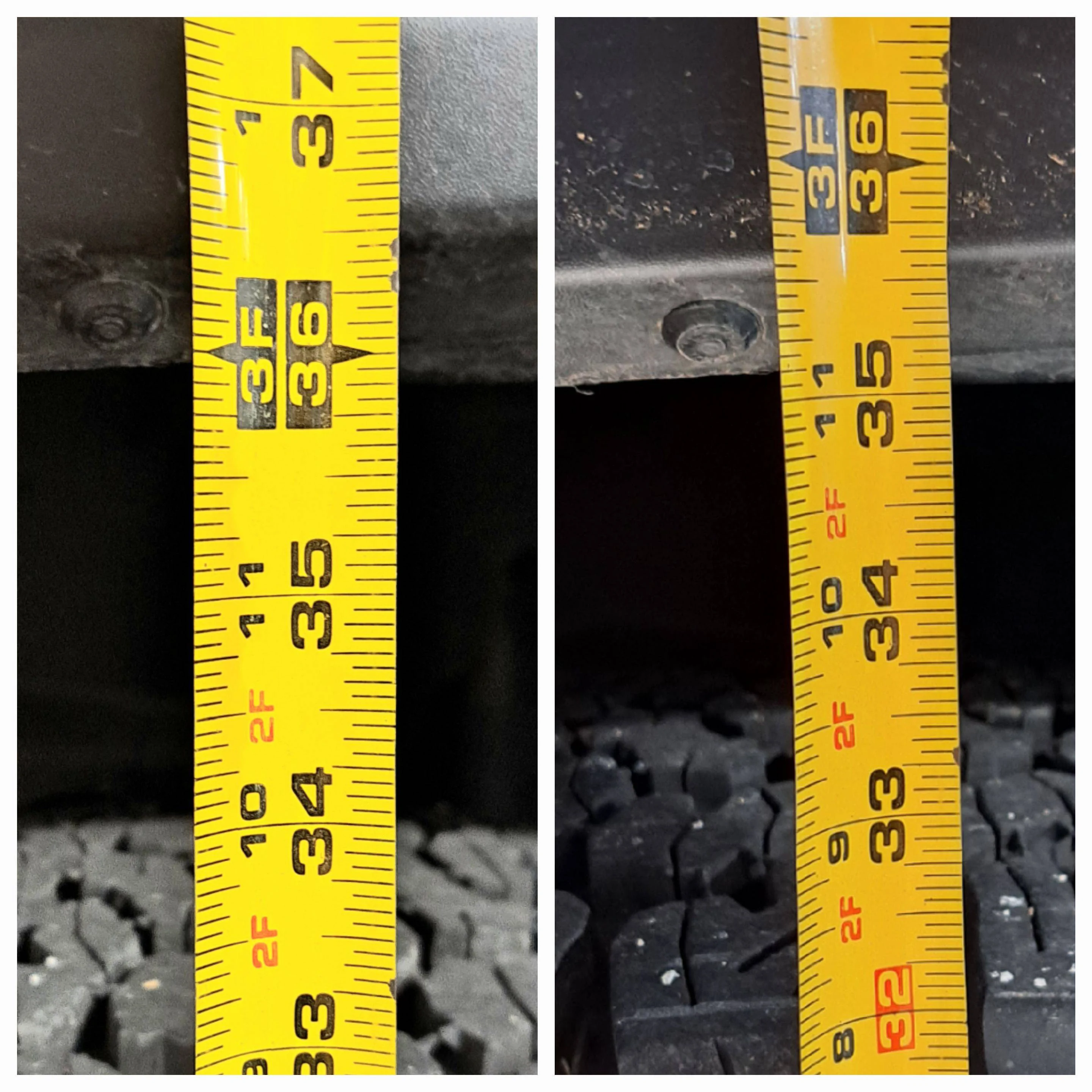

Not sure if you added the steel bumper or not but that is about a 60lb difference from the plastic bumper. Depending on the winch plate you added that's another 35-40 lbs. The Warn Zeon 10s is about 100 lbs. It's probably got your suspension sitting in a compressed position since it's not been engineered for the added weight.
I added the same winch and the Warn plate, (I already had the steel bumper off the lot), and it took a 1/4" out of my front end. I run the AEV 2.5" lift kit and it's designed for that weight to be there. Stock suspensions are not designed for that purpose.
