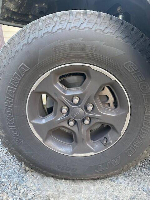

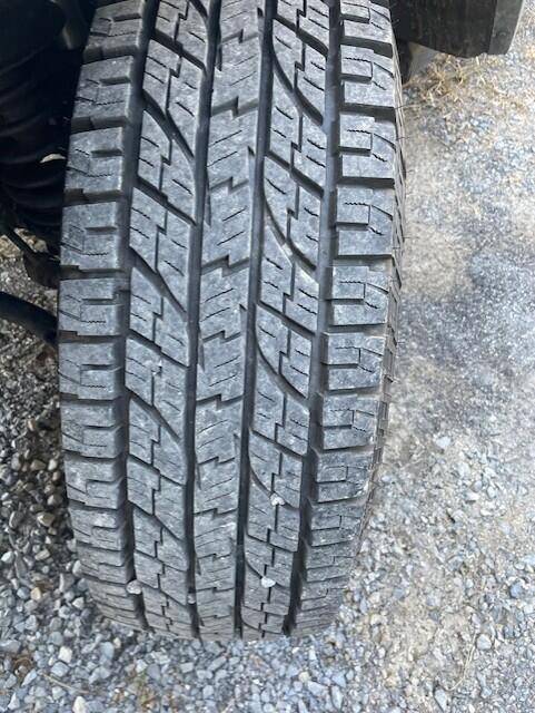

MPG? You need to find Matt's (Gren71) research on tires. Goes back a few years.
I have a stock height 2020 Rubicon automatic running 285/75/R17 (33.9" tall)Yokohama Geolander's and get 19.5 mpg with mixed driving. Highway trips I am above 21 mpg. That is without recalibration. Again, more of a highway tread than a 'true A/T' but would do okay on trails. The 10 ply rating would take some abuse.
