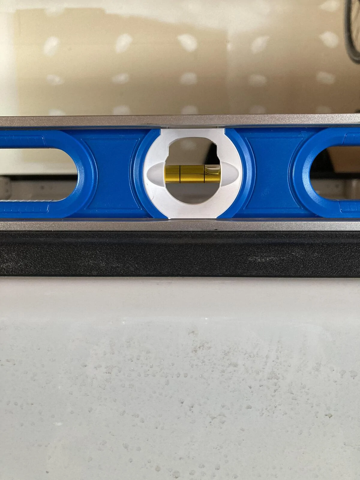

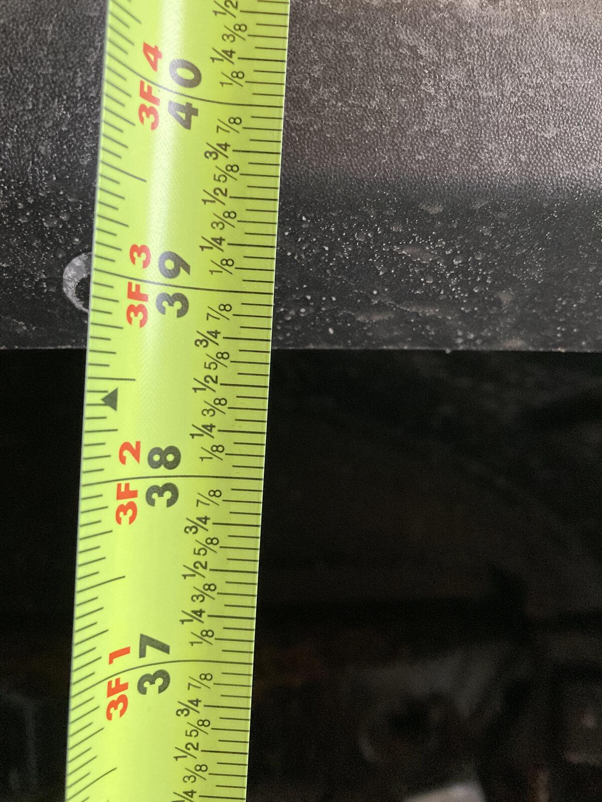

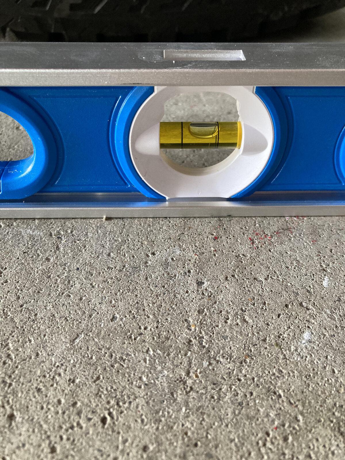

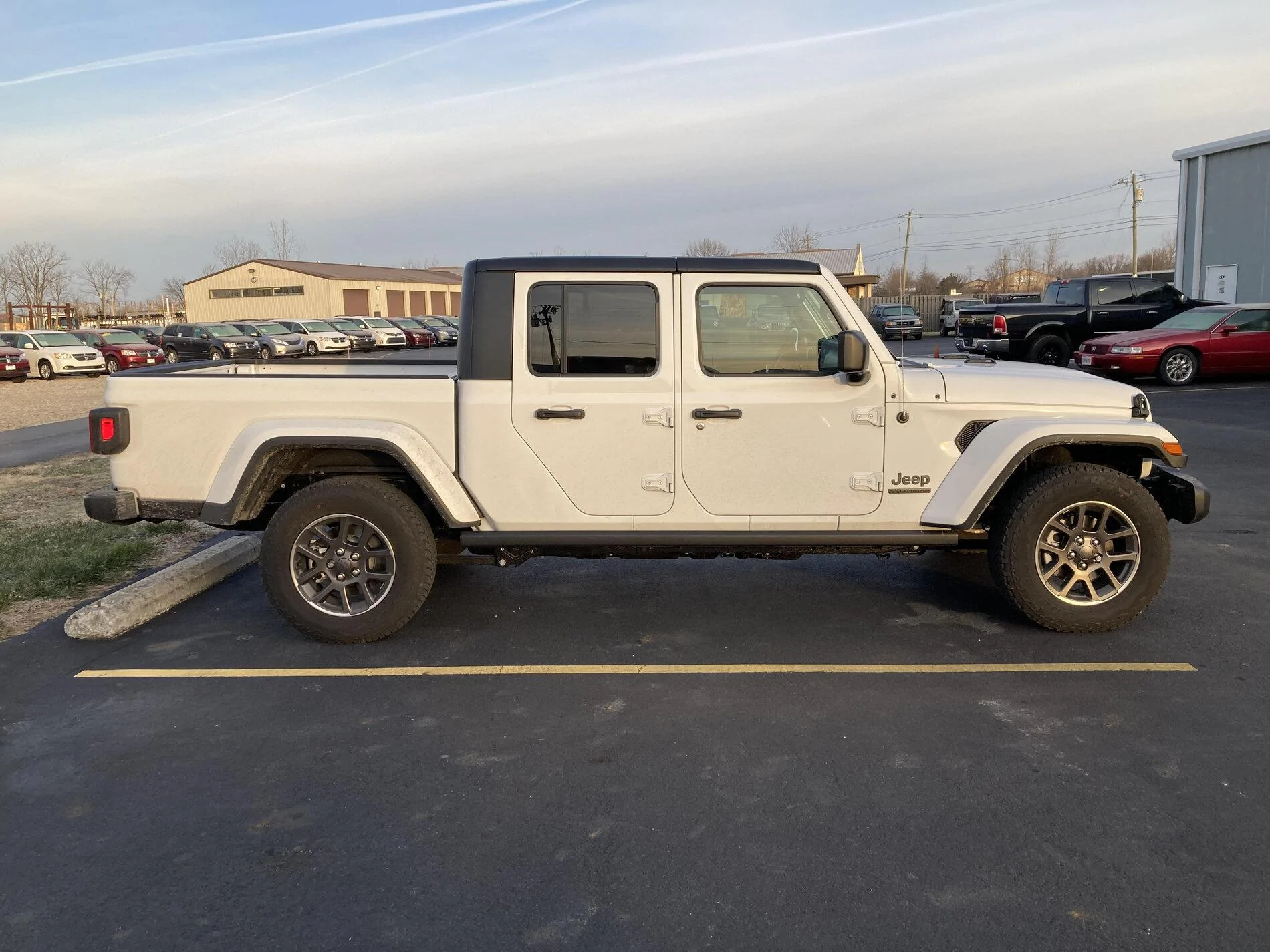

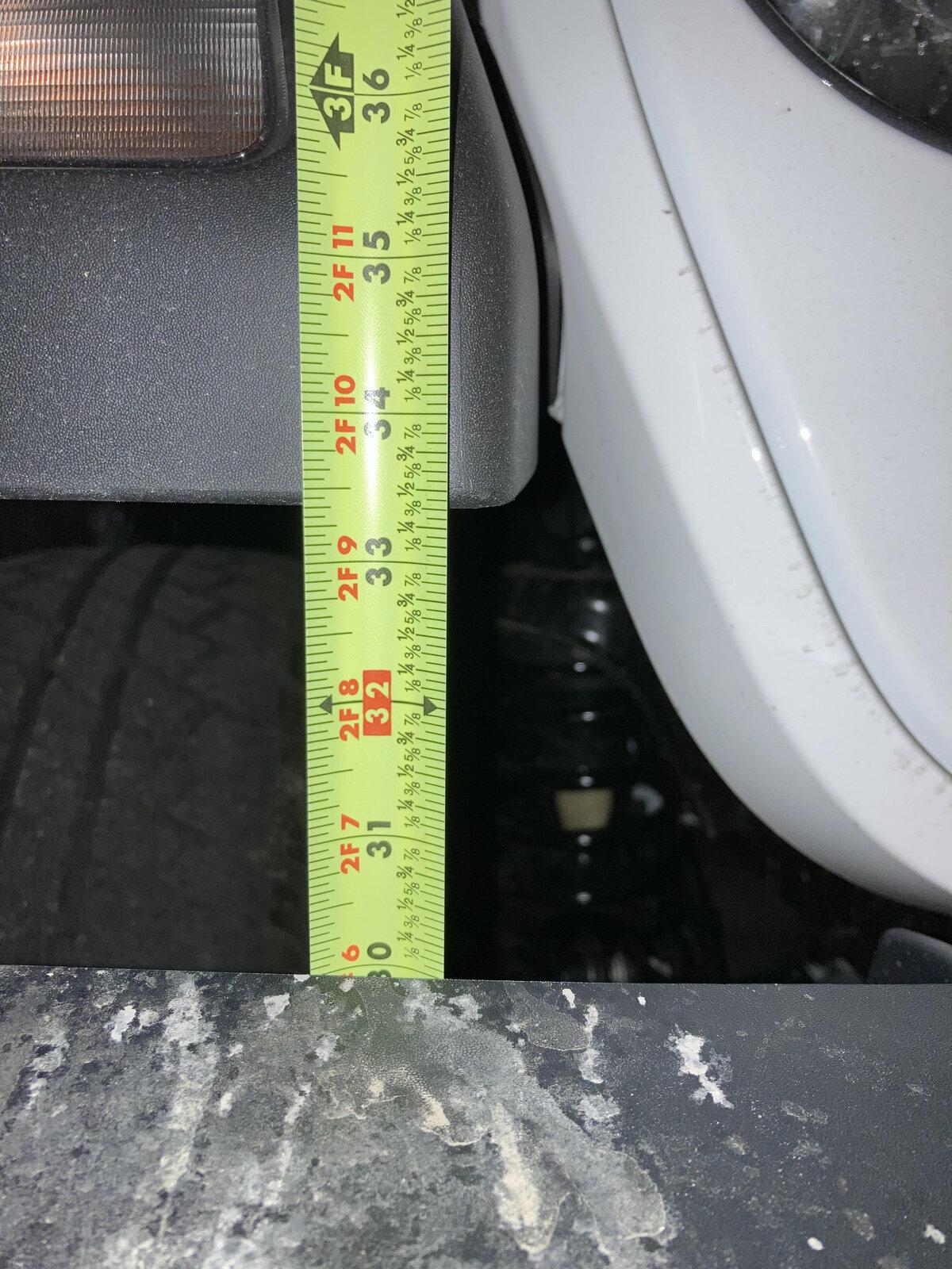

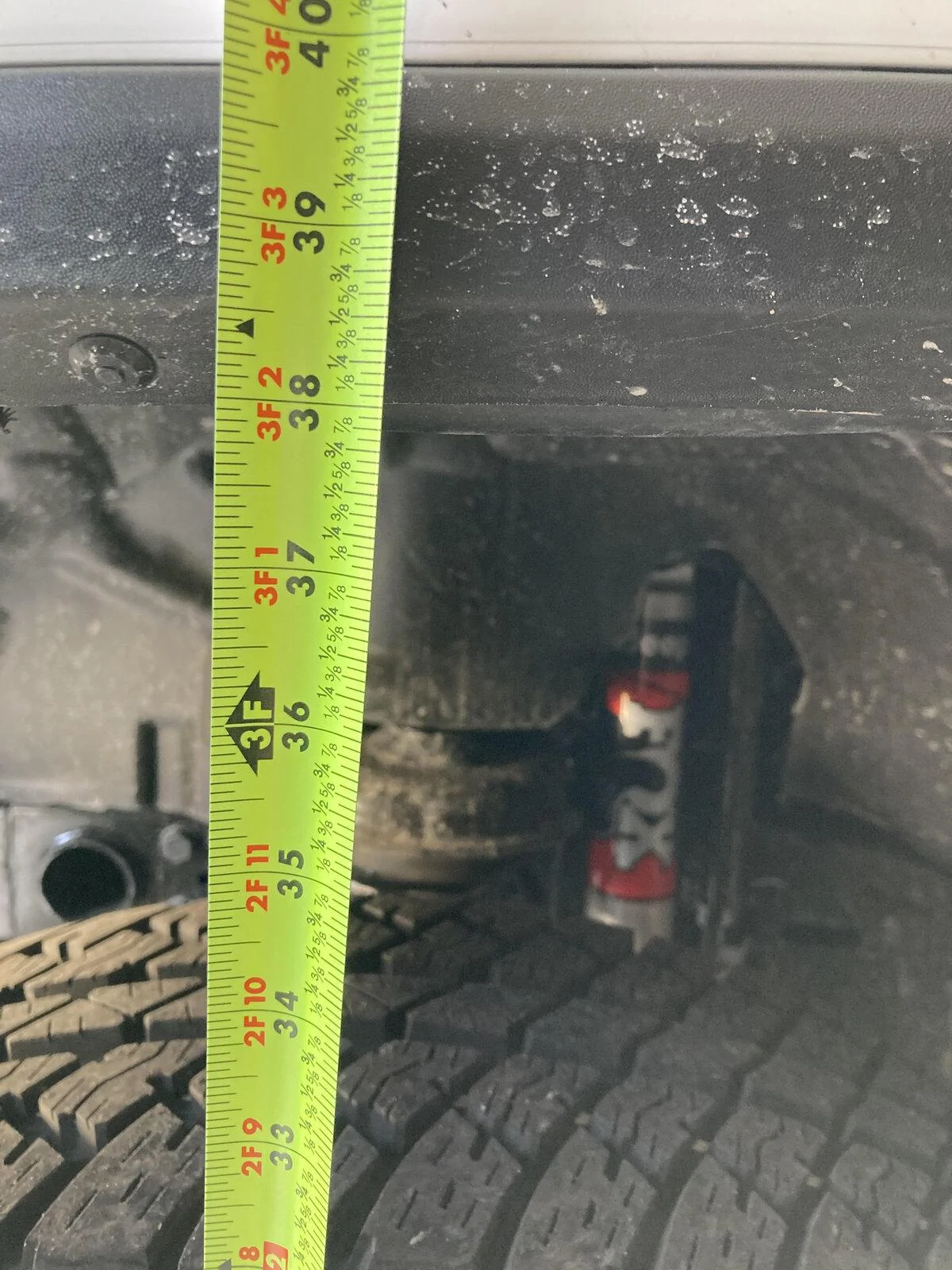

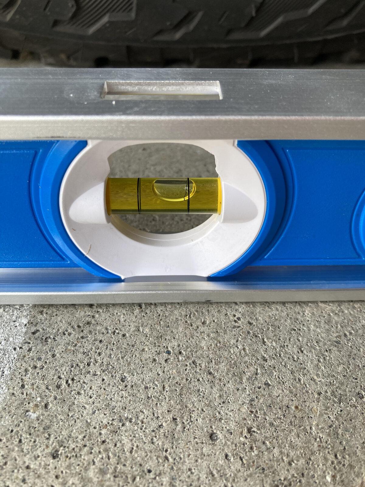

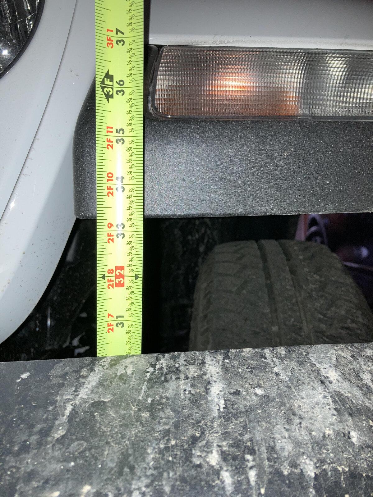

So I just had my swap done, 80th Ann. to Rubicon shocks/ springs with the 1.5" teraflex level kit. Here are the photos to show the stance before and after w/measurements. Mine seems to be a inch (ish) higher in the rear after everything.
Before-
Jeep Gladiator Rubicon to Sport S suspension swap before
After-
Jeep Gladiator Rubicon to Sport S suspension swap after
Garage floor level rear-
Jeep Gladiator Rubicon to Sport S suspension swap level
Garage floor level front-
Jeep Gladiator Rubicon to Sport S suspension swap GF
Front measurements-
Jeep Gladiator Rubicon to Sport S suspension swap F
Jeep Gladiator Rubicon to Sport S suspension swap FR
Jeep Gladiator Rubicon to Sport S suspension swap FL
Rear measurements-
Jeep Gladiator Rubicon to Sport S suspension swap R
Bed level-
Jeep Gladiator Rubicon to Sport S suspension swap bed
Before-
After-
Front measurements-
Rear measurements-
Bed level-
first time i've seen a level in these types of photos, i like it!
Before-
After-
Front measurements-
Rear measurements-
Bed level-
I don't know how helpful it is but I was hoping someone would comment and say, "Ya that looks normal or mine also had a inch in the rear". Idk I thought the truck would be perfectly leveled but I can live with the slight rake
Looks great!

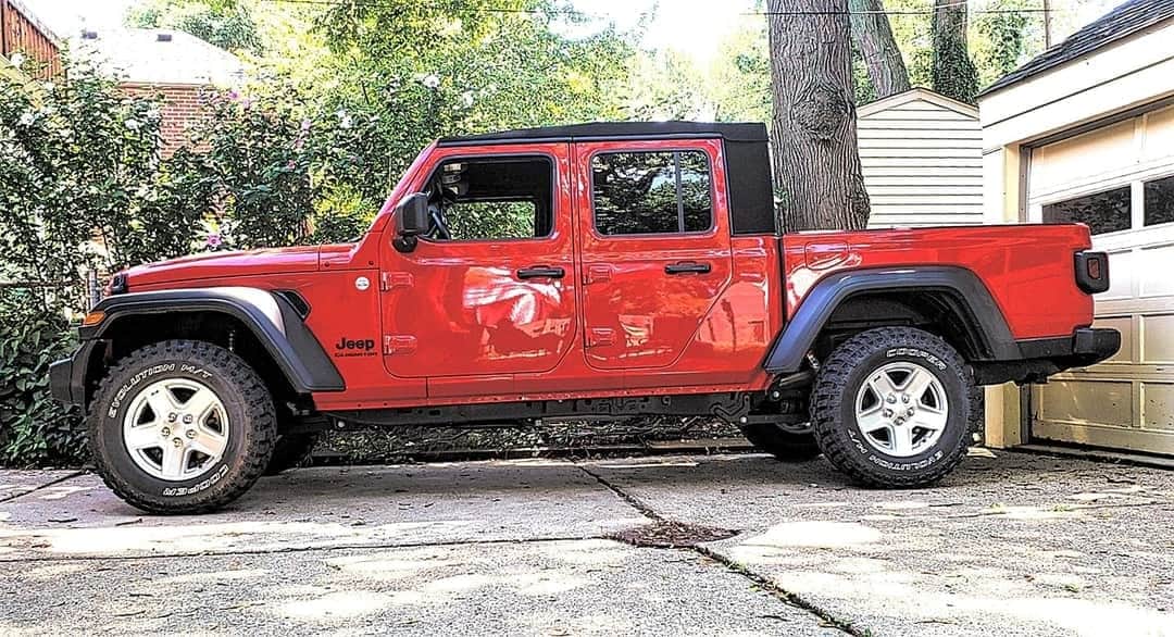

Got 1-1/4" in the back and 1-1/8" in the front when I did mine, couldn't be happier with it. Mine is a Sport S, I hear people say the ride on the Overland is pretty nice, not my experience with the Sport. The swap has been the best bang for the buck so far for me, the cost against the improvement in ride cant be beat.
Enjoy it!
Enjoy it!
Jeep Gladiator Rubicon to Sport S suspension swap FB_IMG_1595889063743
I agree the ride has definitely improved with the Fox setup and aesthetically it does look better. You cant really notice the difference so overall im happy with the stance. Now I need to decide on 35s and Rubicon wheels or aftermarket wheels. I wonder if the hardtop vs softtop is the difference in height for you, either way looks good! Worth every penny
Yup, Jeep has like 7 different spring rates for the trucks (dont quote me on the exact # lol), so that's probably the difference. I think your wheels look great, I'd throw some 33s on it and call it good!
