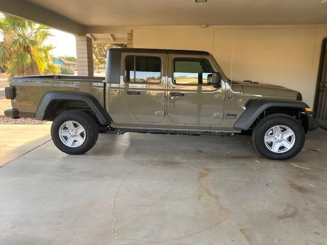

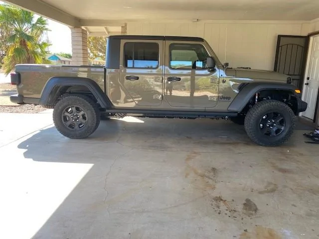

I did do it myself. I swapped out the stock shocks for the Rubicon shocks, swapped the front coil springs but kept my max tow rear springs. I put a rough country 2 1/2" leveling kit on the front and 3/4" spacers in the rear to keep some of the rake for payload. I also swapped out the factory rims and tires for a set of Mojave takeoffs.
Jeep Gladiator Rubicon to Sport S suspension swap glad mod
Jeep Gladiator Rubicon to Sport S suspension swap glad stock
Looks great, nice work!
