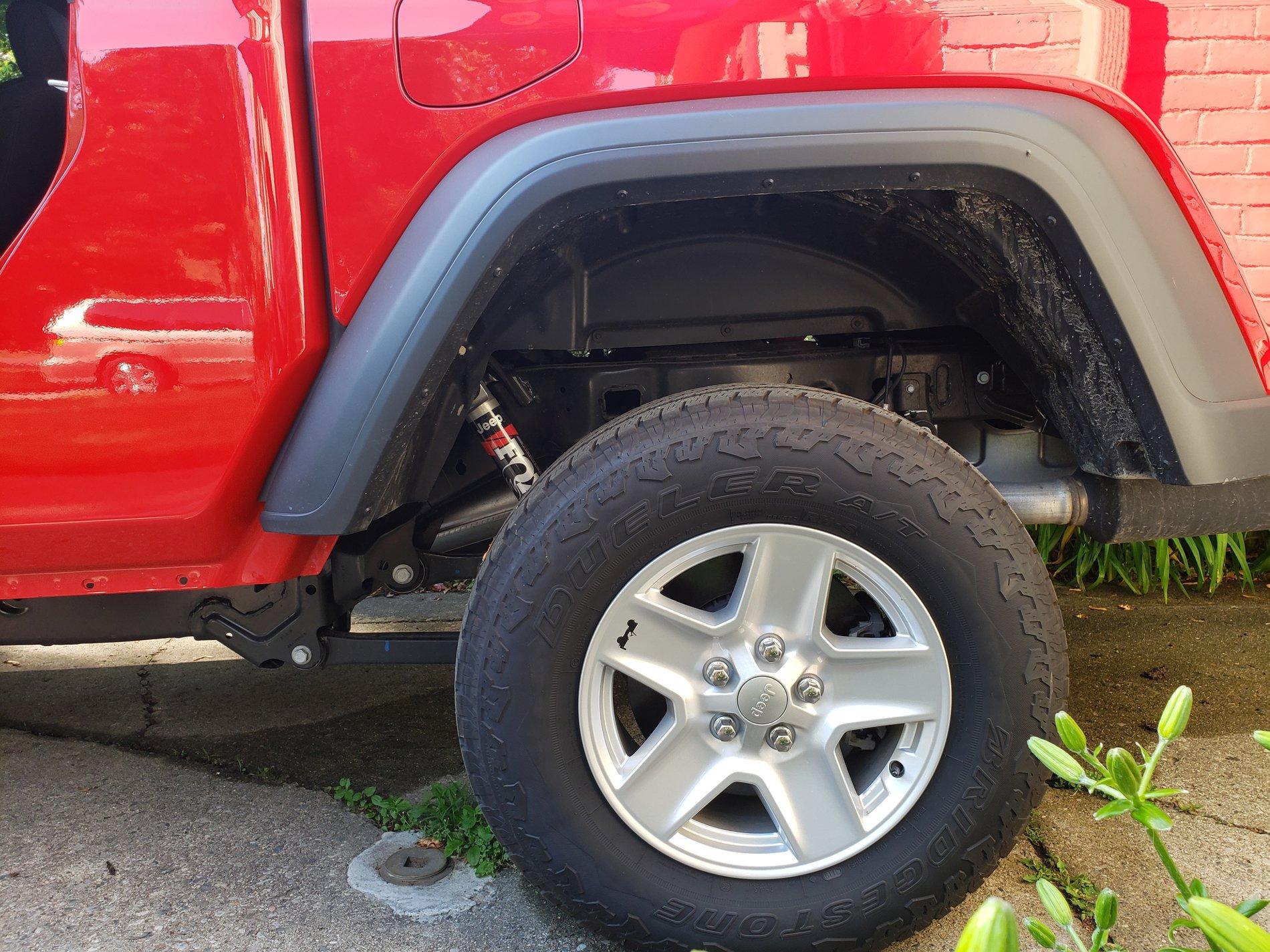

Well, that's what happened.
We measured before, and after from the bottom of the wheel (not tire) to the bottom of the fender. The diameter of the wheel didn't change, nor did the position of the fender on the body, the only change was the suspension. When we dropped the truck off the lift and it was back on the ground you could immediate see it. The amount of lift you get from this swap isn't an "always this amount" situation. Jeep doesn't have one set of springs for each model. My springs came off a hardtop steel bumper truck, and I have a soft top Sport S. If I had gotten the suspension from a soft top plastic bumper truck and installed it on a hard top model Sport I would have gotten less lift.
the truck my Rubi suspension came off was also factory hard top and steel bumper.
Your the only person I’ve seen reporting gains like that, nobody else even close especially with the rear. Mind posting a side shot of your truck?

If you dont put the Rubi rear springs on it might, but you wont know till you take it off the hoist. My Rubi take-off added 1 1/8th inch in the front, and 1 1/4th inch in the back, so mine would have looked much more level. You need to find a take-off set that works for what you want. If you're looking for the most lift you want to find take-offs from a steel bumper hard top. If you have a hard top and you get a take-off set from a soft top plastic bumper truck you might only get a half inch lift. The real reason, for me, to do the swap was for the quality of the ride, my truck was killing my back, it drove down the road like a circus bounce house. With the Rubi suspension it handles bumps and potholes much smoother, it also doesn't wonder like it did with the Sport S suspension, I can drive it now with out having to constantly correct the steering wheel. There isn't a lot of technical information in this forum on doing the swap, (being that our truck has only been out a year), but if you go to the Wrangler forums there are tons of posts with info on spring rates and model specs pertaining to the way the different models are optioned out and how it will effect the swap.
Good luck, whether it levels your truck or not I still recommend the swap!
Sorry your having a hard time accepting this, but it did what it did... why would I lie about this?
Signed - that one guy
Jeep Gladiator Rubicon to Sport S suspension swap 20200620_094059
