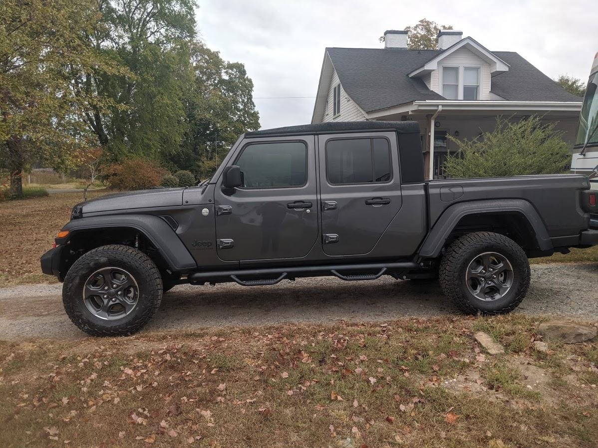

So I had swapped both springs and shocks out as others have. The first test ride my wife said it rode different. I could feel it also. After 2 weeks of her complaining I swapped in the rear MAX Tow springs. In another thread I also noted the difference of 1 more spring coil in the max tow. I equated that to the stiffness we lost. Since swapping back in the max tow spring it has ridden fine. I left the rubi front spring as it did appear the same just about 3/4" taller. I did install front and rear 3/4" daystar spacers and am happy with the stance and ride now.

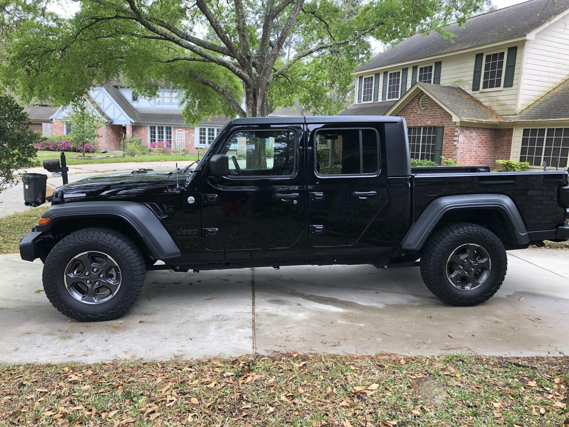

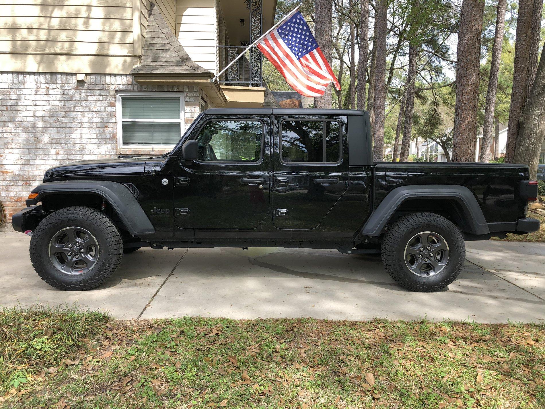

I did the rubicon suspension and wheels/tires swap on my max tow. Left the rear springs and replaced the front springs and all four shocks, along with rubi wheels and tires. Got 3/4” lift on the front. Looks perfect and rides 100% better than before.
Thanks @motorod for the parts and pointers on doing the swap.
Before (Stock suspension):
After (Rubi front coils, all four fox shocks):
Looks great!

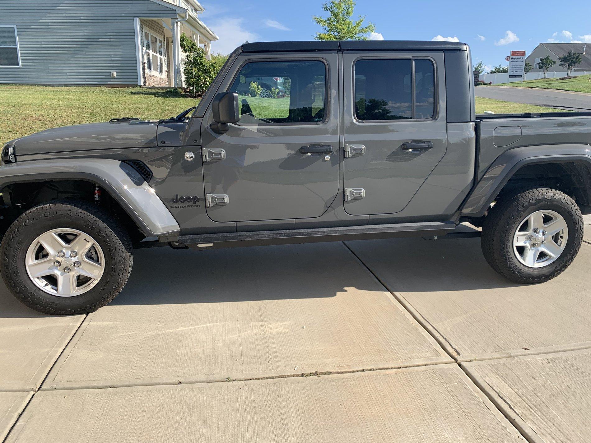

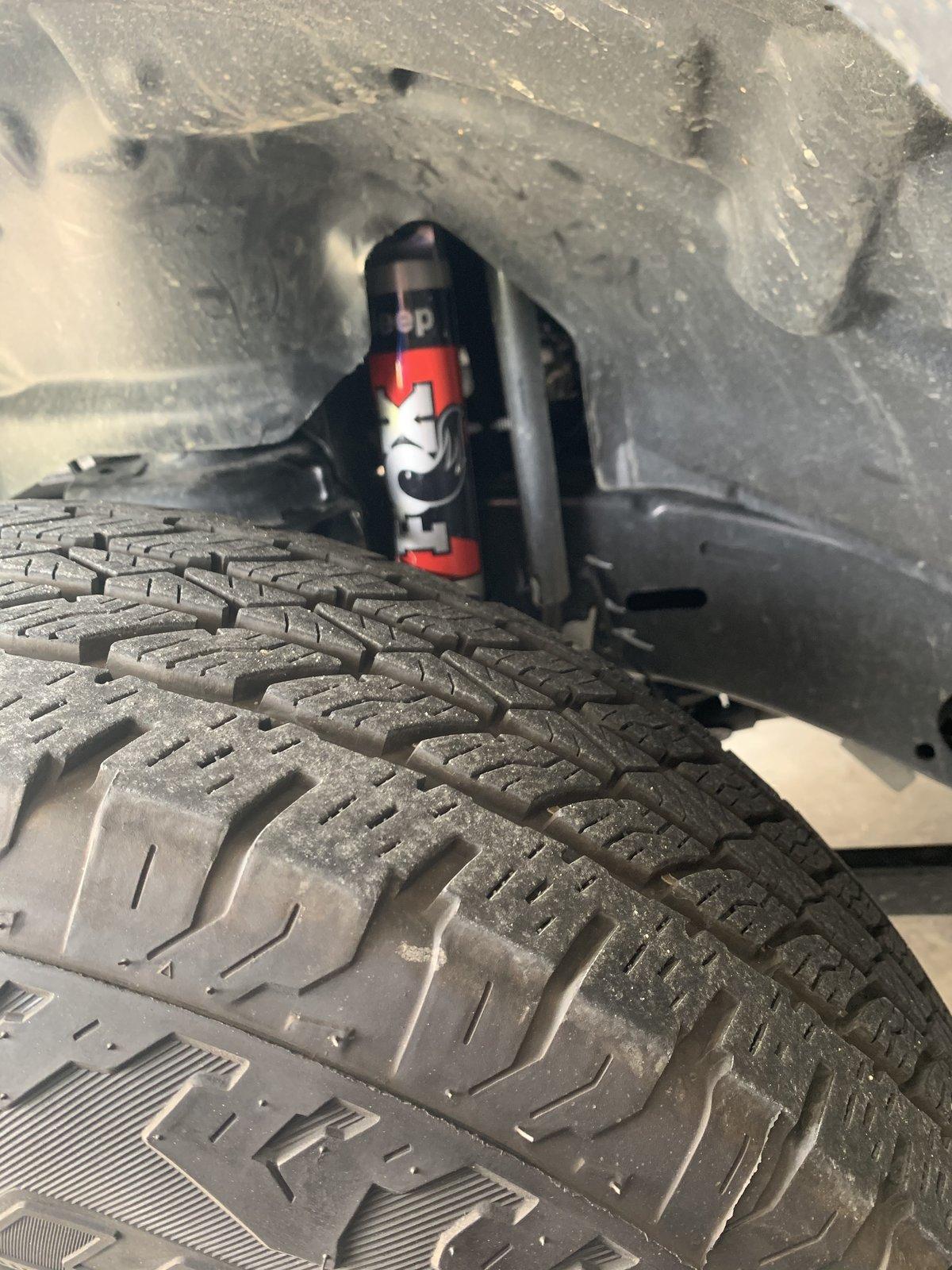

Picked these up yesterday, going on tomorrow. Well, the shocks and springs anyway.. putting on 285/75r17 tires next week.
Jeep Gladiator Rubicon to Sport S suspension swap FB_IMG_1590748320294

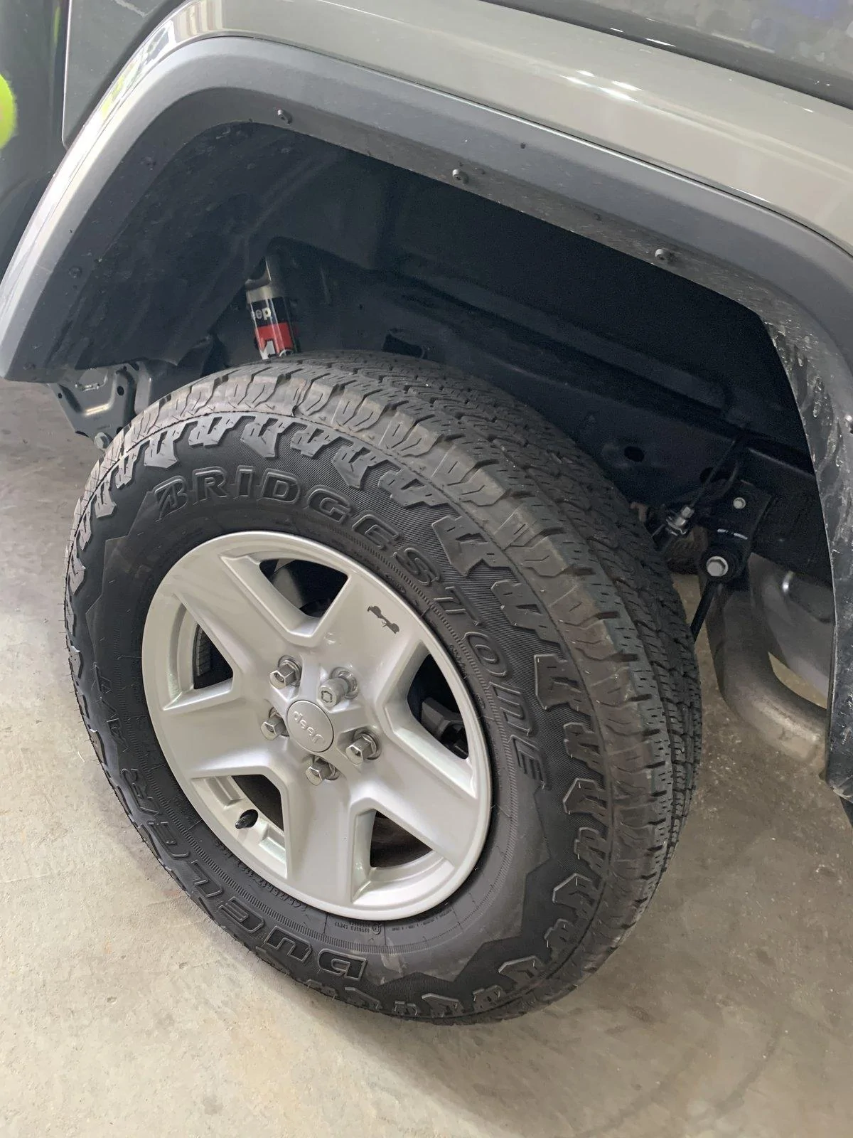

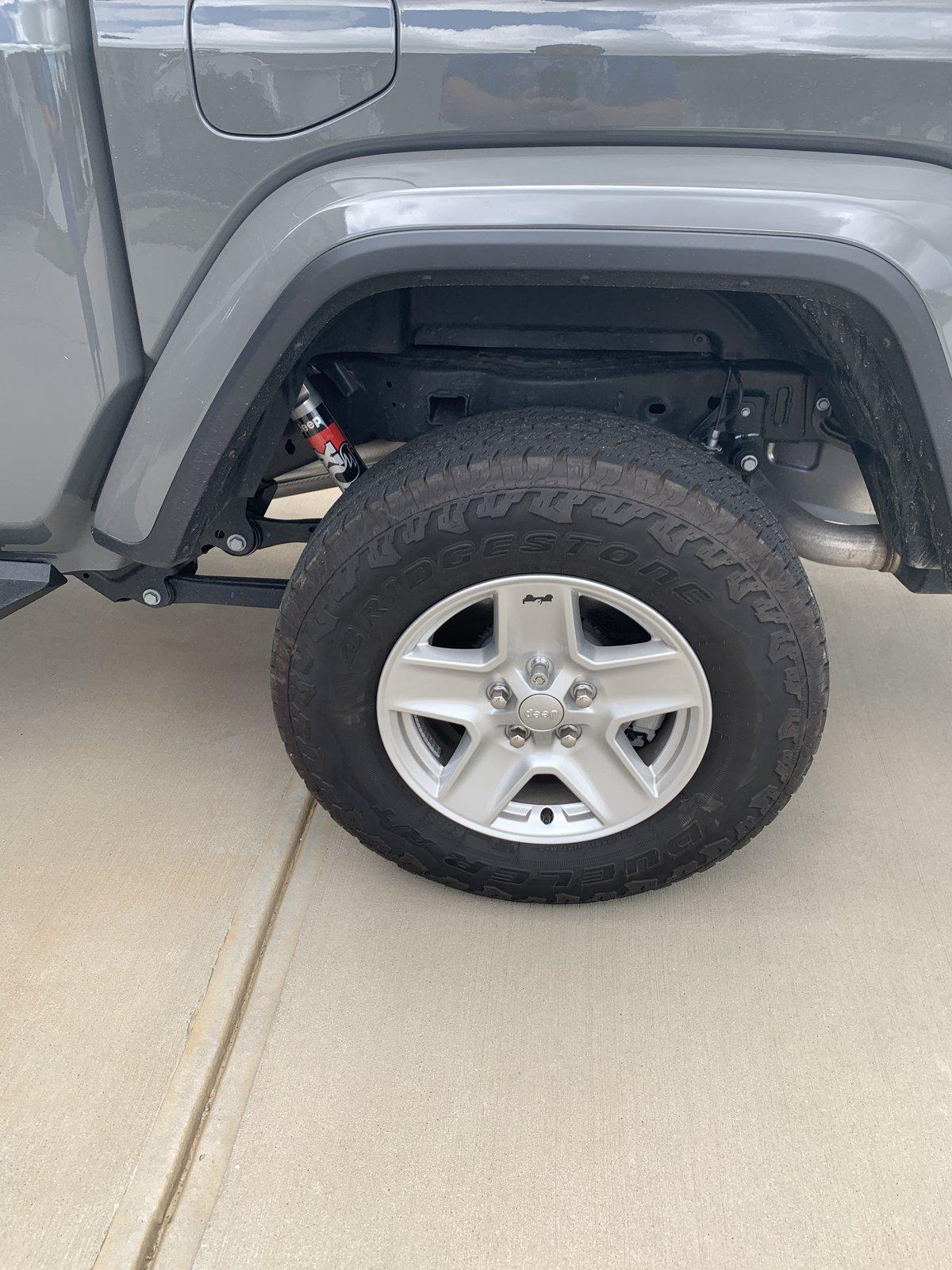

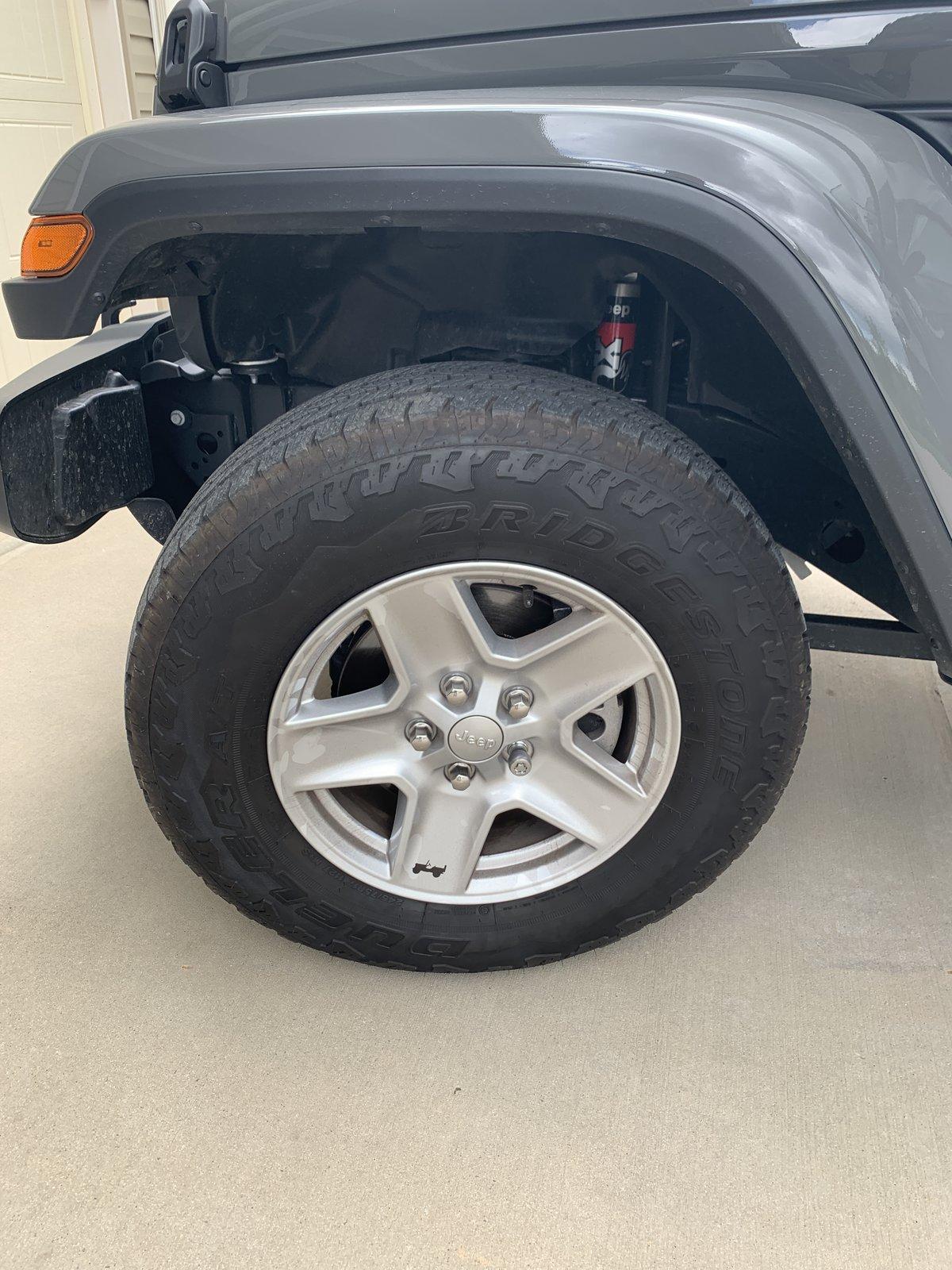

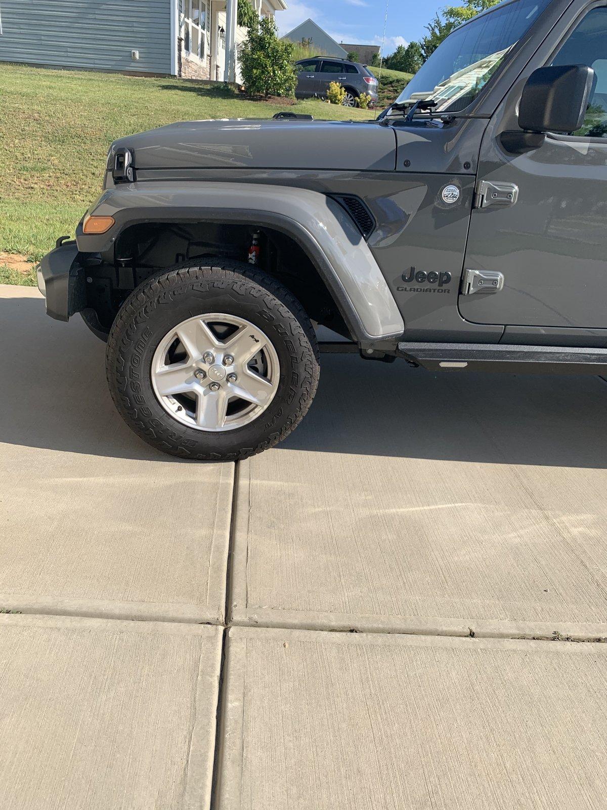

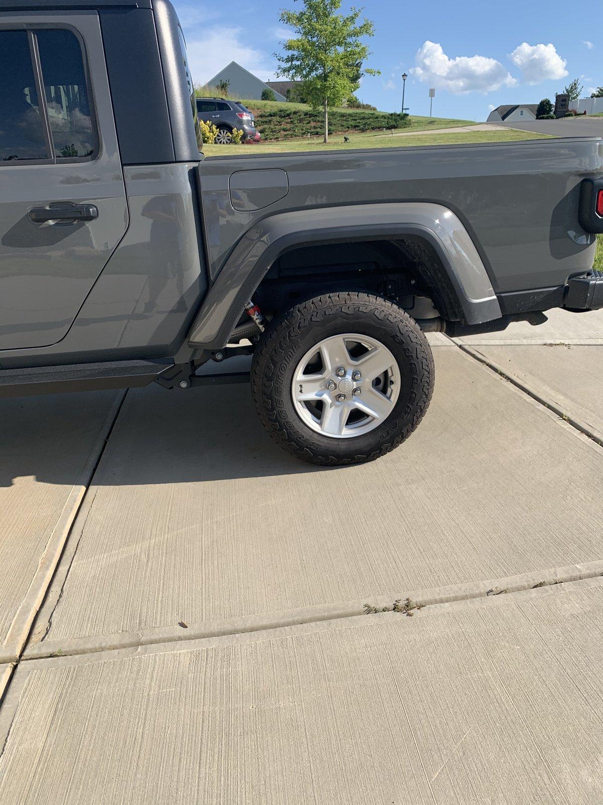

Just swapped out the springs and shocks on my non max tow sport s. Gained 3/4 of an inch in the front forgot to measure the back so can’t give an accurate number on that but it def looks higher. Rims and tires next.

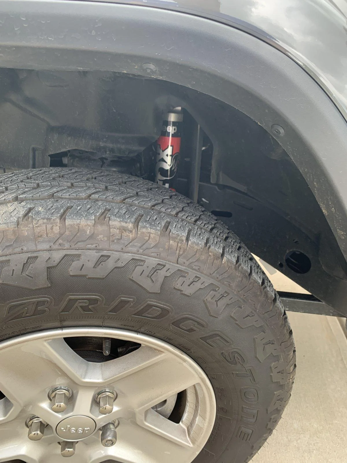

Jeep Gladiator Rubicon to Sport S suspension swap FB_IMG_1591994737727
Awesome, this is what I was looking for.....3 months later. That's why I love this forum. Thanks for posting pics with measurement.

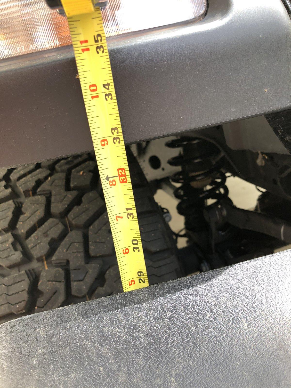

What is all of this? Rubicon take-off parts?
Yup! It lifted the front 1 1/8 inch and the rear 1 1/4 inch, but it's the difference in ride that makes it totally worth it!

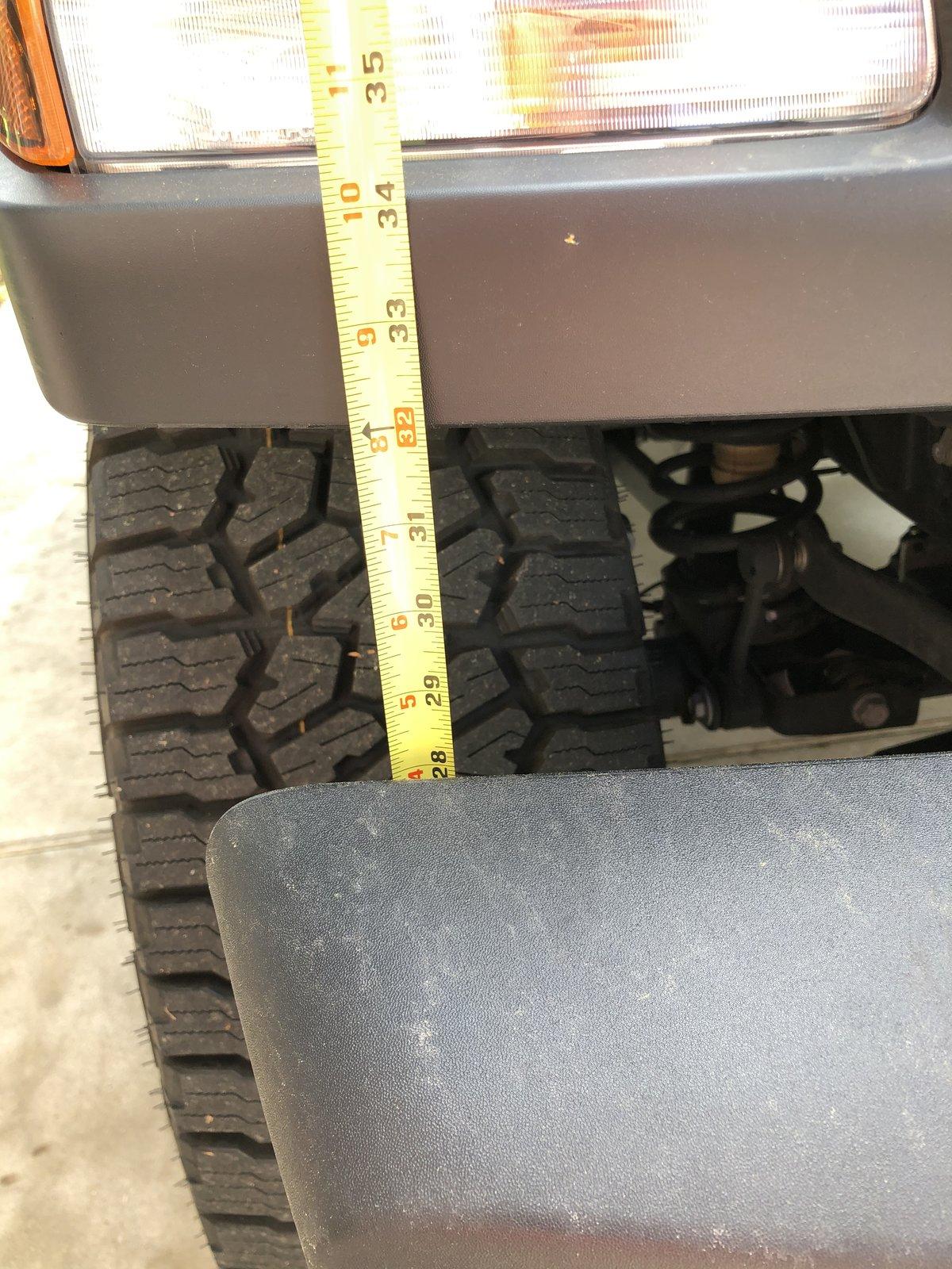

Got a 1 1/8 inch lift in the front and 1 1/4 inch lift in the back from the rubi take-off suspension swap.
This doesn't compute. The rear shouldn't of gotten any lift & the front is normally .75-1". Or was that including tires
Jack'D
Mar 20, 2020
79
107
(OIIIIIIO) Grosse Pointe Michigan
2020 JEEP Gladiator Sport S
Well, that's what happened.
We measured before, and after from the bottom of the wheel (not tire) to the bottom of the fender. The diameter of the wheel didn't change, nor did the position of the fender on the body, the only change was the suspension. When we dropped the truck off the lift and it was back on the ground you could immediate see it. The amount of lift you get from this swap isn't an "always this amount" situation. Jeep doesn't have one set of springs for each model. My springs came off a hardtop steel bumper truck, and I have a soft top Sport S. If I had gotten the suspension from a soft top plastic bumper truck and installed it on a hard top model Sport I would have gotten less lift.
