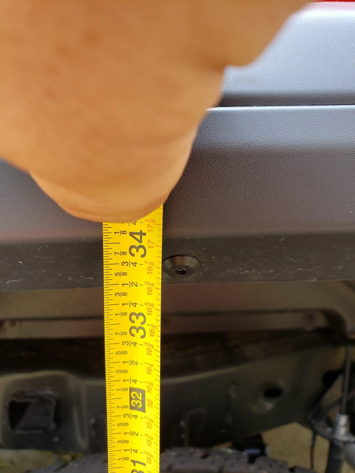

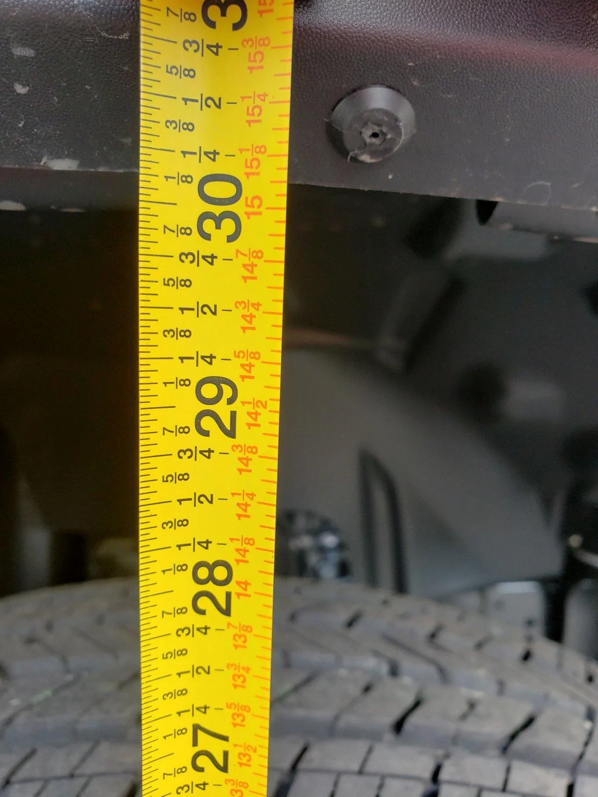

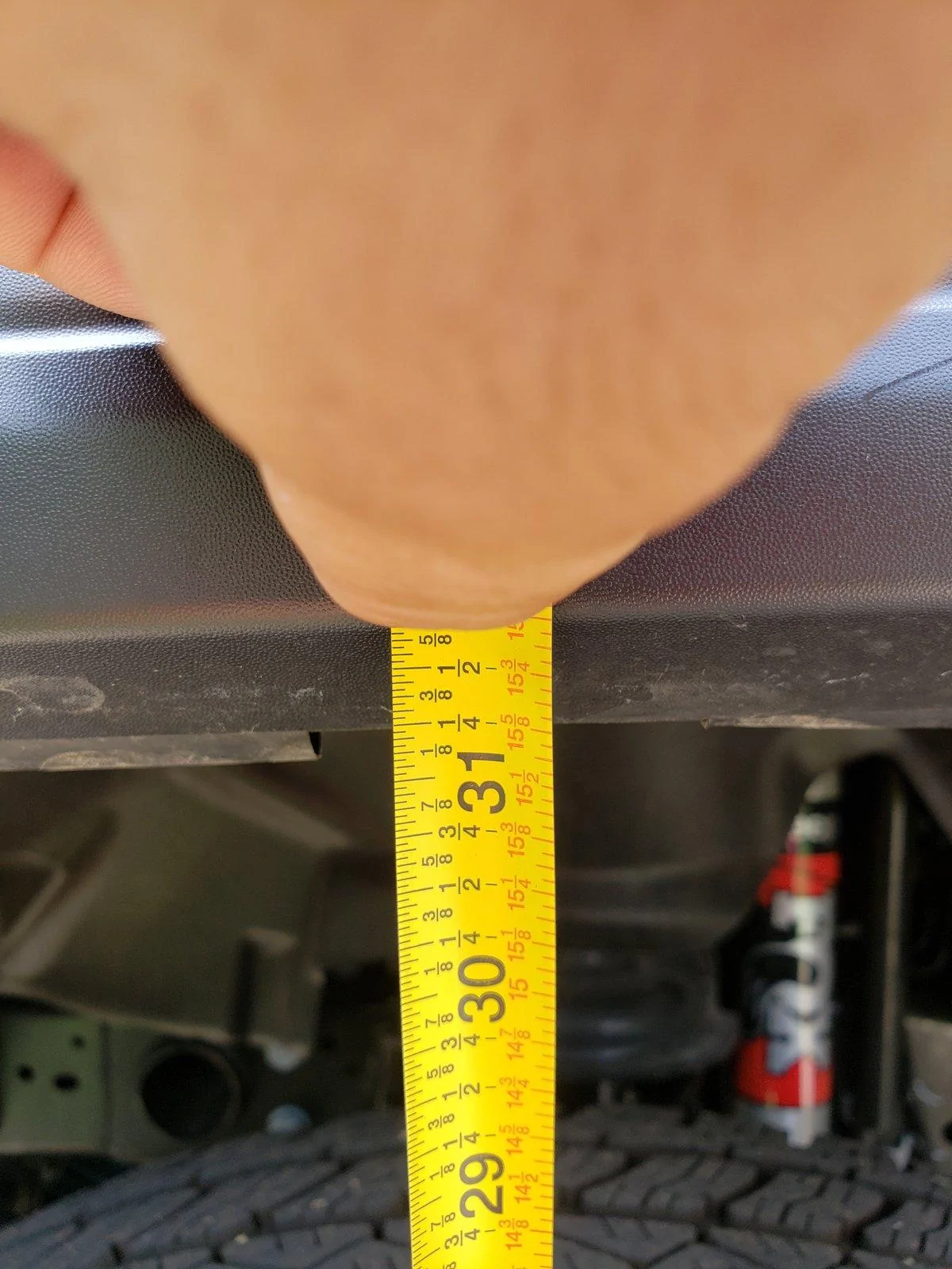

Never did measure the difference when I swapped but definitely noticed it on stance and getting in and out.
I noticed it as well.. I have fairly short legs so the difference in how far I had to stretch was immediately noticeable. As was the angle the seat sat at. As soon as I put on tires I had to order steps too as it was beyond what I wanted to stretch every time. And 2 of the 3 girls in my house were also having problems getting in & out.

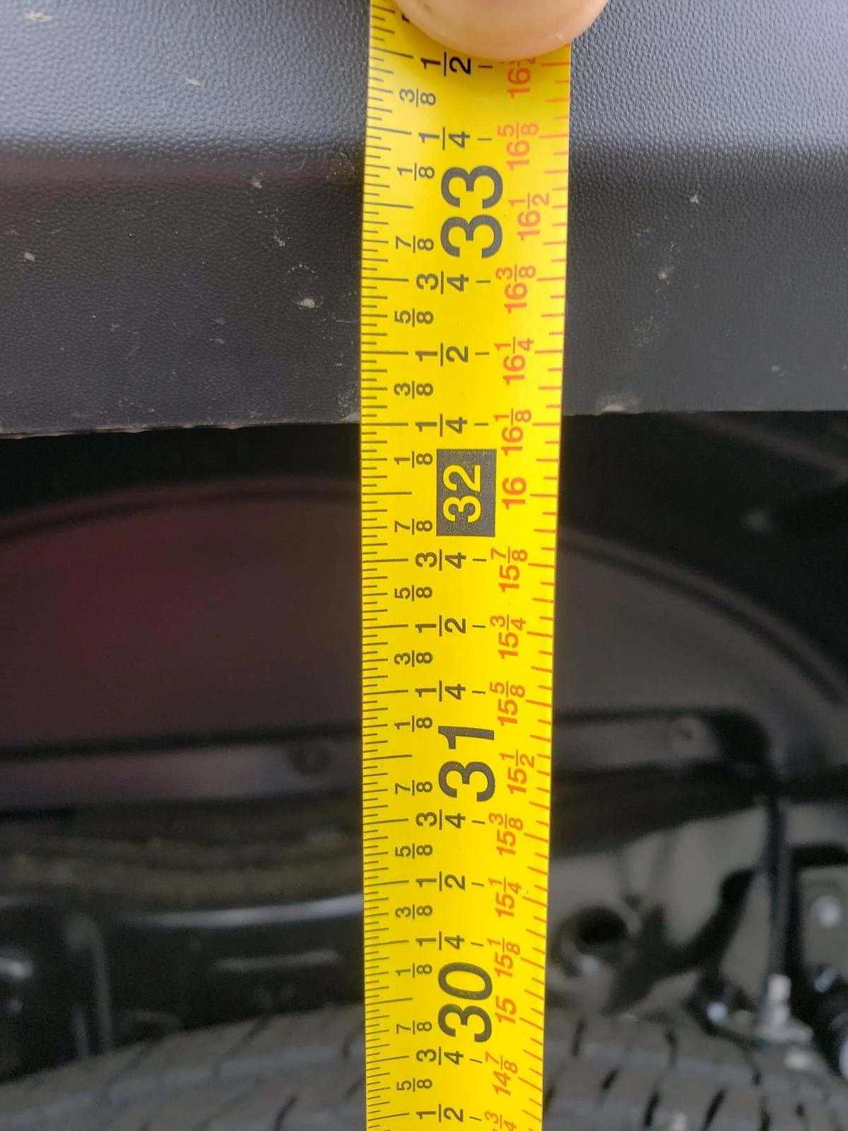

@Moparbrett how much would you guess it raises the front? Do you have a pic?
I've been told that Rubi springs in front, and a 3/4" spacer, will level out a max-tow....which is what I was trying to do. I'm a bit nervous about going with an 1 1/2" spacer since I've seen some on here have issues with the front coils "bowing" when they use that size spacer

I have a Max tow with Rubi Springs (front only) & 3/4" daystar front spacers... There was only about 1/2" of rake back to front. So yeah its basically leveled. 1.5" in the front & I think you would have some reverse rake & that would be no bueno.

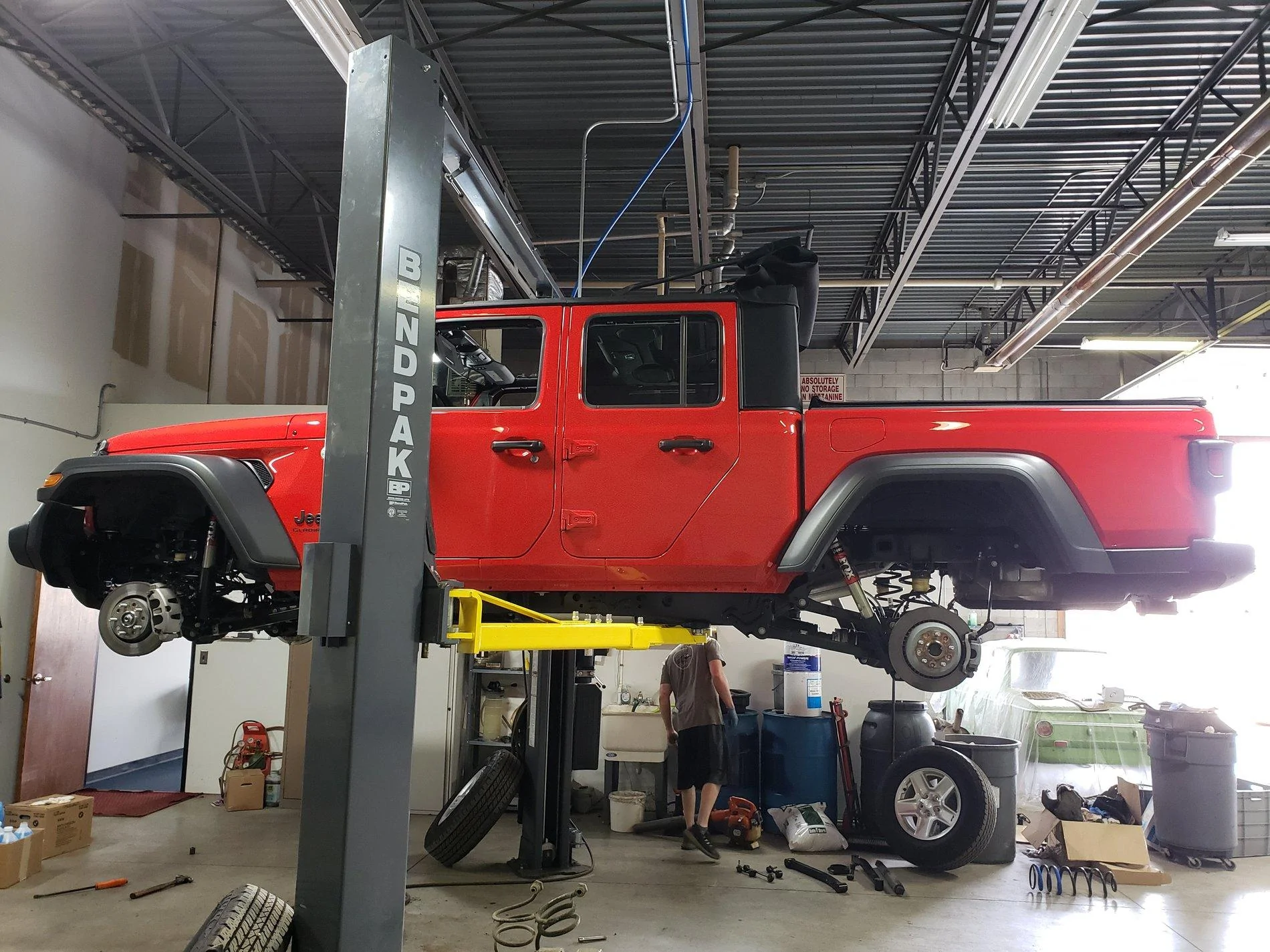

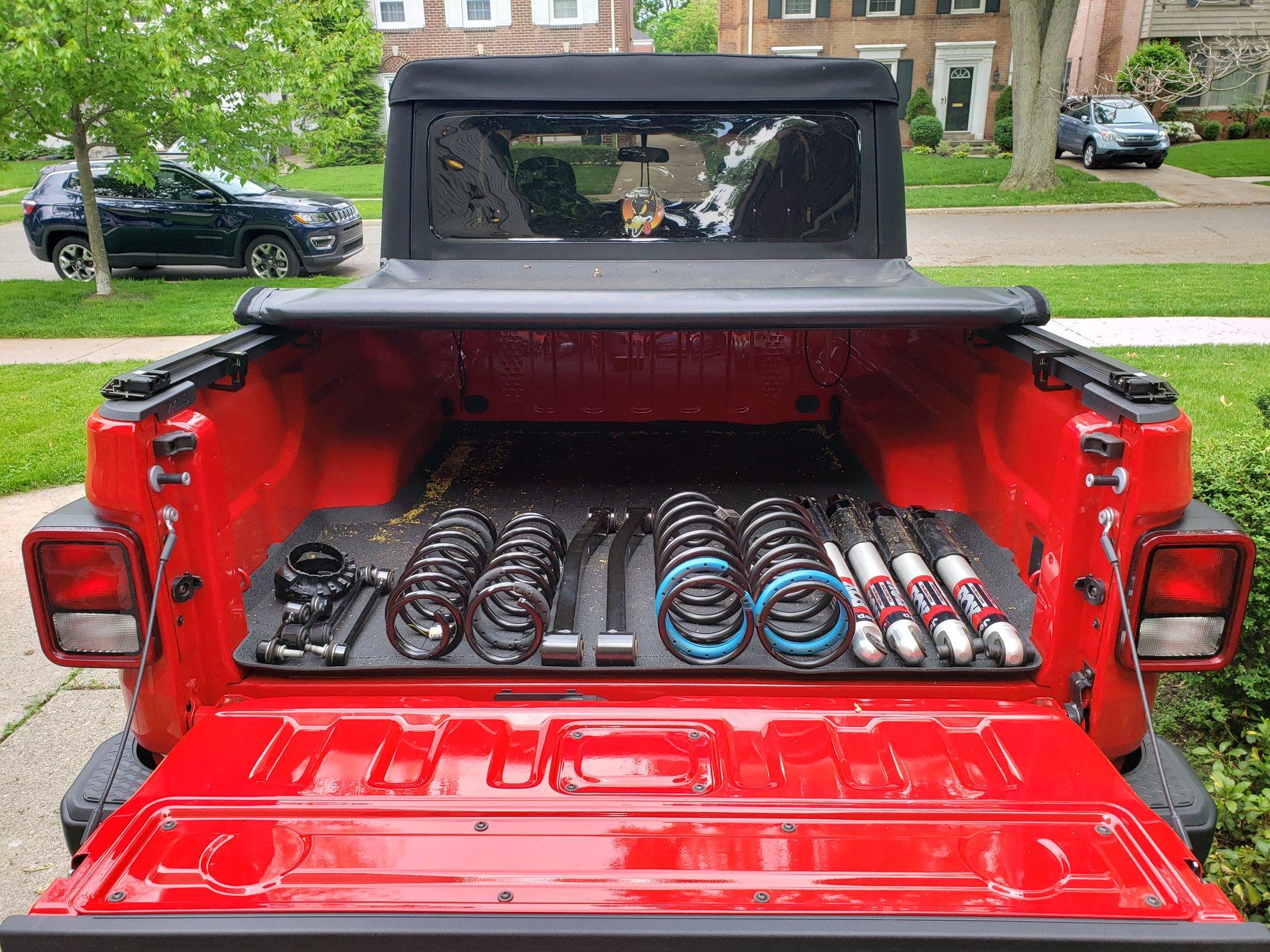

It's a pretty nice set up. It still rides great, but it controls the ride a lot better and eliminates the bounciness from the rear when you go over bumps. Overall, it feels a lot more solid and less floaty. I have the full rubicon take off suspension, and eventually, I'll probably put the Rubicon springs on it, but its a huge improvement for now. I don't need any lift on mine, I only have 33.5" A/Ts on mine. I'll probably just do it because I can and have the parts and 3/4-1" higher wouldn't be a bad thing.
Couldn't agree more!
The stock Sport S suspension was soo bouncy it was killing my back. Those fox shocks are a huge upgrade!
