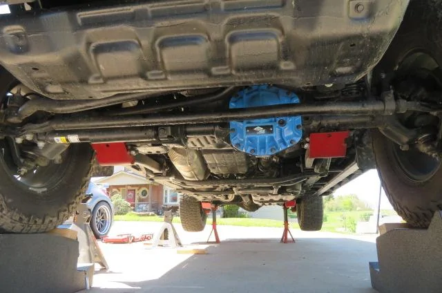

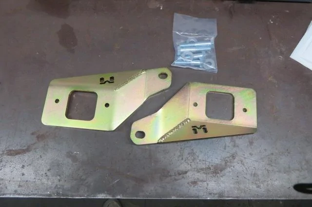

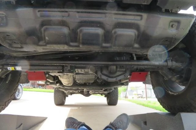

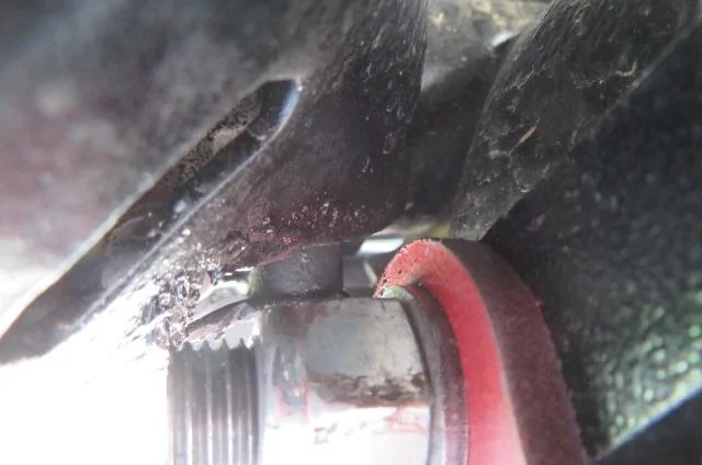

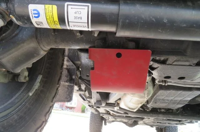

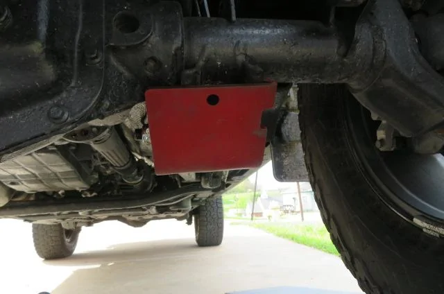

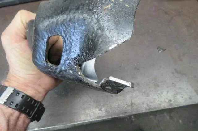

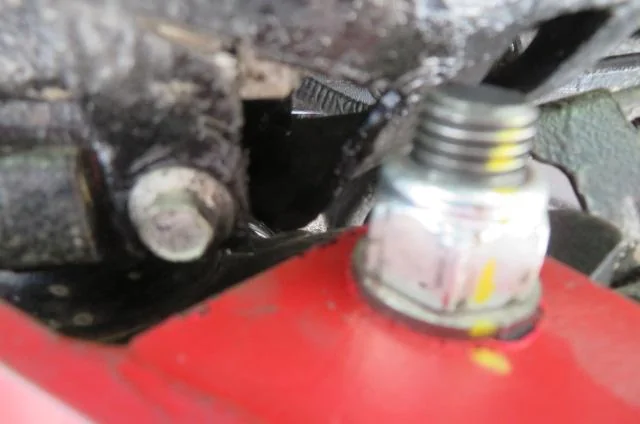

Got the front lower control arm axle side skid plates from Rock Hard install. They are side specific. The hook goes to the outside, toward tire. The driver side went on with no problems. The passenger side had issues. I had to notch the skid plate for the FAD to clear the nut. Plus I painted them with Plastic Dip Red.

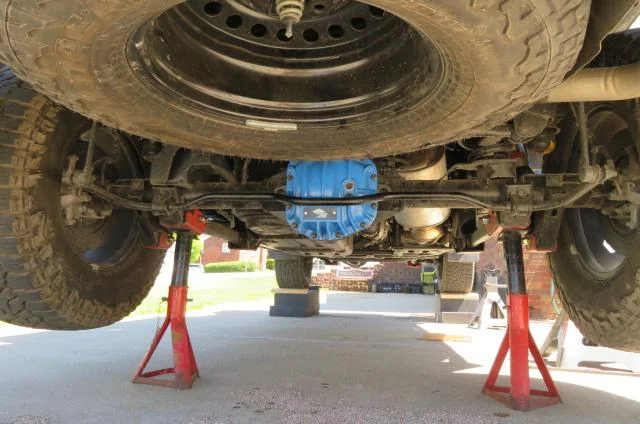

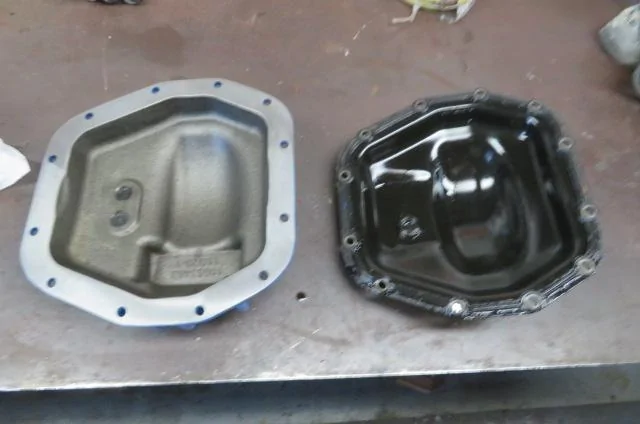

The Dana Diff covers are on. The oem gasket is reusable.

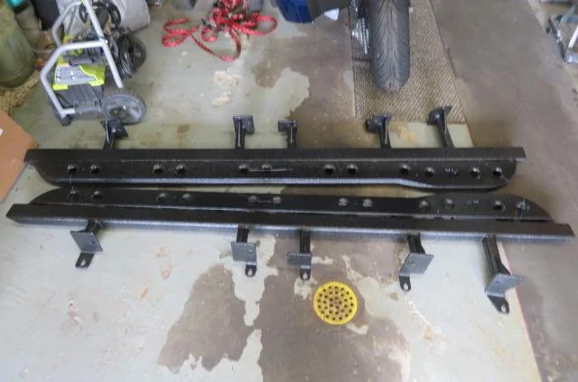

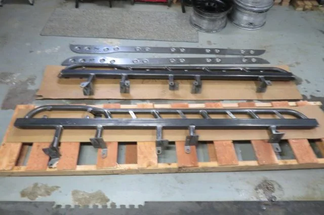

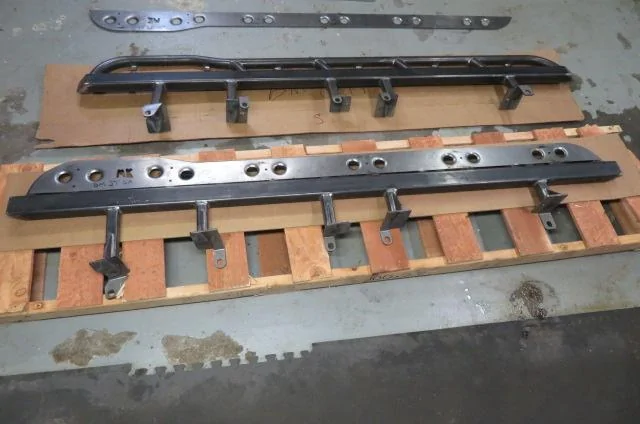

The White Knuckle sliders are on. These things are beefy, and heavy. Took a while to put them on.

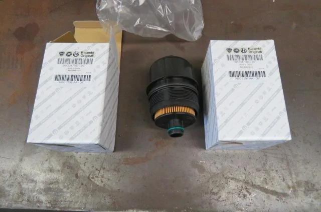

I had ordered 2 oil filters the beginning of March. They came in the middle of April from Factory Mopar Direct.

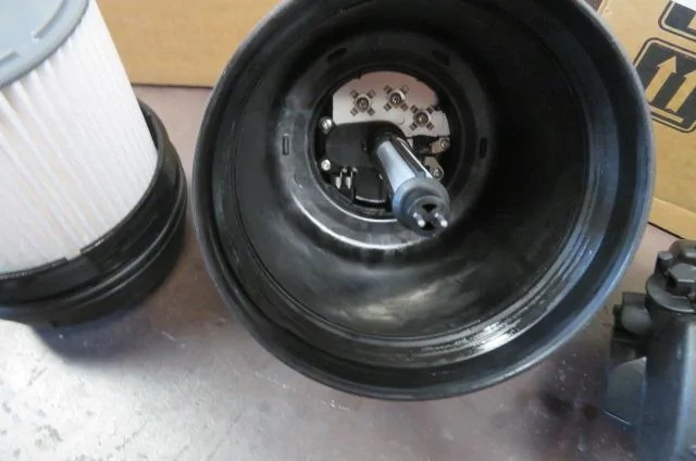

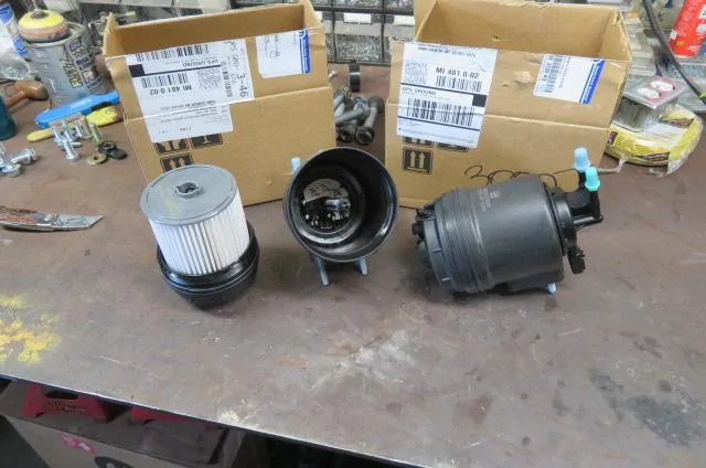

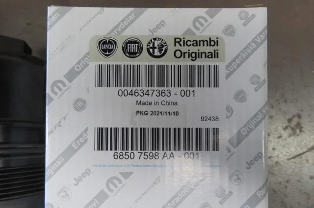

Ordered 2 fuel filters from Factory Mopar Direct on 4/27. They came in on 5/12. The price was $73.16 each. i just wanted the filters. They shipped me the whole assy. Plus they came from a dealership.

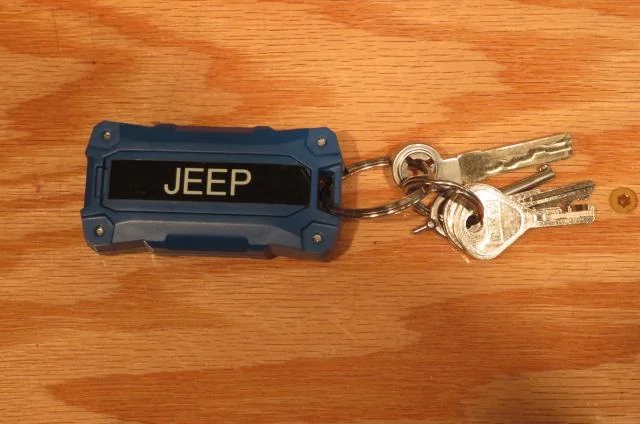

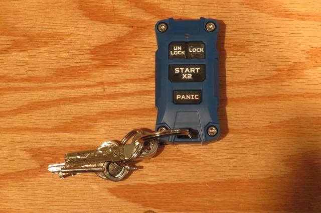

Got my AJT Design Key Fob today. Bit of a pita to do. I made a label with Jeep on it to put on the back side of it.

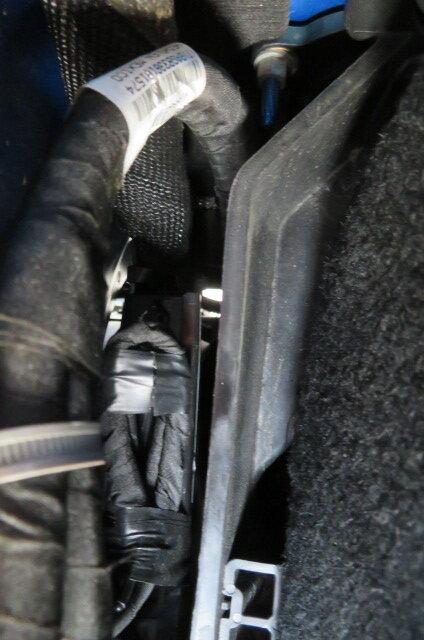

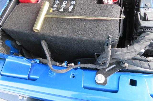

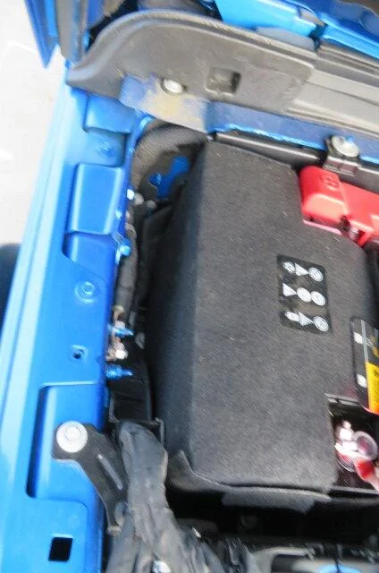

Had a fun time looking for the aux wires under the hood. Read a bunch of posts on where they should be. LOL
1st pic is where most say where the wires should be.
2nd pic is next to the firewall and battery.

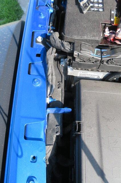

3rd pic is a wire bundle with electrical tape on it. Hmmm
4th pic. I cut the tape and used a spring hook tool to pull the wires up. And Bingo, found them.

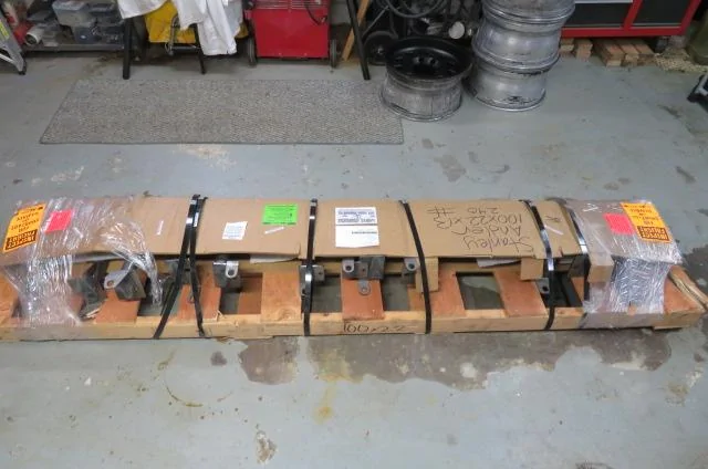

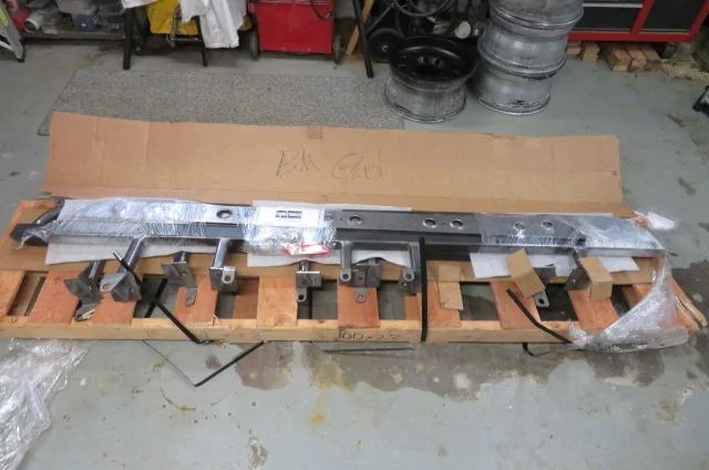

The White Knuckle sliders came today. They are BEEFY. About 80lbs a side. Now to get them Line-Xed.

Do you have to drill the frame to install?
There is 3 or 4 places you have to drill if you want to. They give you the option to do it, and supply the self-taping bolts too.
