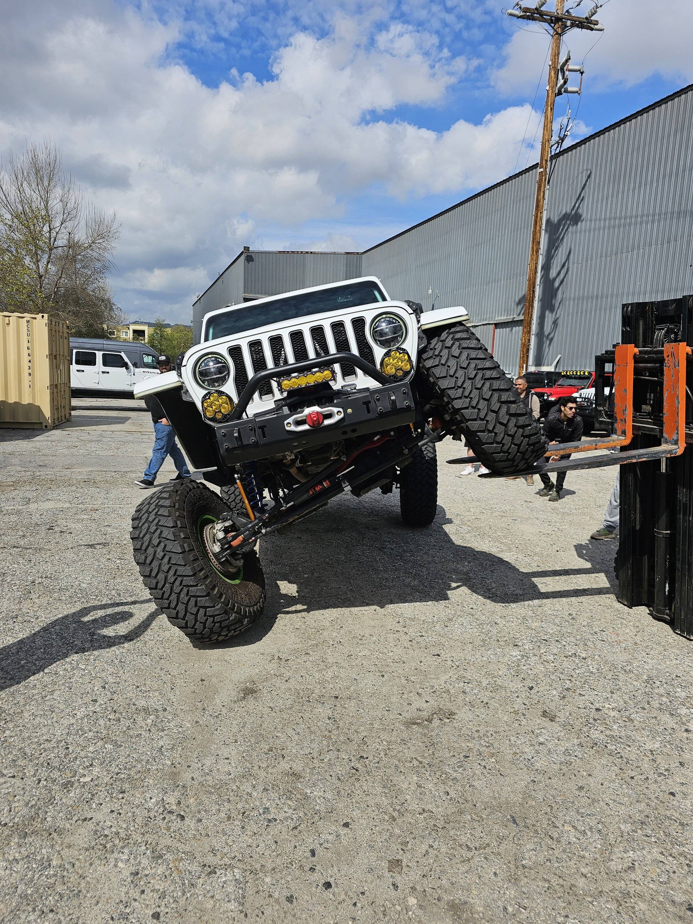

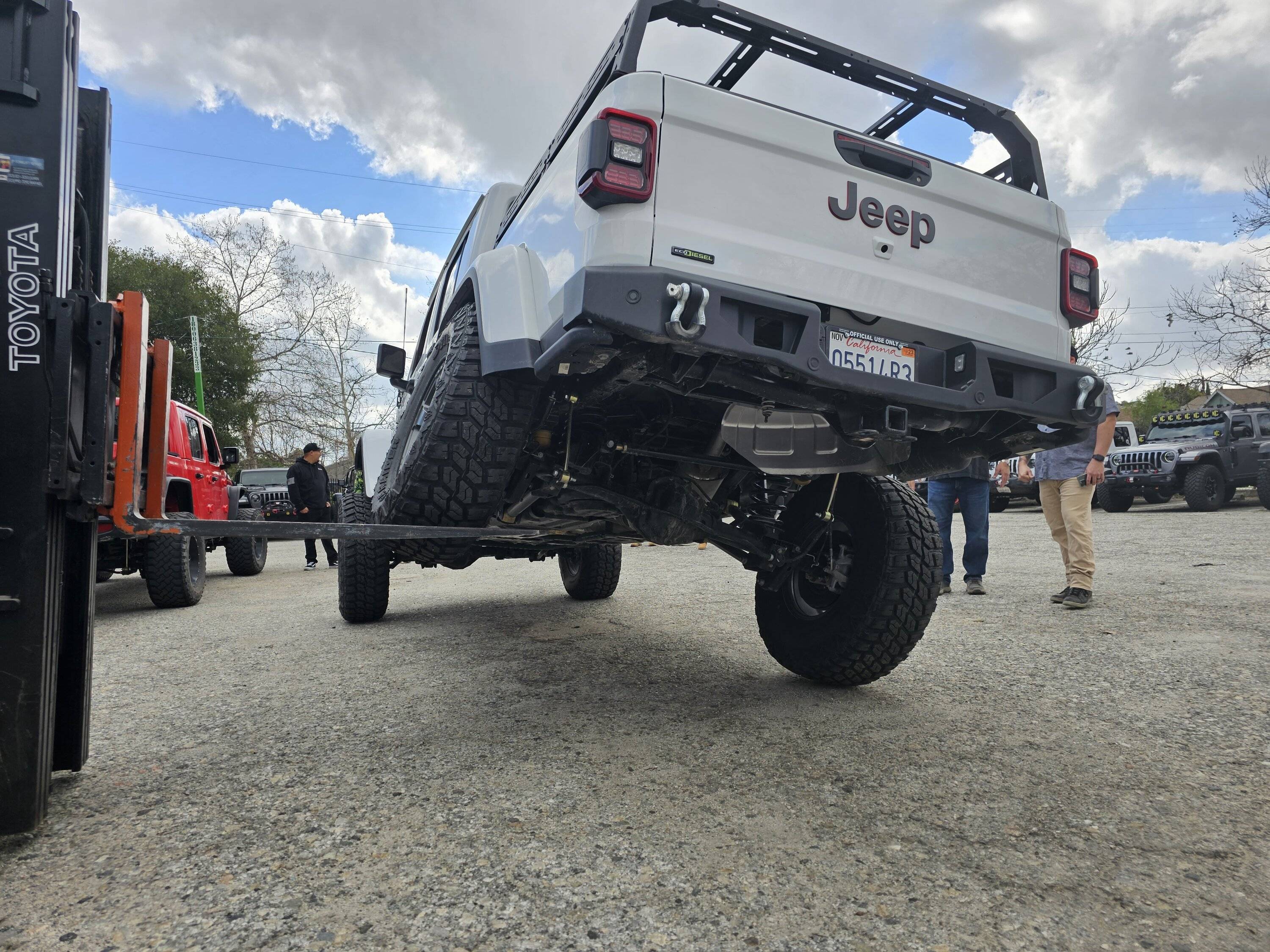

I suppose you would have had to been in other conversations regarding this subject, was told by others (mostly Clayton users) that Rustys wasn't good and the quality wasn't there. They were completely wrong.... for clearance, there is more than just riding over the curb in the mall parking lot, the trail clearance is important in the lift .... on bushings this clears just a hair under 35" to the very bottom of the 37" tire.... maybe more with 35's. But I run 37's
Jeep Gladiator Rusty's 4" lift WOW... easily clears the 37's 20230304_105259
Jeep Gladiator Rusty's 4" lift WOW... easily clears the 37's 20230304_101803
