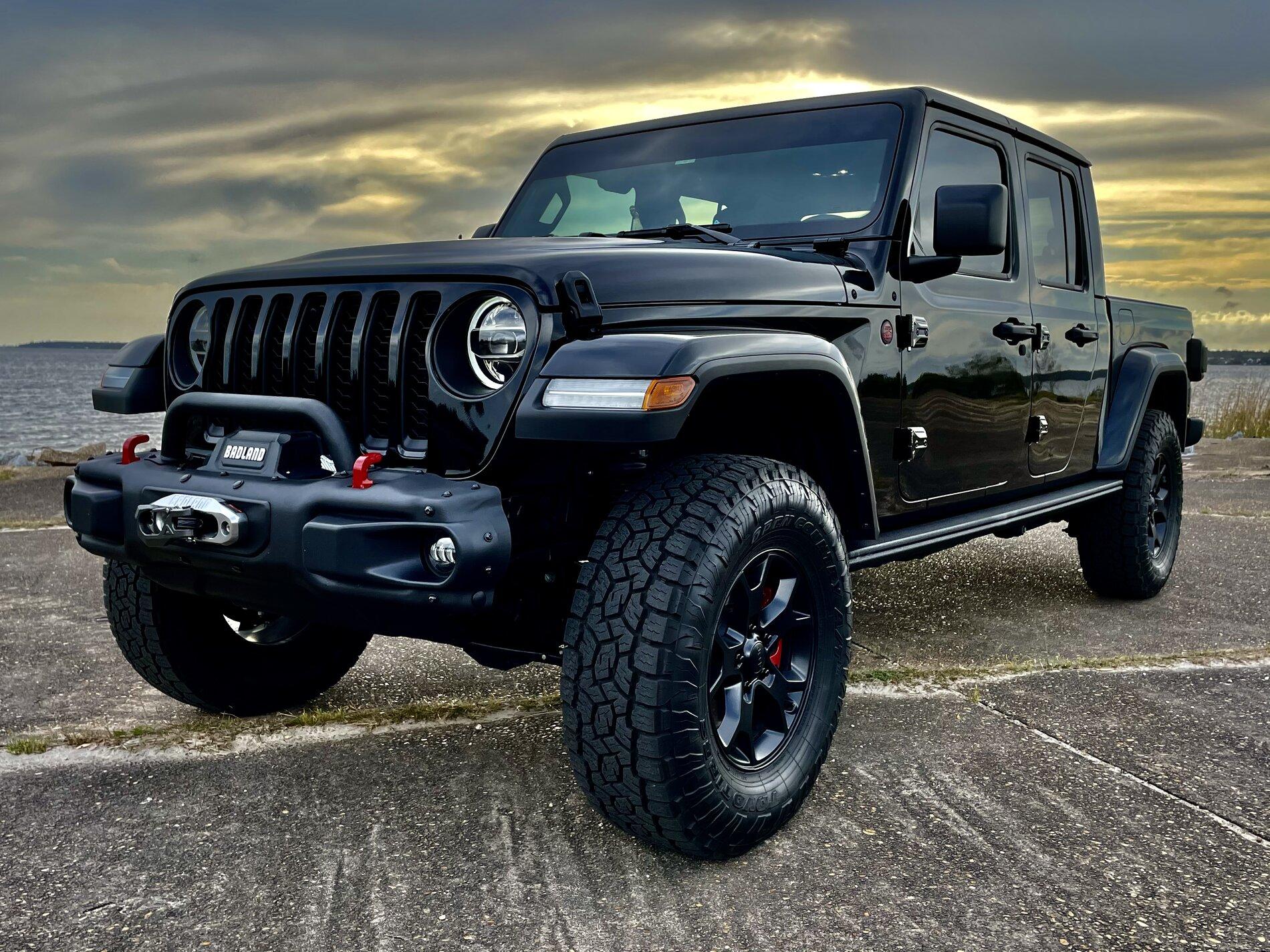

I spoke to the representative at Rusty’s and they mentioned that they have different springs for the diesel but you need to let them know that you want them.
I ended up installing a Teraflex 2 1/2” front coils and a 1/2” rear spacer. I too have the Mopar steel bumper and winch. After a couple of days they dropped 1/2” so today I plan to install the 1” Teraflex spacer that I previously used and swap the rear spacers to a 3/4” Daystar.
I did order spring correction front pads, front and rear shock extensions and a adjustable front trackbar from Rusty’s. I’m waiting on the longer Mopar front lower control arms to arrive but the Jeep drives pretty good as is.
This combination will give me a level stance and looks good with the 34” tires. I’ll get 37’s when they need replaced.

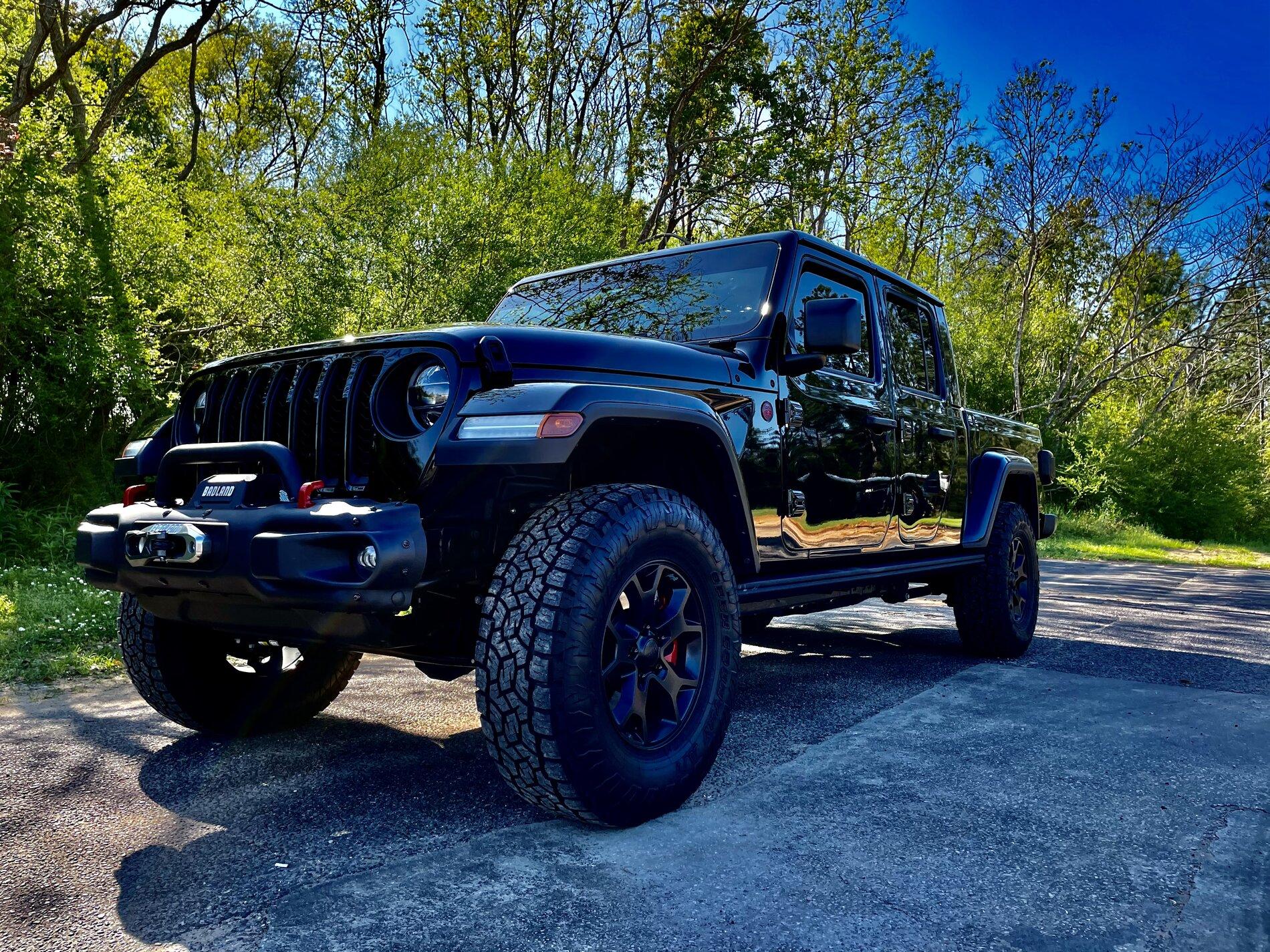

Update to my Teraflex lift. I added the 1” spacer to compensate for the winch and diesel weight. I’m pretty satisfied with the look. I do intend to move up to 37’s when the tires need replaced.
